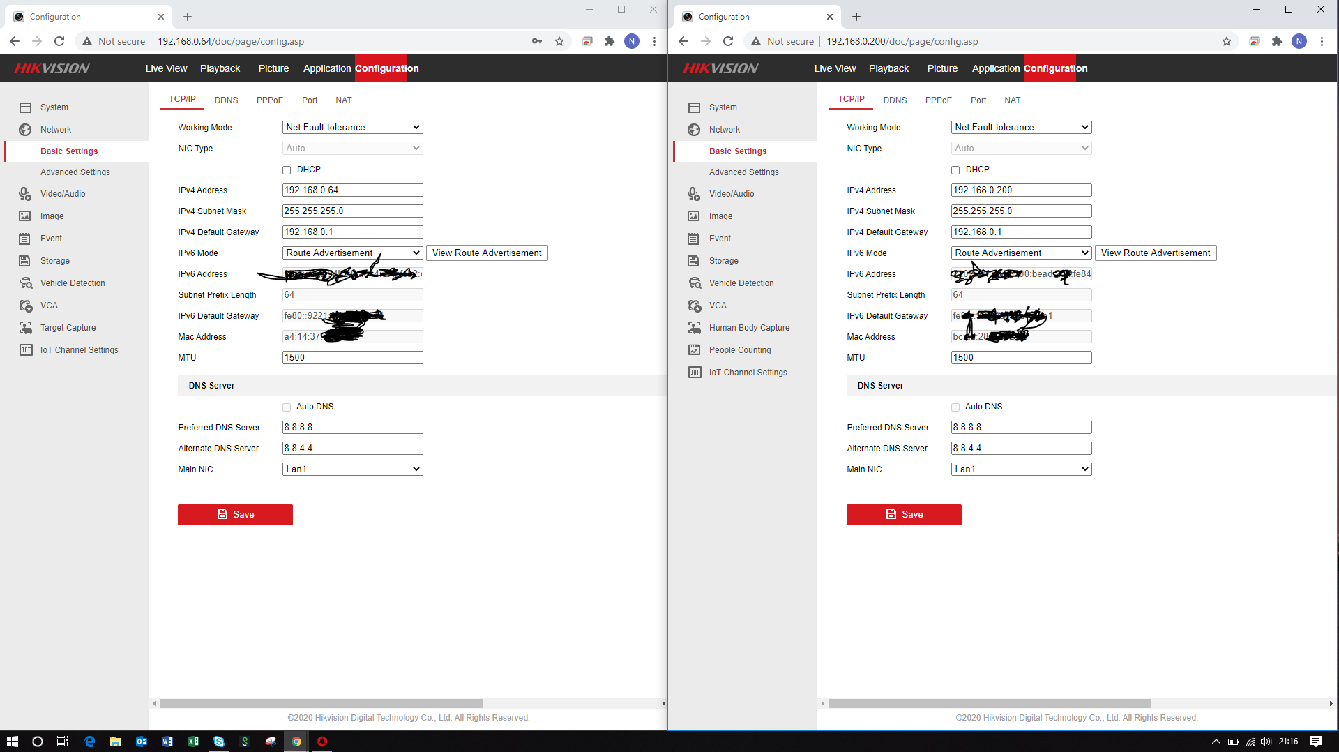

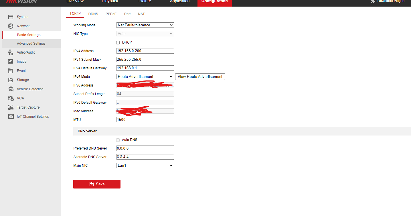

Ive put some general screen shots on of settings and I’ve tried various different servers on the Hik-Connect section but non make it go online and I try scanning with Hik-Connect QR on my phone or via the online version on my PC each time and it always says offline. Note the 7708 in the photos is 192.168.0.64 and the problematic 7716 is 192.168.0.200, I’ve also tried pinging various address as noted in help literature on this forum including the latest one litedev.eu.hik-connect.com and it fails the ping as per the notes on one of the help leaflets but the old one doesn’t ie litedev.hik-connect.com it pings perfect but does not allow the unit to go online though, I’ve tried everything I found on this site this issue points to the DNS settings would be wrong but they are the same as the other unit which works. I also tried setting the unit for a period of time on DHCP mode so it was auto populated by the router but that didn’t make any different.

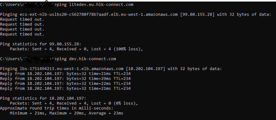

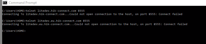

when I do telnet dev.hik-connect.com 8555 it does as the help manual states and goes blank for a moment and then back to a normal screen, it doesn’t say it passes or fails or anything of the sort.
However when I run telnet litedev.hik-connect.com 8555 it fails
And when I run telnet litedev.eu.hik-connect.com 8555 it also fails.
Remembering ive another NVR in the house working fine on litedev.eu.hik-connect.com and an intercom system also.
I’ve also tried having the preferred dns 8.8.8.8 and secondary as 8.8.4.4 and then the other option as preferred 192.168.0.1 and secondary as 8.8.8.8 as there is conflicting documents on the internet stating what should be set to what.

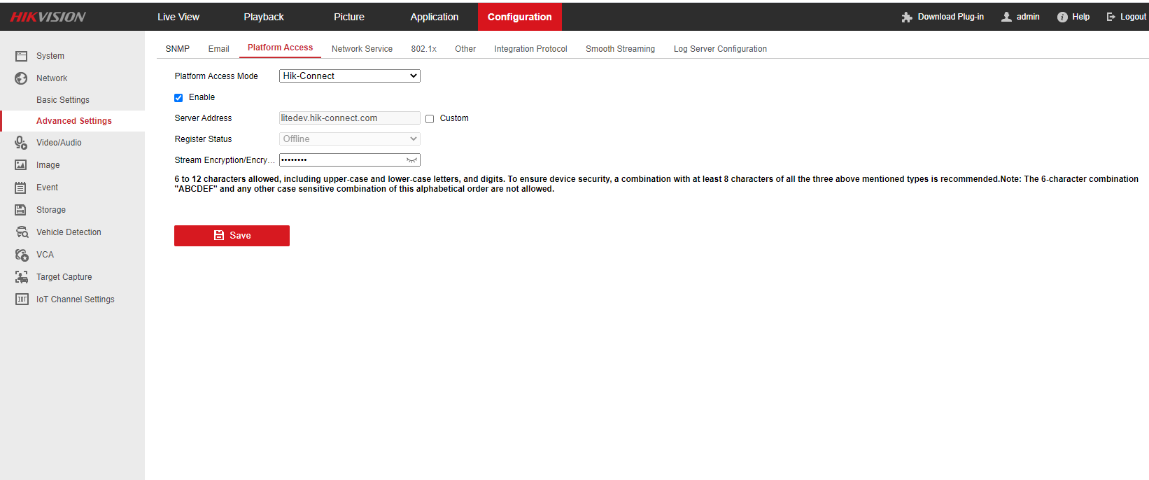

I then got some advice to complete the following I did this via 4200 as well as web based which unfortunately didn't work
1. Login to your NVR via Web Client
2. Navigate to "Network" "Advanced Settings" & "Platform Access" click the eye icon to View your Verification Code
3. Highlight & Copy the Verification Code
4. Navigate to the "Local" tab at the top of the Menu List
5. Clear the "Encryption Key" box, the paste the copied Verification Code into the Encryption Key box
6. Click Save

Now one issue I've noticed is, when I untick the custom box next to the server address which I know is an issue historically it removes the .eu from the address where as my other unit does not do that as the screen shots below
