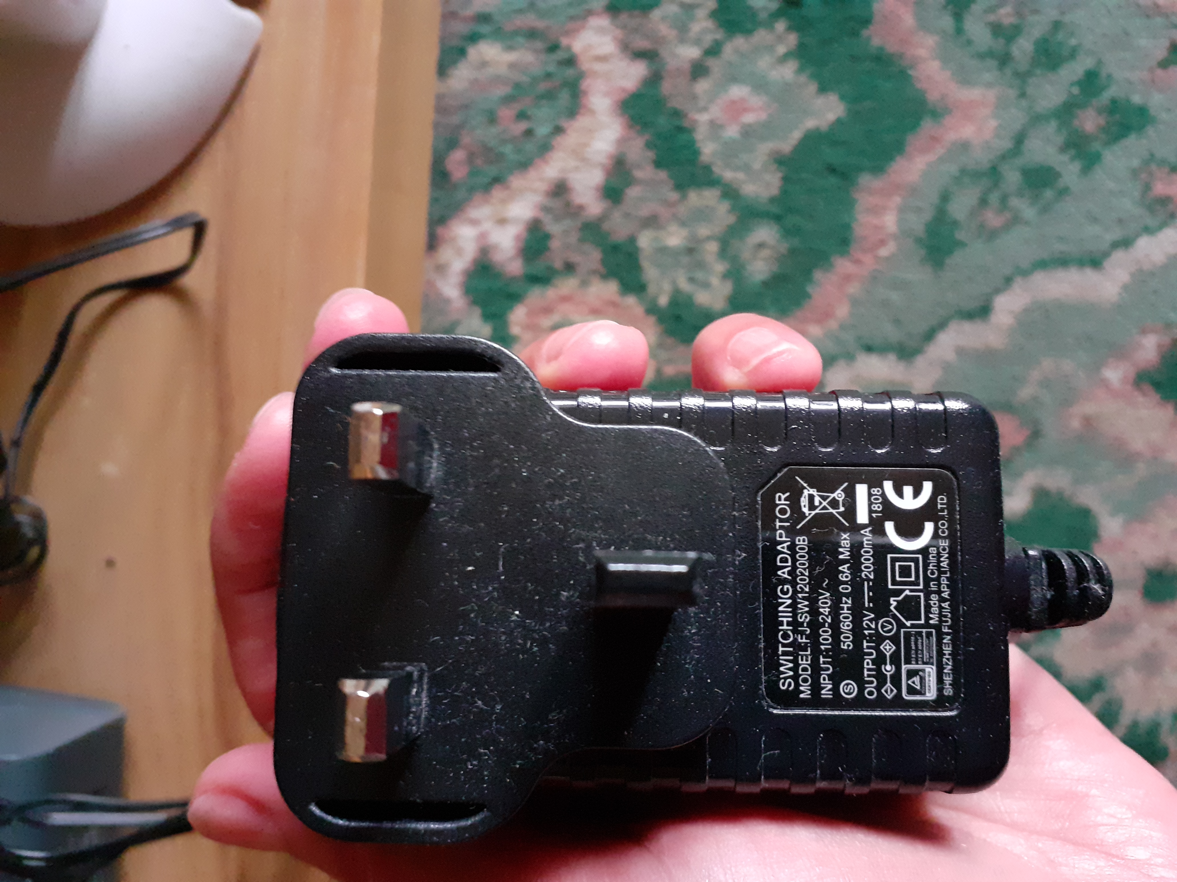

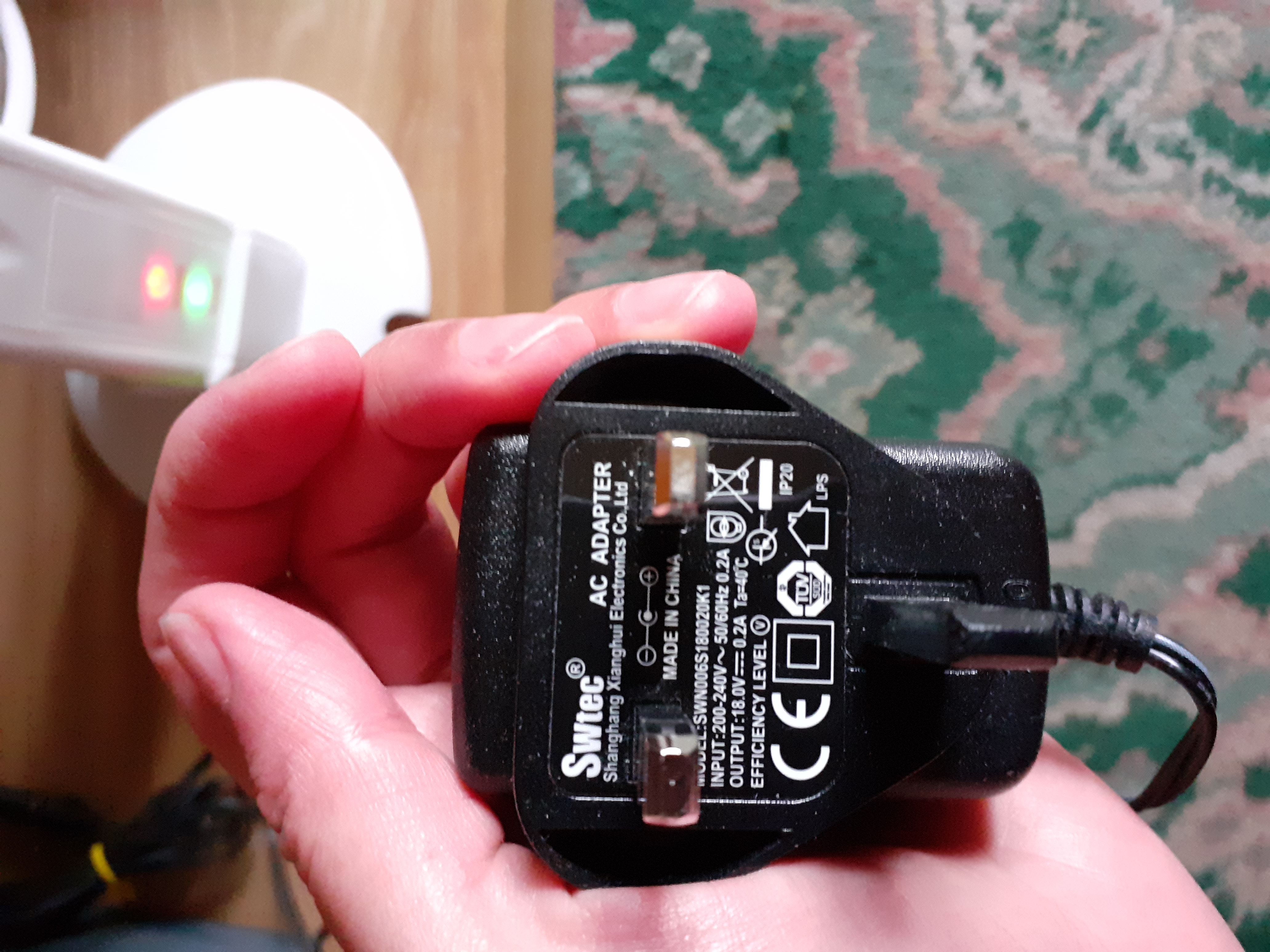

Upload photos of their labels if it's simpler for you

Hello,
Please see attached images.
Sorry as you are aware I have no idea about the voltage strength.
Cameras power adapter is INPUT 200-240V OUTPUT 1.8OV-0.2A
The DVR power adapter is INPUT 100-240V 50/60Hz 0.6A Max OUTPUT 1.2V-2000mA
So is it the camera adapter voltage that is too weak?

The power rating of the PSU that you are currently using is probably too low (200mA) to power four cameras.
But also be aware that it is an 18V DC PSU.
You need to check what the required power for the cameras is (and ensure that you provide enough power for four cameras).
NB - The cameras will draw more power at night when their IR LEDs illuminate.
