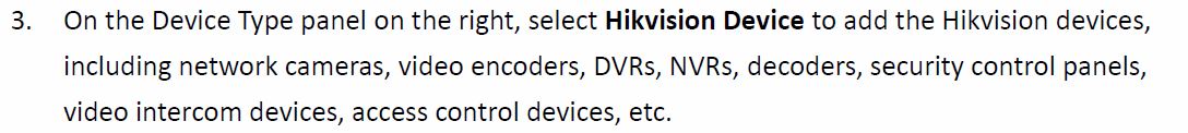

I have today downloaded version 2.7.1.9 Build 20180604 and the first problem that I have run into is item 3 in Adding a Device.....
First off I cannot find a 'Device Type' panel on the right and there is definitely no option to select Hikvision Device.
Looking at an on-line help page, the instruction is to click on the 'Server' tab, I don't have one, what I have is either a 'Device' tab or a 'Group' tab. can anyone throw any light on this please.

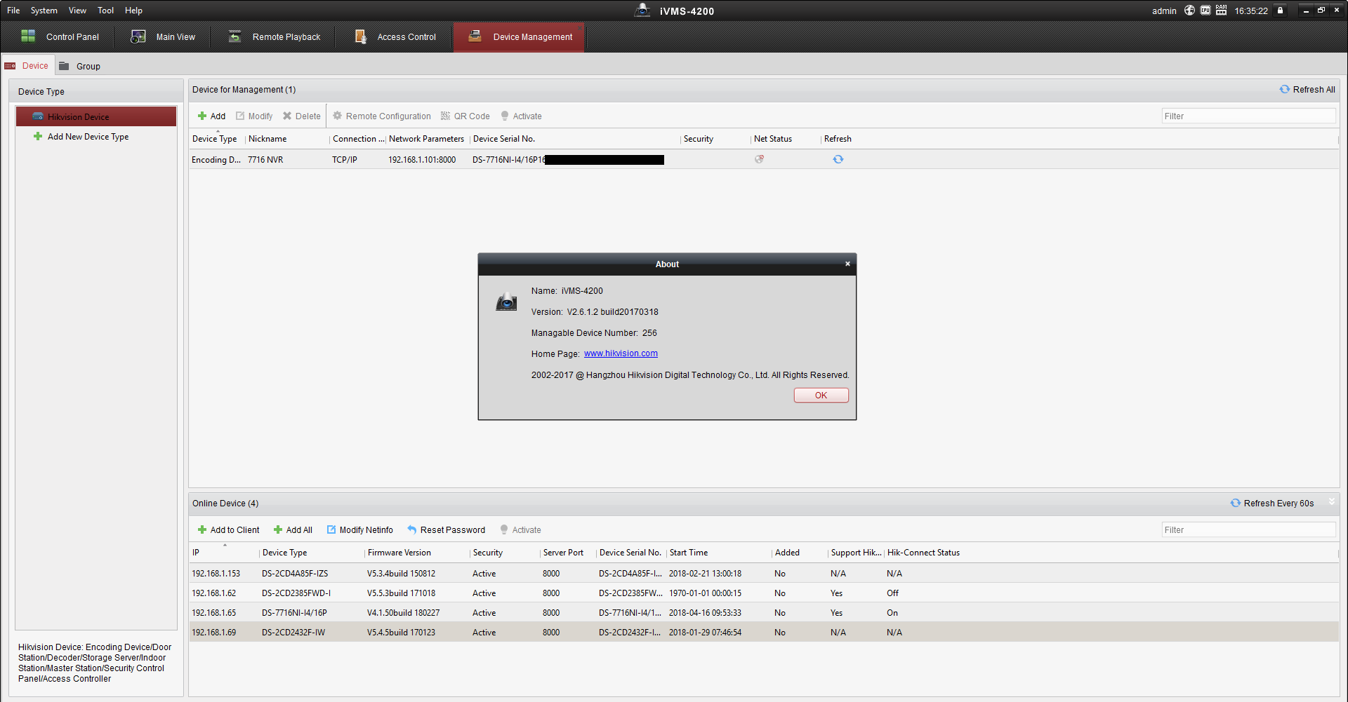

Here is a screenshot from the version of iVMS-4200 I currently have installed on my PV (V2.6.1.2)

Thread starter #6
Thank you for the screenshot Phil. Interestingly the first thing that I notice is that your serial number is showing. I do remember reading somewhere, although I can't recall where, that if your serial number is populated then all is well. No matter what I have done, I cannot get the serial number to appear when I have added the device.
I have followed written instructions on setting up iVMS-4200 and I have watched videos too but the serial number will not appear in the appropriate column.

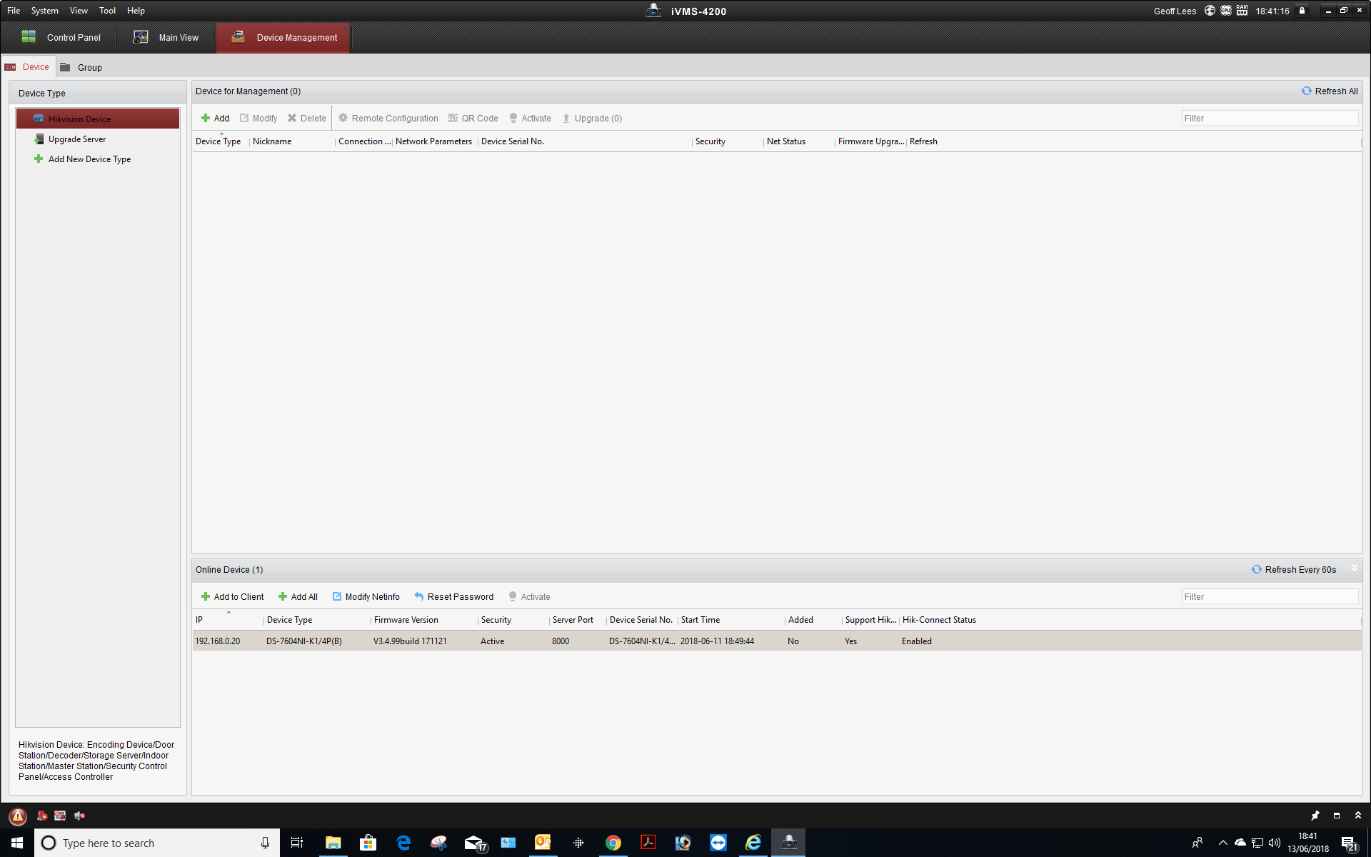

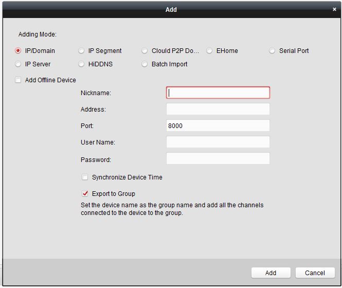

As a matter of interest, which of the eight options should I choose when trying to add my device.
A screenshot of the 'Add' screen is attached along with a shot of my 'Device Management' screen from mi iVMS-4200. The details of my NVR are shown across the bottom of the first screenshot, should the programme have picked up the details of my camera automatically too?
Just now (11.30am 14/06/18) I have been looking through the manual that came with the camera and it states in there that the default IP Address is 192.168.1.64 whereas when I look in the 'Camera Management' area (on-line) I see that my camera's IP Address is showing as 192.168.254.2. Could this have anything to do with the fact that SADP and iVMS-4200 is not picking it up?

Thread starter #8
Just wondering if there are anymore thoughts on why I can't get the iVMS-4200 working, it still doesn't populate the serial number and it still doesn't find my camera. I really would like to be able to use this software but it is defying all attempts to get it working.
Were the screenshots in my previous post of any help to anyone?
Many thanks.
EDIT at 14.22 on 20/06/2018. Don't ask me how but I now have live images showing in 'Main View' in iVMS-4200 Whoopee!!!
However, there is a 'but'......Each time that I have tried to add the device to the 'Client' it hasn't worked and I have always had the word 'no' in the 'added' column at the bottom of the screen, I eventually got a 'yes' as I said earlier and have got 'main View' working. I then decided to log out and log back in again and then I spotted that the device was no longer showing as 'added' but, I still had the live images showing in 'Main View'. Is this normal? Do I have to add the device again every time that I open iVMS-4200?
