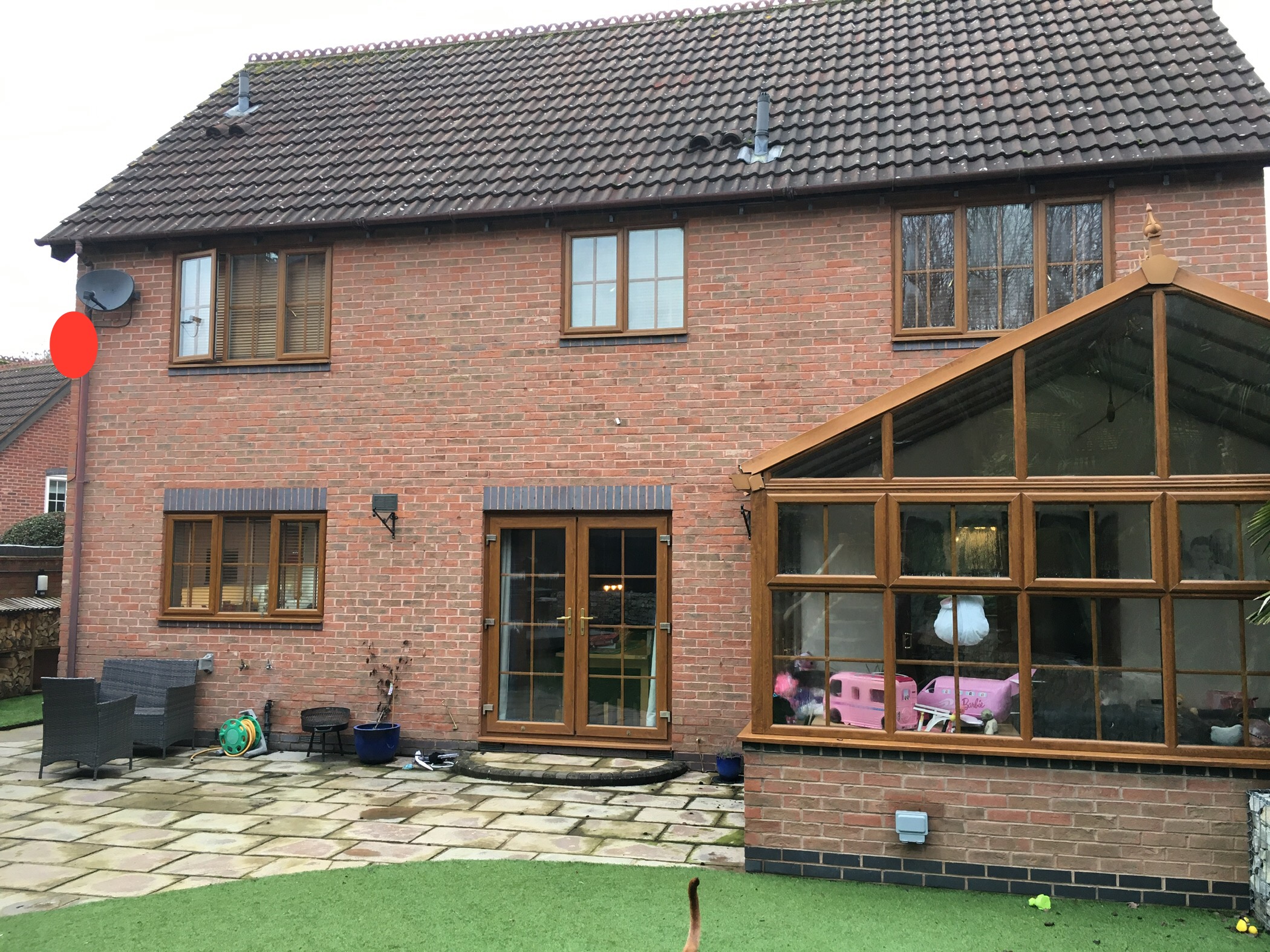

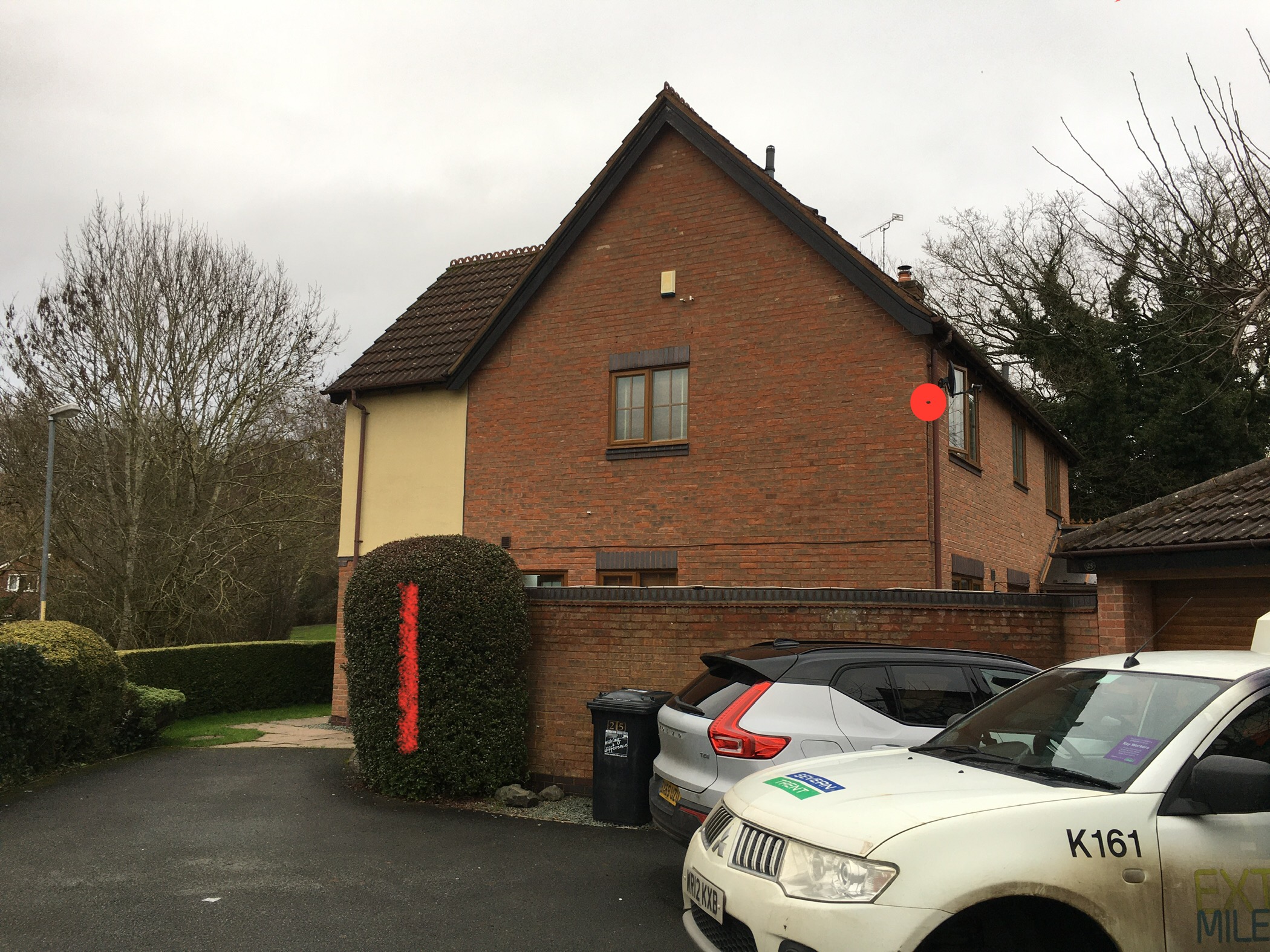

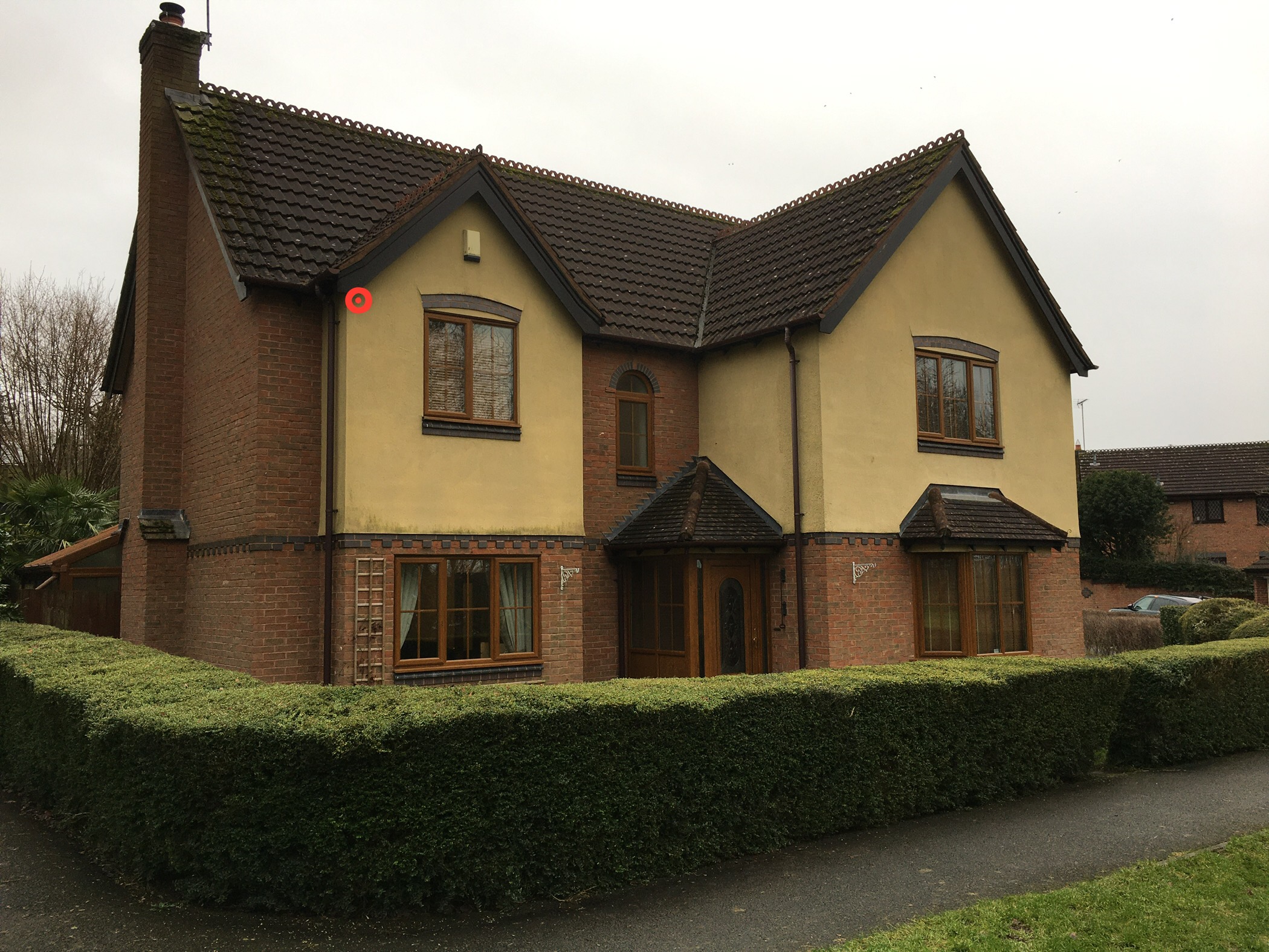

Hi all, I’ve posted a couple of pics. I’m looking at a PTZ dome on the side of the house, hoping that a 4 mp with 4x zoom will cover the drive (main approach to the house) and the side gate ( indicated by the red line behind the hedge). My thinking was If I mount it on a corner bracket just below the sky dish it will also cover the rear garden. On the front of the house I really wanted to mount high to save on ugly wiring so was thinking a fixed
motorised varifocal pointing to the front door. Not sure if the ptz is sufficient or if I need to put another fixed on the opposite end to the ptz.
