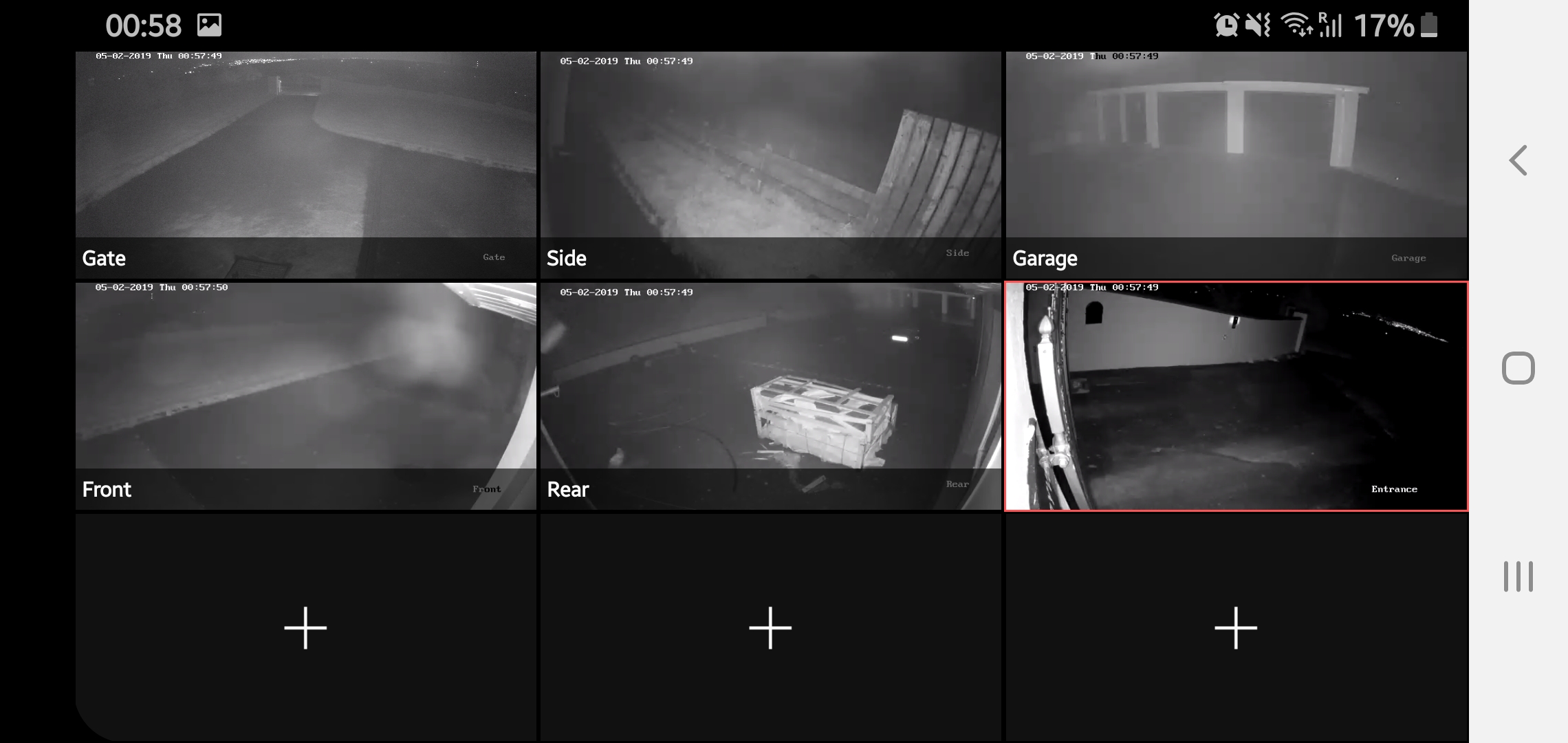

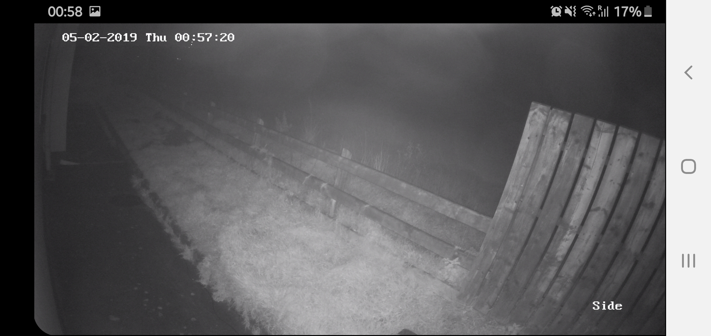

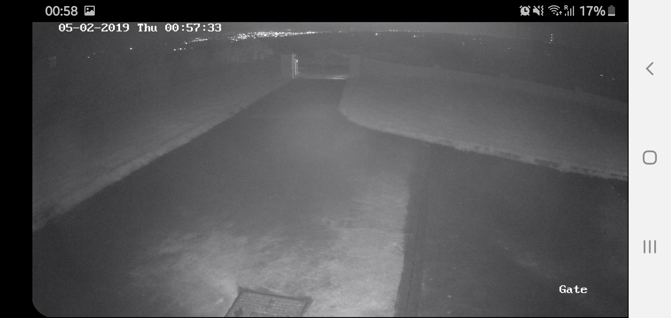

Any suggestions to improve my night vision quality, and explain why one camera is so good while the others are not?
6 cameras at various points around the house:

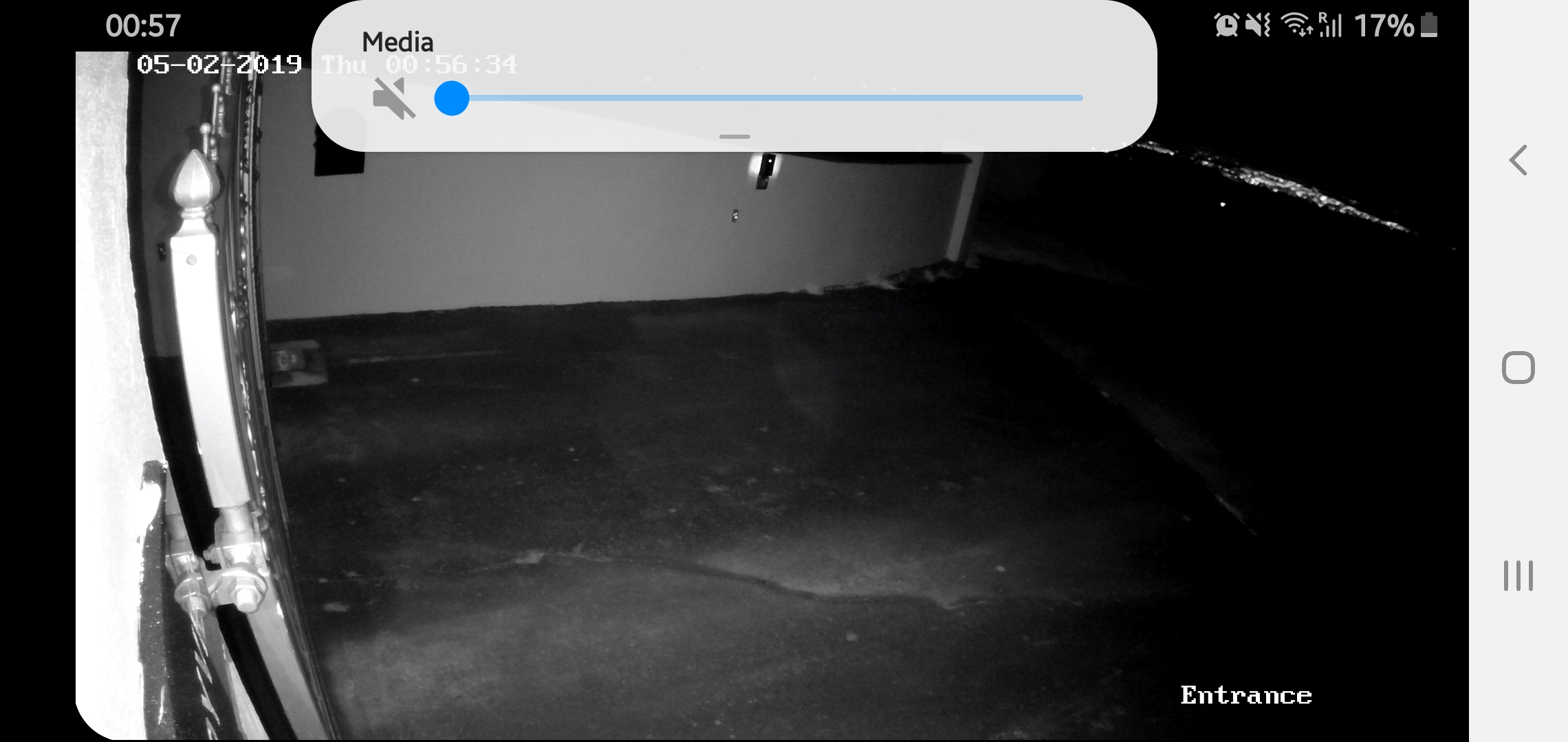

The one at the front gate itself is very good. I thought it would suffer from glare off the gate and the pillar, plus the wall opposite but it's fine. (excuse the volume button)

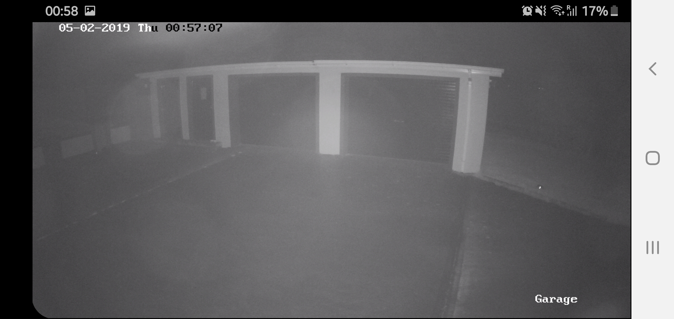

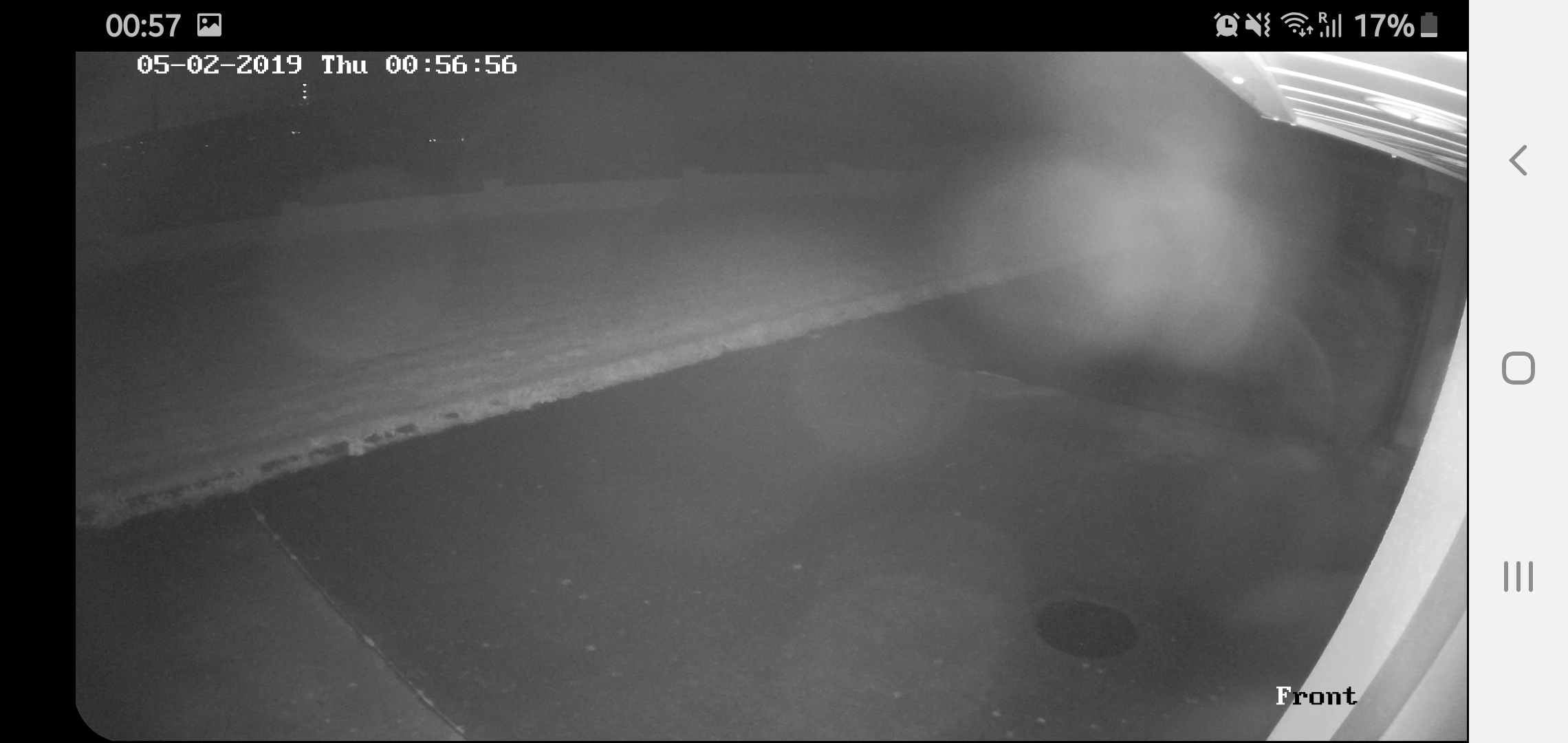

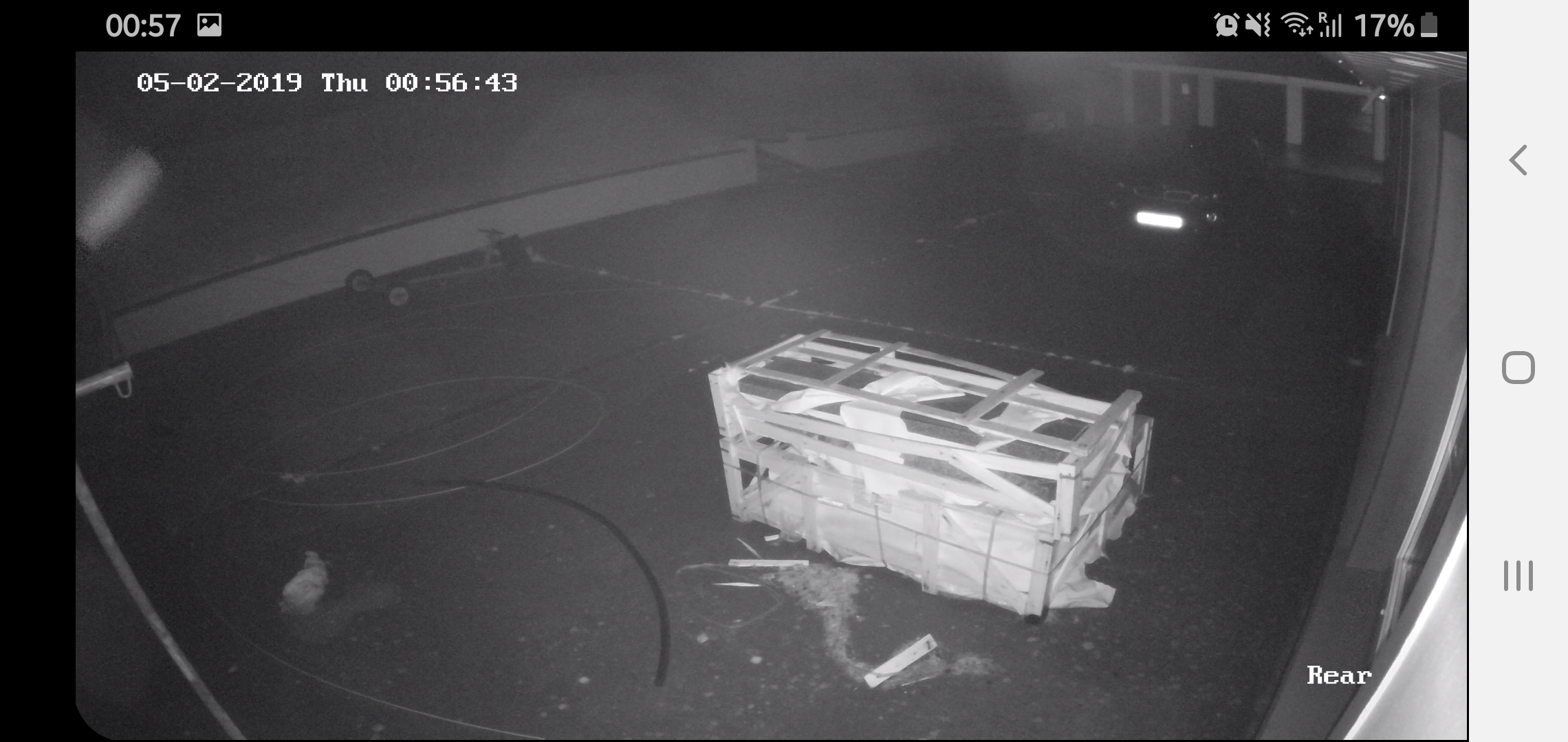

But the others are all quite hazy and grainy. I've tried to minimise the amount of sky and walls etc.

I thought the images were actually quite good until I installed the one on the gate pillar and it was so much better.
One thing to note is that the one on the pillar uses a different type of cable. It is a 100m external cat-5e cable from Amazon:
100m OUTDOOR EXTERNAL cat5e... 100m OUTDOOR EXTERNAL cat5e Network Ethernet Cable (PVC Lined) BLACK: Amazon.co.uk: Computers & Accessories
The others are cat-5e I believe so I don't think it will make any difference.

Are they done cameras?
Maybe they just need a clean with a microfibre cloth.
RBW
Member
64
8
#5
They look like they may have drops of dried water on them. Spray with a glass cleaner and wipe with a microfibre cloth and see if that helps.

The white wall in the good scene will be reflecting IR well.
DrPhilG
22
Thread starter #9
I thought I was supposed to be reducing IR reflection, lol.
I get what you mean though.
Someone elsewhere suggested that I could illuminate the back yard by using an IR floodlight. Have you any experience/thoughts on that?
