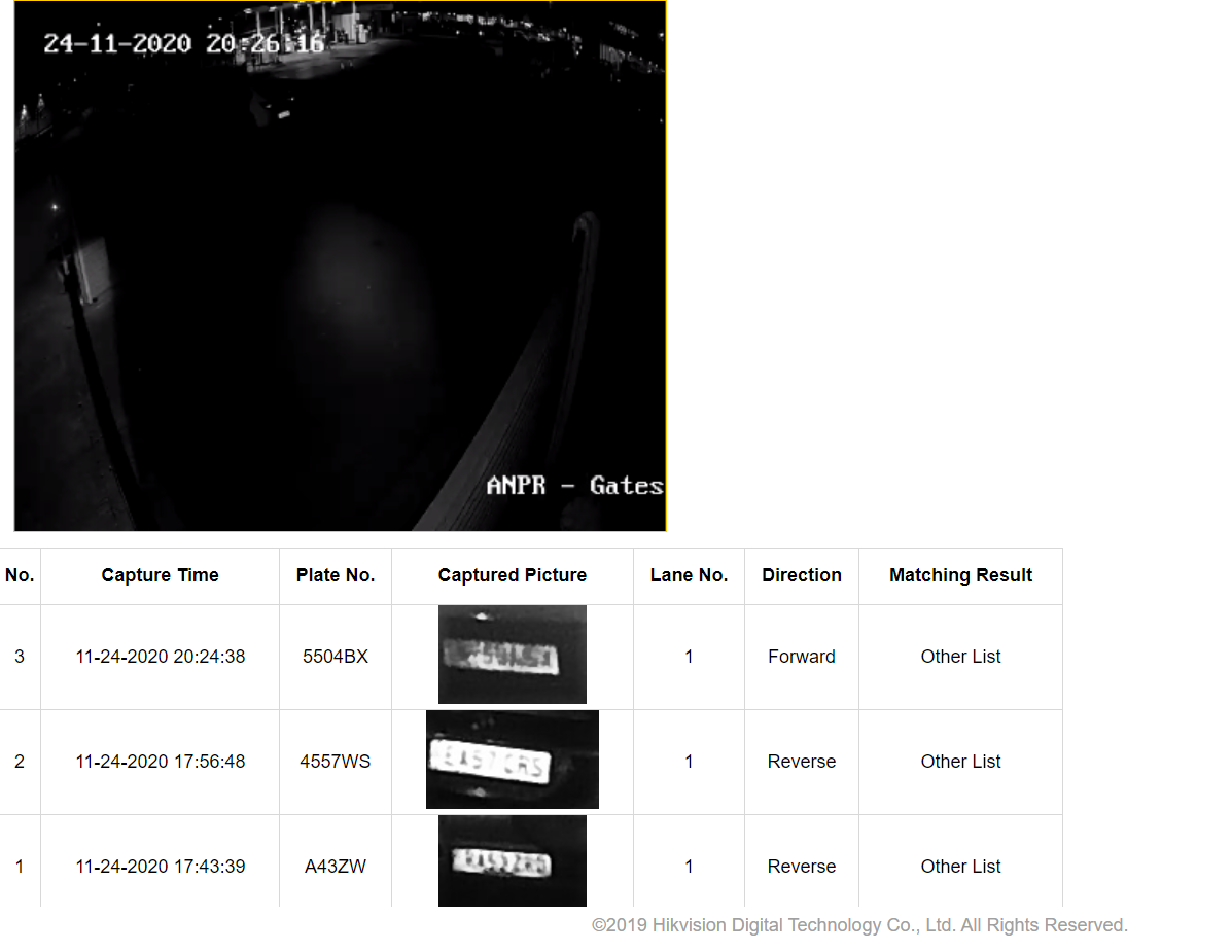

I am having issues with my Hikvison ANPR. Please see images below. Anyone any ideas?

I recently purchased an old / 2nd hand Hikvision ANPR camera and after tweaking the settings got it working great (DS-2CD4A26FWD-IZS).
I played around with the varied focal to ensure the plate was a good size. I then set the focus up in the day time and set it to manual so that it would not change / update. Your pics look like focus is a problem.

its almost like camera is too far away, but its not as its on a post next to the gate its being used to trigger. No more than 3.5 mtrs high on the post
Semi auto is the worse setting to have and causes no end of troubles, put it in manual and park a car or have your better half hold a number plate at the capture distance and then using the PTZ options change the focus until it’s at its clearest.
