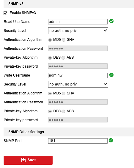

On the camera:
Then try:

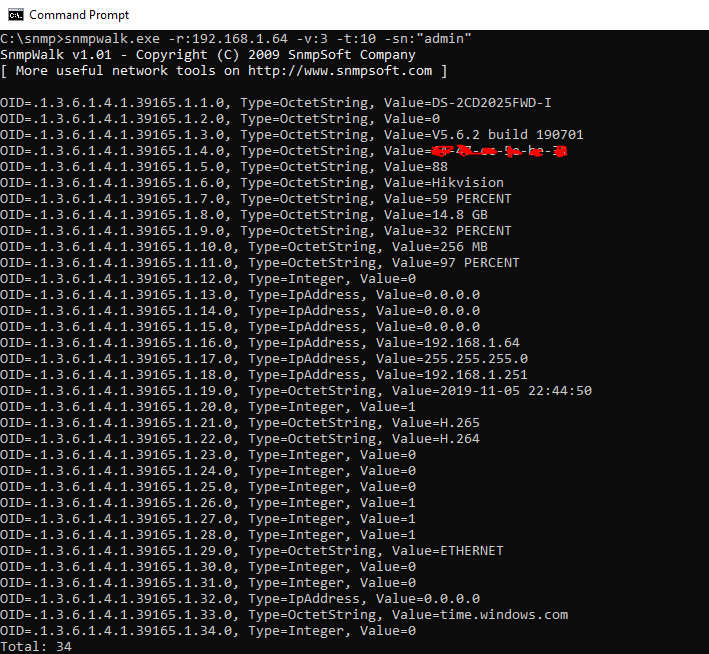

snmpwalk.exe -r:192.168.1.xx -v:3 -sn:"admin"
Thanks for the reply. When I try this, I'm getting:
%Failed to get value of SNMP variable. Timeout.
I'm running 5.6.2 and the 2155 is pretty similar to your 2045. Nothing special on the network setup for where this camera is located at either. Tried using v2c and v3, but getting the same results. I do see that port 161 is open on the camera.
