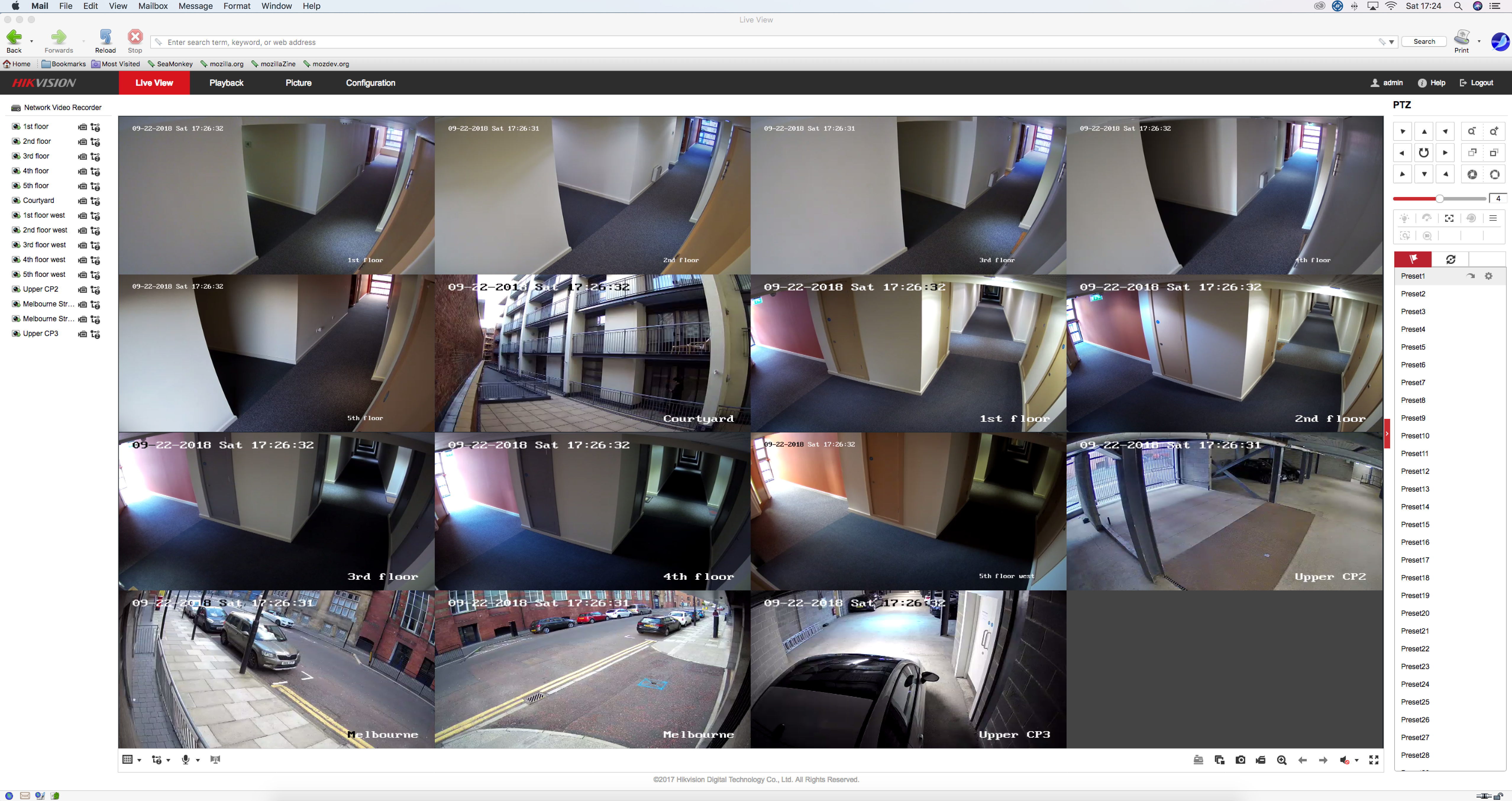

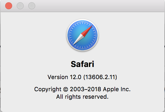

Apple have just released an update to their Safari browser - V12.0
First reports are coming in that with this version of Safari it is no longer possible to view Live Video from your Hikvision cameras.
The latest version of the Mac plugin currently available is V3.0.6.23 (on that landing page click Downloads at the left side; this version is dated Feb 12th 2018) - this is the latest version of the plugin we can find currently and it does not work with Safari V12.0.
We will update as soon as we hear of a resolution.
In the mean time, if you need to view your Hikvision cameras from Safari on your Mac it's probably best to not update just yet.
NB
Our attempts to downgrade Safari have so far been unsuccessful
[for us - it's broken - waiting for a new plugin]
You can access your Hikvision cameras using the Chrome browser on your Mac.
But the maximum resolution it'll show is 1920 x 1080 (looks horrible on a 5K iMac).
And, the Playback function seems to be missing.
We tested a Config change & Save in Chrome and that seemed to work OK.
