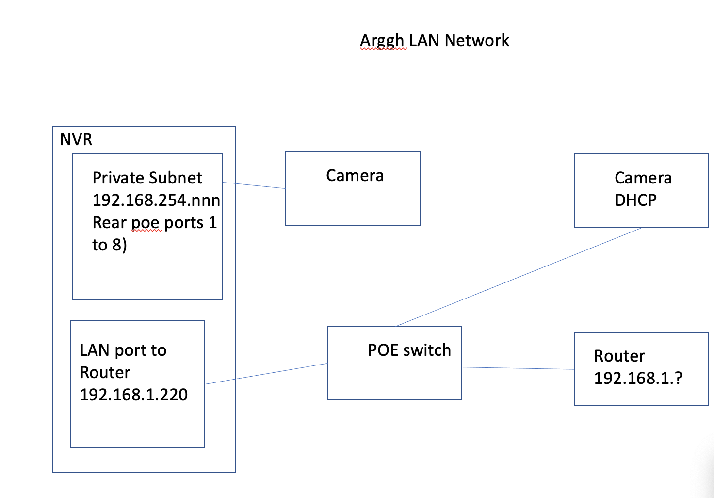

I’ve got 2 Hilook cameras connected to a PoE switch in the loft. From the switch I’ve got an Ethernet down to my router. From the router I’ve another Ethernet to the LAN on my NVR (Hilook MH108)If I scan devices online I can see both cameras with the NVR given ip addresses 192.168.254.5 etc

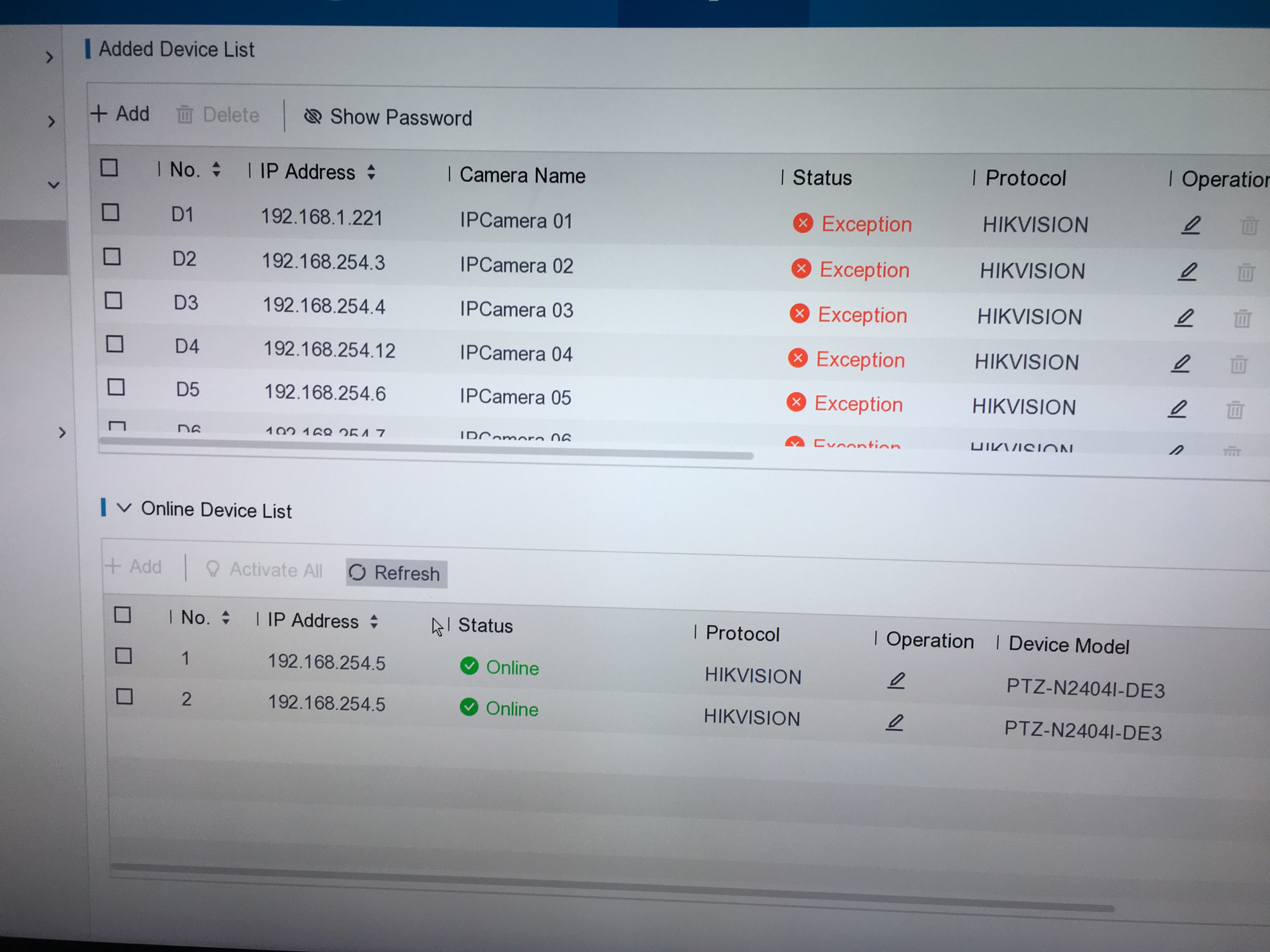

I’ve found the IP that my router is giving to my NVR 192.168.1.220 (have set this in my network page of NVR with gateway etc) and have found spare addresses 221,222 but if I edit the cameras to these addresses in manual just shows offline. I’ve tried all sorts.
im really struggling now to sort it out. Also if I connect the Ethernet from PoE switch to rear of nvr I can display the cameras ( but only one on plug n play) so I know the cameras work and the cabling is ok

Use the SADP tool to activate DHCP on both cameras (192.168.254.5) that have the same IP address.
You also have two different IP subnets (192.168.254.nnn and 192.168.1.nnn) are you somehow cross connected to the NVR private subnet?
Thanks David I did edit the two online devices with 192.168.1.xxxx but they just sit at the bottom. When I try to add them it says cannot add anymore ip cameras.
@Danny109 on the NVR are channels D7 and D8 available for use?
Are the cameras with IP 192.168.254.nnn connected to the poe ethernet ports at the back of your NVR? 192.168.254.12 seems out of range for the NVR private subnet.

What new IP addresses do the cameras at the bottom have?

The 8 poe ethernet ports on the rear of your NVR are on the NVR private subnet 192.168.254.nnn, this is exclusive to the NVR and has no route to your router. You may be able to access these cameras by enabling the virtual host (if available on your NVR).
Any cameras connected to your router network should have DHCP enabled and get an IP address from the router DHCP server. Find out the assigned IP addresses and edit NVR channels D7 or D8 and add the IP address there. I hope I got that right.....

Hi David yes it’s pretty spot on but my LAN port to router does go direct to the router and not the PoE switch. So both the NVR and the PoE switch go to the router not to each other. Had another play but no luck, I’ve pulled what little hair I have out now. I’m considering throwing the towel in and putting the NVR in the loft and using the Ethernet cable going down to the TV for HDMI over Ethernet instead. Will be straightforward plug n play then although I will loose the ability to edit with the mouse
None of my cameras connect direct to the NVR, they are all connected to the local network and get IP addresses from the router DHCP server. On the NVR I edit one of the camera channels and add the camera IP address, port, user id and password. I don't know if this will work on the HiLook NVR.
