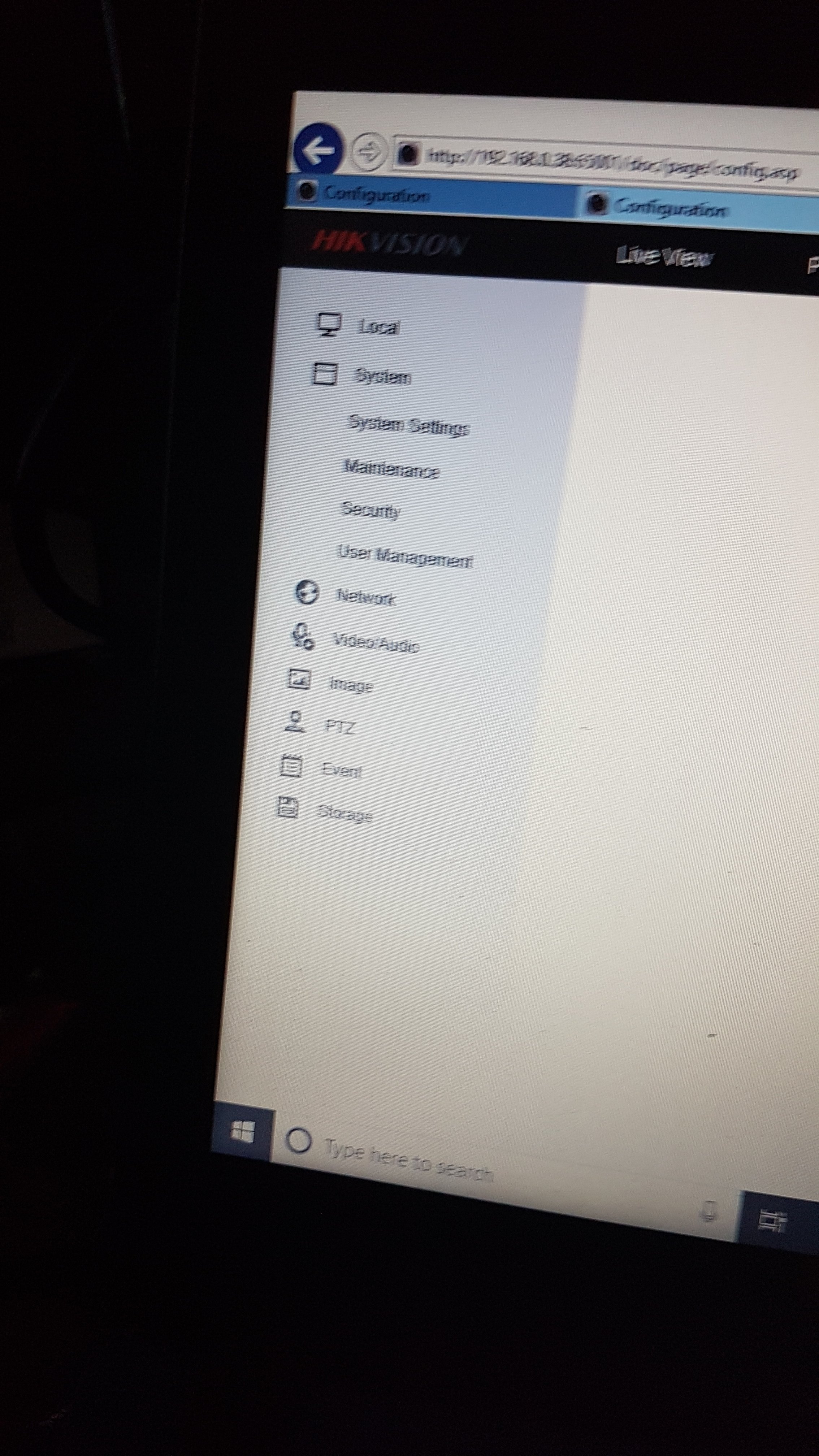

I there I am stuck at the auto tracking feature on the Hikvision website and I cannot find PTZ the control the auto tracking.i checked on youtube and most other users have the ptz on there configurations and I don't please some one help me.

What PTZ model do you have and what firmware is it currently on? (you will find the current firmware version of the camera under the System Settings menu)

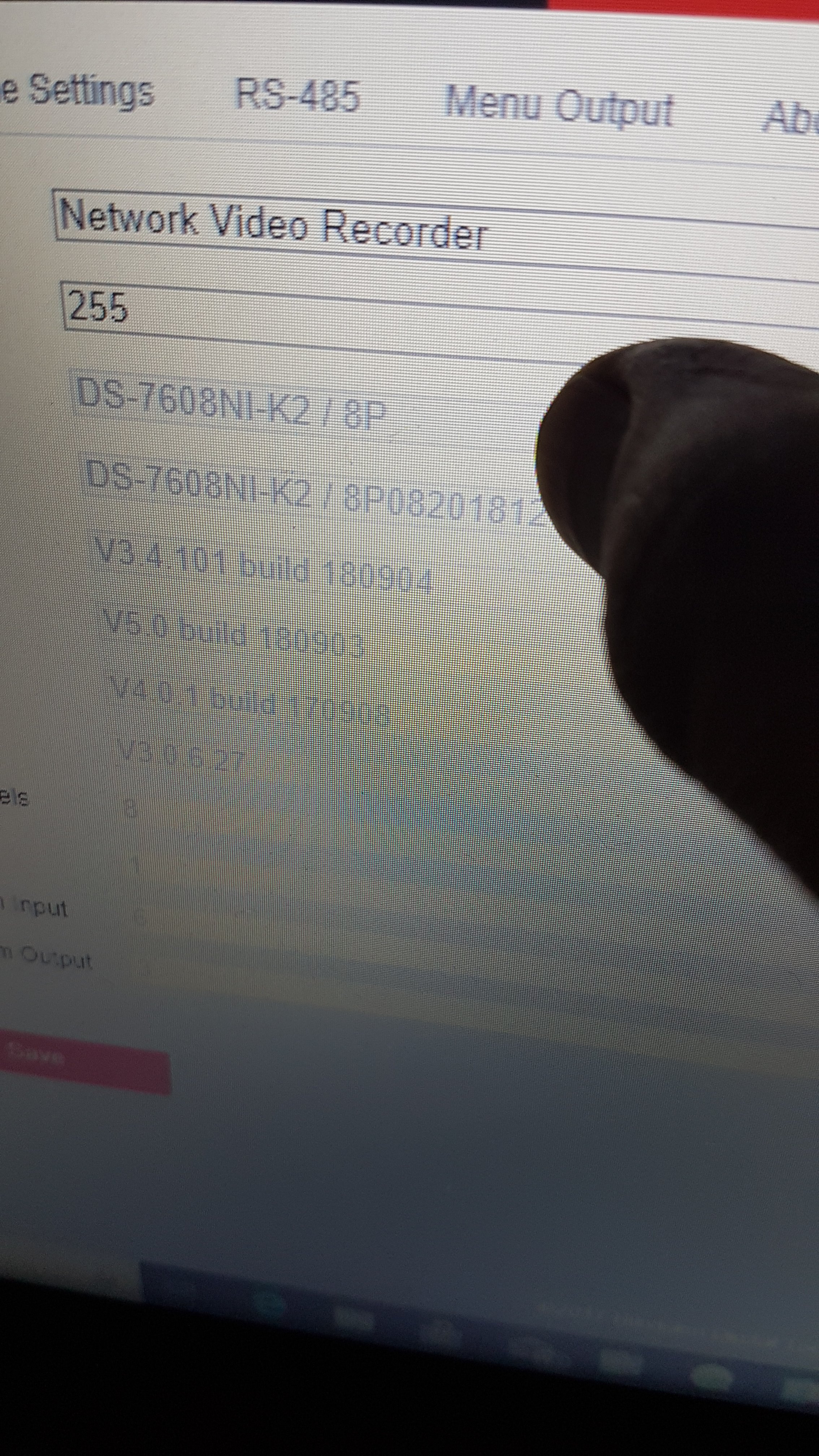

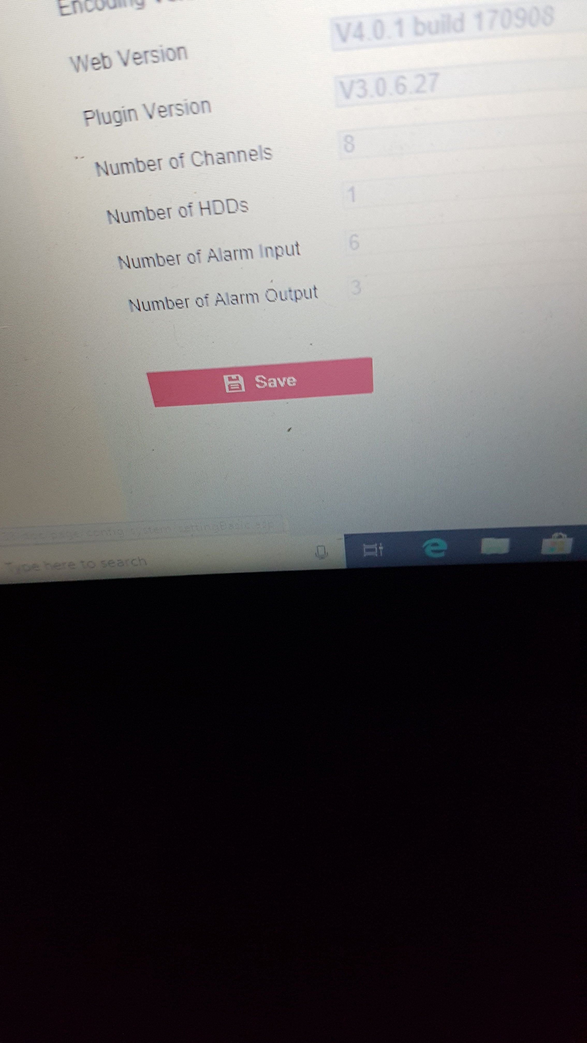

Ok the model is DS-2DE4A225IW-DE
And the firmware is v3.4101 build 180904
That is the NVR firmware, is the PTZ directly connected to the PoE ports on the NVR?

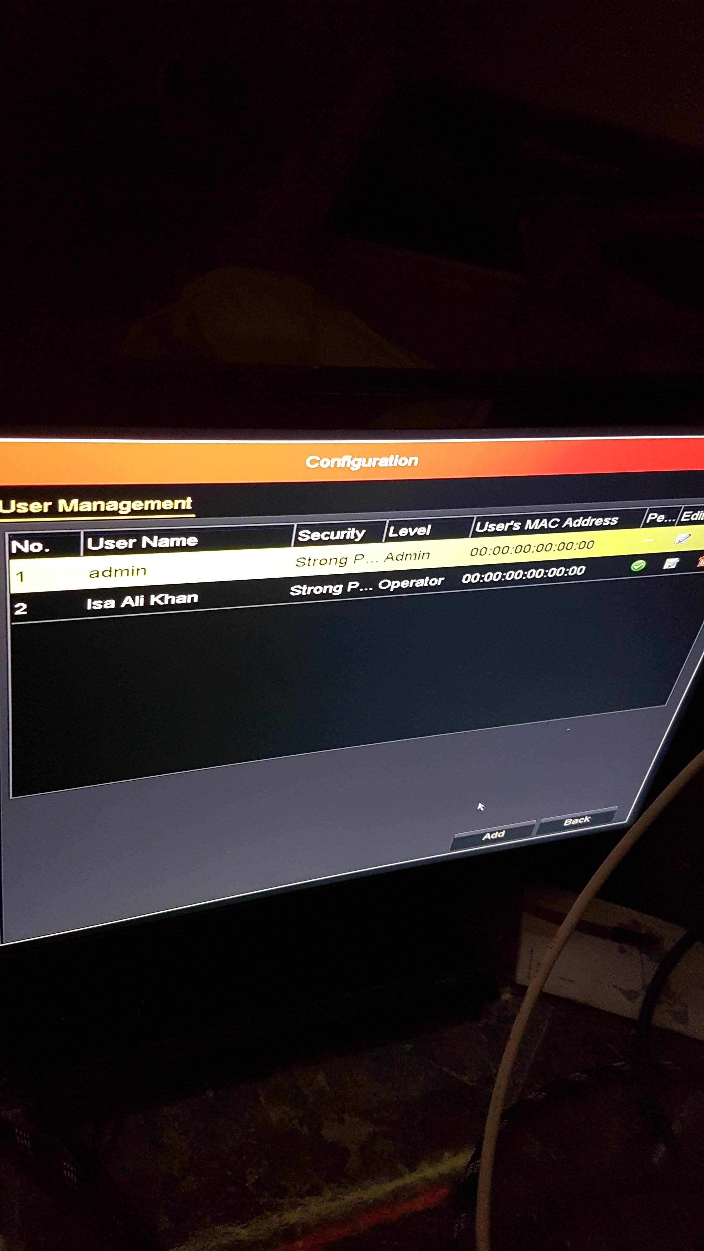

When I on advanced setting when I click save it say no permission

Are you logged in to the NVR as the admin user or as a regular user?

Ok, do you know the login details for the Admin user? You should have created the admin password when you first setup/activated the NVR

ok, so have you been able to login to the NVR with the admin username and password, can you please enable Virtual Host and then log in to the PTZ and let us know what firmware version the PTZ is currently on.
