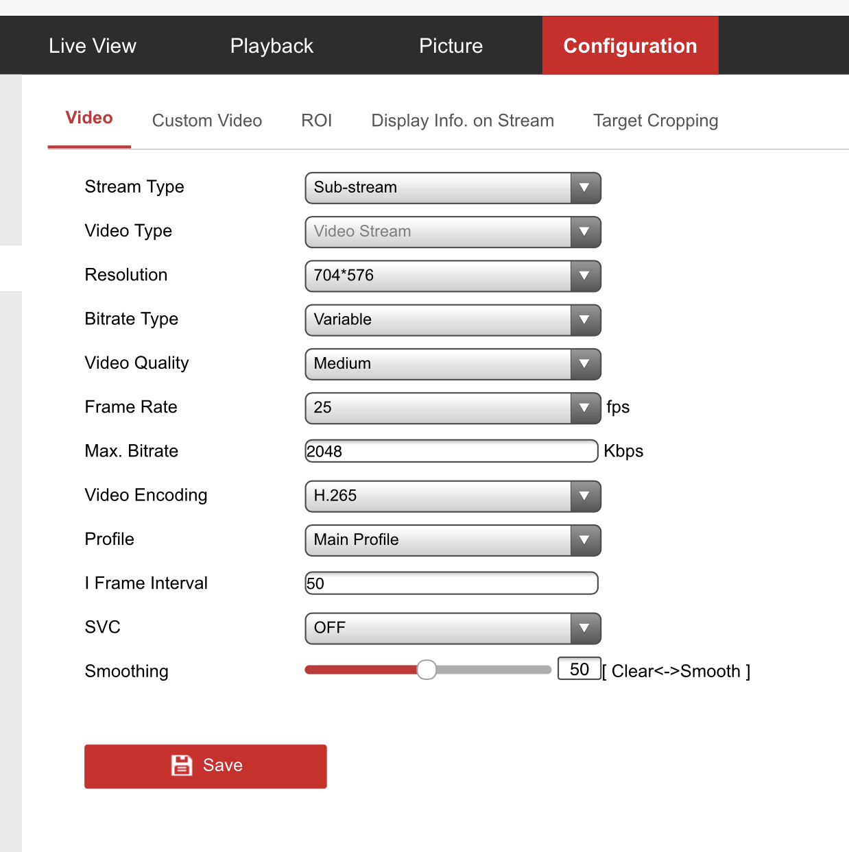

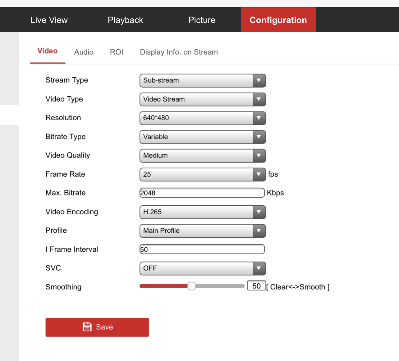

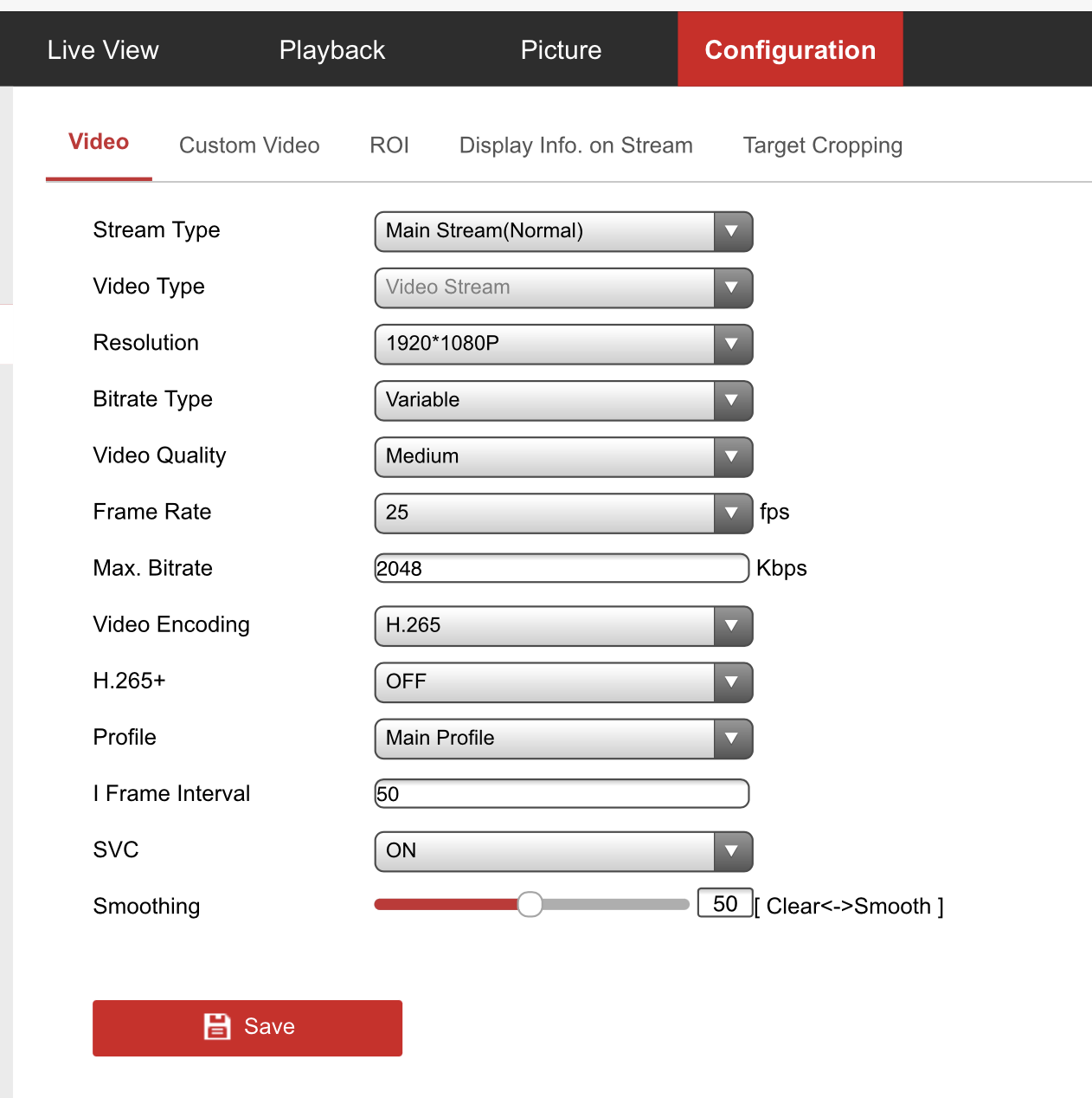

The attached screenshots show the mainstream and substream settings for each camera.
Appreciate your advice.

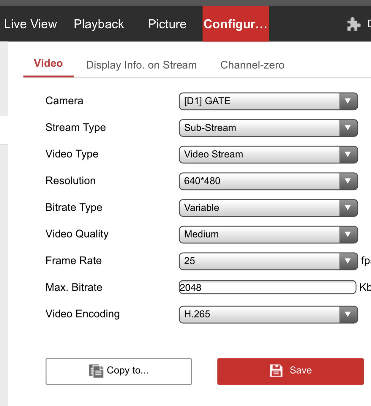

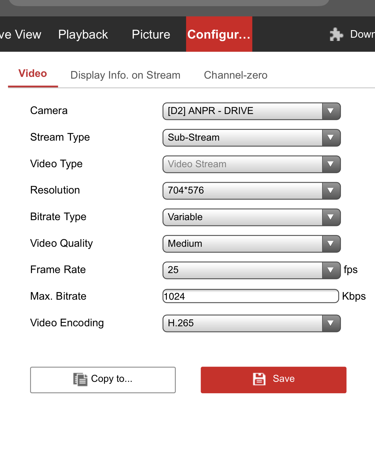

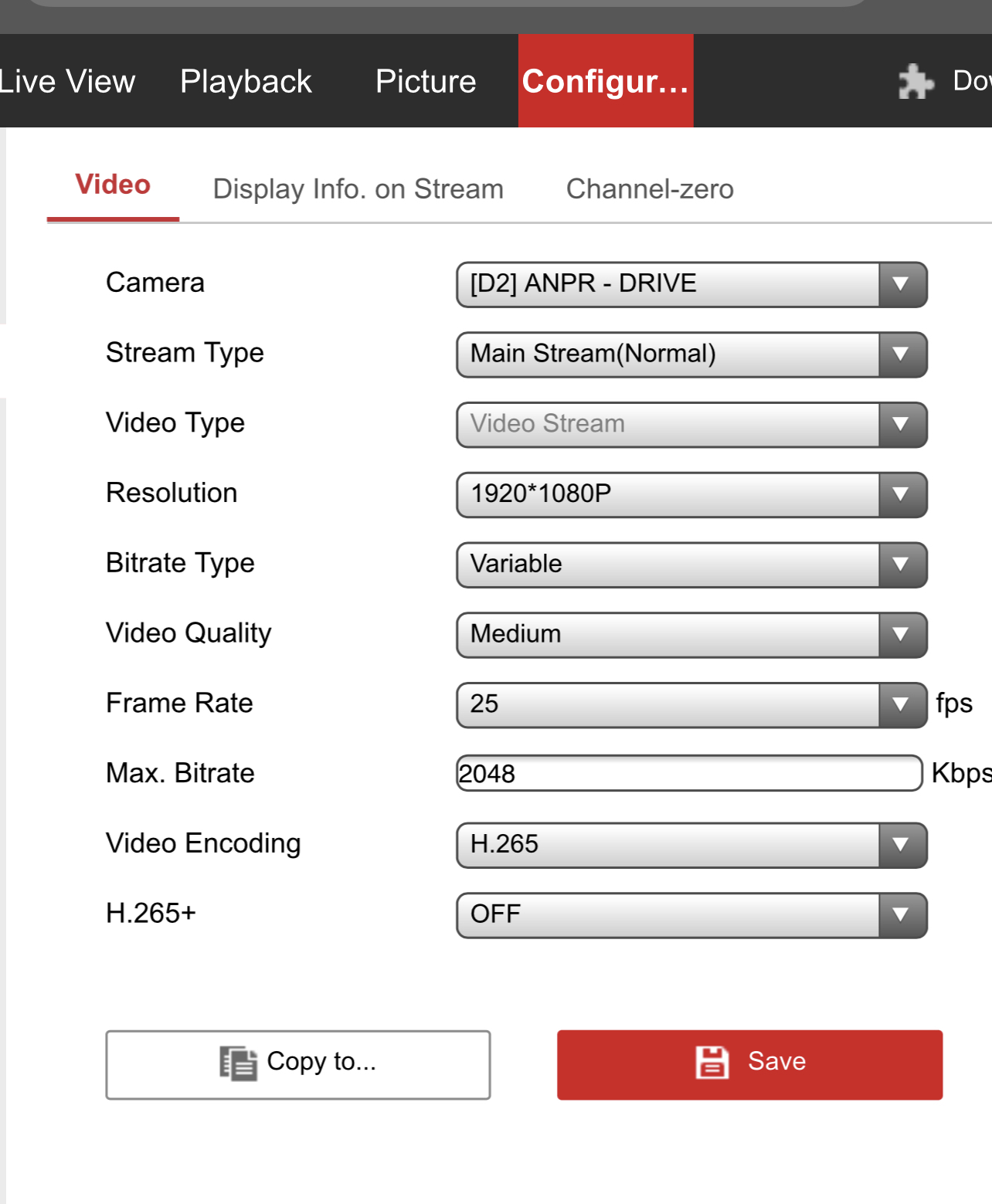

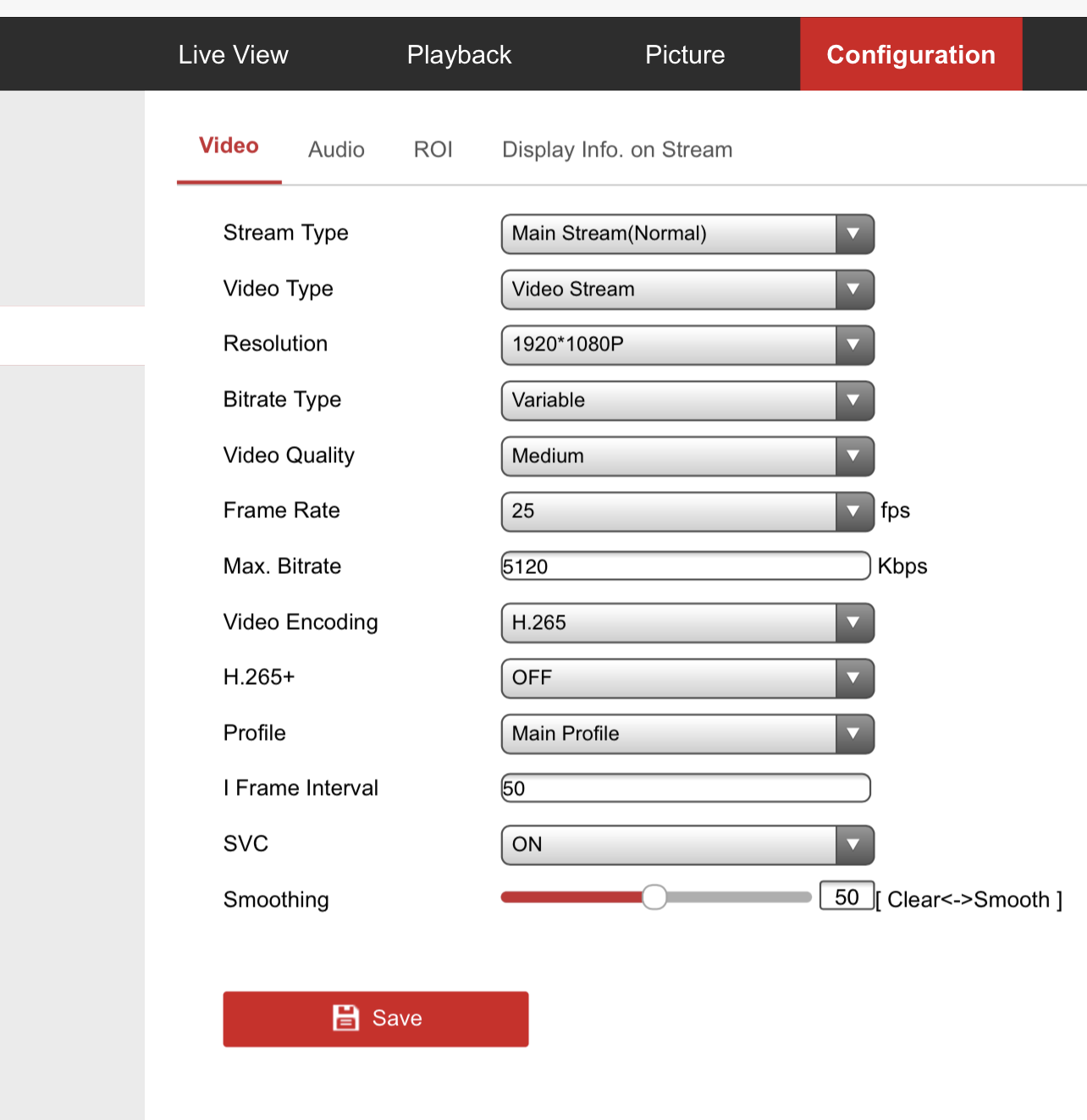

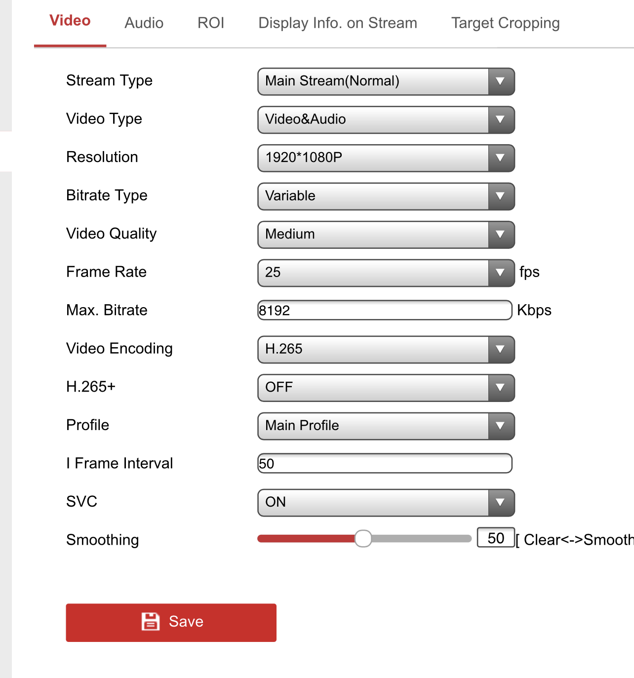

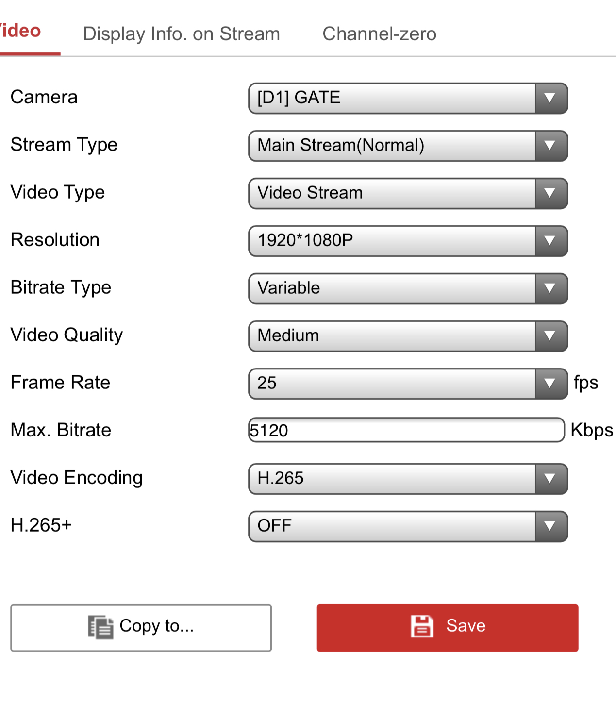

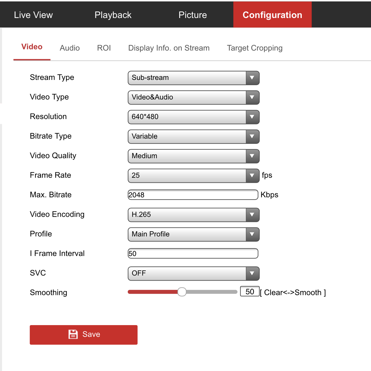

Hi,
Sorry to come back again on this topic - I've been trying out all sorts of settings but still have the same problem with live view lags on my phone.
Basically, viewing live footage using home wifi is fine but when using my iphones mobile data, it is still lagging in the footage and pixilation occurring. If I change the mode from HD to Basic in the Hik-Connect iPhone app then the footage in liveview is fine but then the picture is not that clear so I rather have it on HD mode but then the lags occur.
I have attached the current screenshots of the video setting of my three cameras I have connected to my NVR so can someone please, once again, advise what settings I should really be tweaking to try and get rid of the lags when viewing liveview using mobile data.
Also,
1. Is there any difference in choosing "Higher" or "Medium" for the Mainstream Video Quality as I do not want to loose too much video quality for the recorded footage on the NVR.
2. Resolution - this is currently set to 1920 x 1080P on all cameras as if I choose a higher setting, the the lagging/pixilation gets worse when using mobile data

Hi @kmb786
I would recommend that you put the 8MP bullet and 4Mp ColorVu cameras up to H.265+, Highest video quality, and max. resolution. H.265+ massively reduces the bandwidth used by the cameras and the 8MP cameras & ColorVu at night are very bandwidth hungry.
For the Hik-Connect remote streaming issue, I would unbind the NVR from Hik-Connect and re-add the NVR to Hik-Connect by logging into the online Hik-Connect portal and use the NVRs serial number. We have seen before that adding via the QR code does not always work outside your local network as it is not properly connected to the Hik-Connect cloud servers which allow for remote access.

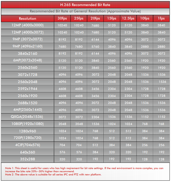

2) The below table shows you the recommended bitrates for different resolutions/frame rates
