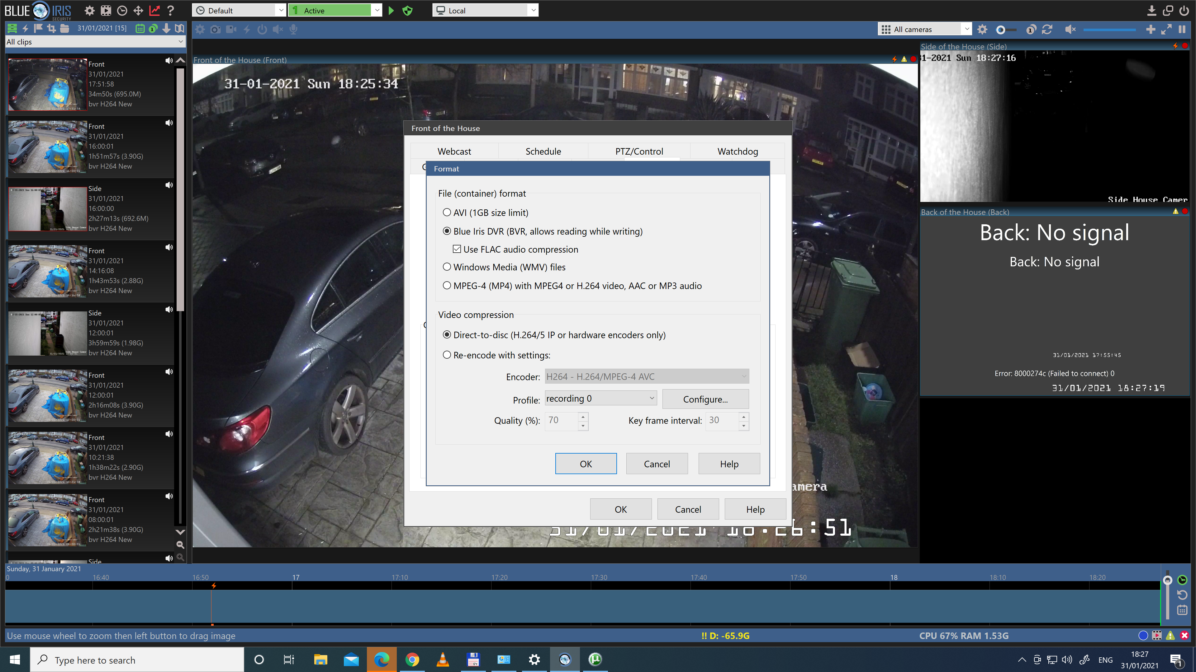

I have Blue Iris 5.0 installed on my Server which is only doing IP camera footage recordings. However the CPU is constantly on 80-100% from only 2 or 3 cameras, and they are not like 4k cameras or anything... Could you please tell me if it's possible or is there something wrong with my setup.
I think these cameras (at least two of them are h.265 and my CPU does not support hardware encoding so maybe that's the problem but I am not sure if I can/should change that in Blue Iris.

Also this is the set up for one of the cameras (same settings for other cameras are greyed out but I think that's because they are using the same config.:
Is really my hardware too weak for just that? I was hoping it will be so little used (the PC) that I can start using other bits on it like Plex etc.... But I can even watch a movie on it if the is too much compression on it.

Hikvision PTZ cameras
We're not familiar with Blue Iris, so it may be best to check directly with them.
But, we do find that h.265/+ can have a a big impact on the processing required.
Try it with h.264/+.
