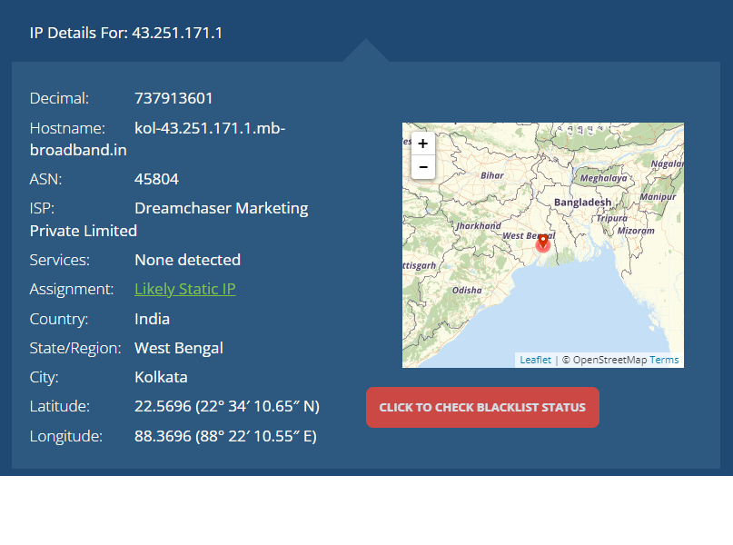

I'm guessing they got sorted as the thread is over 3 years old!
Sorry that the new respondent has wasted your time and effort :(
Unfortunately, they are just a spammer from an Indian marketing company, who would have hoped to make subsequent Posts with links to websites that they hope to promote.
Their naïve hope being that a link from this forum adds credibility to and/or drives traffic to whatever site they are trying to promote.
Of course, Google is way smarter than that these days ...
We have lots of automated processes that will typically prevent these Posts [can't say much more about the checks & balances applied ;) ].
They appear cleverer nowadays, as they can now use chatGPT or similar to generate plausible text responses [:eye roll]
They have now been banned.
