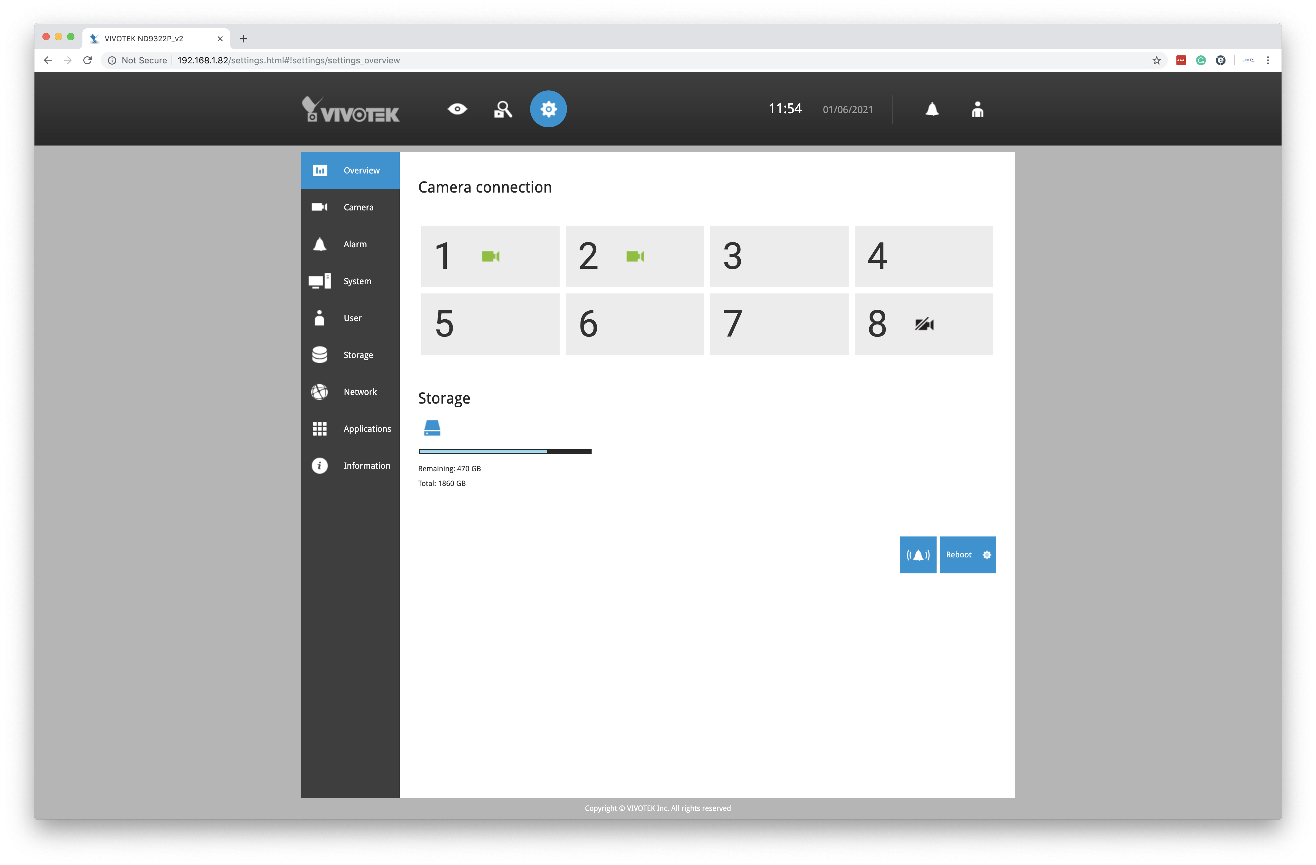

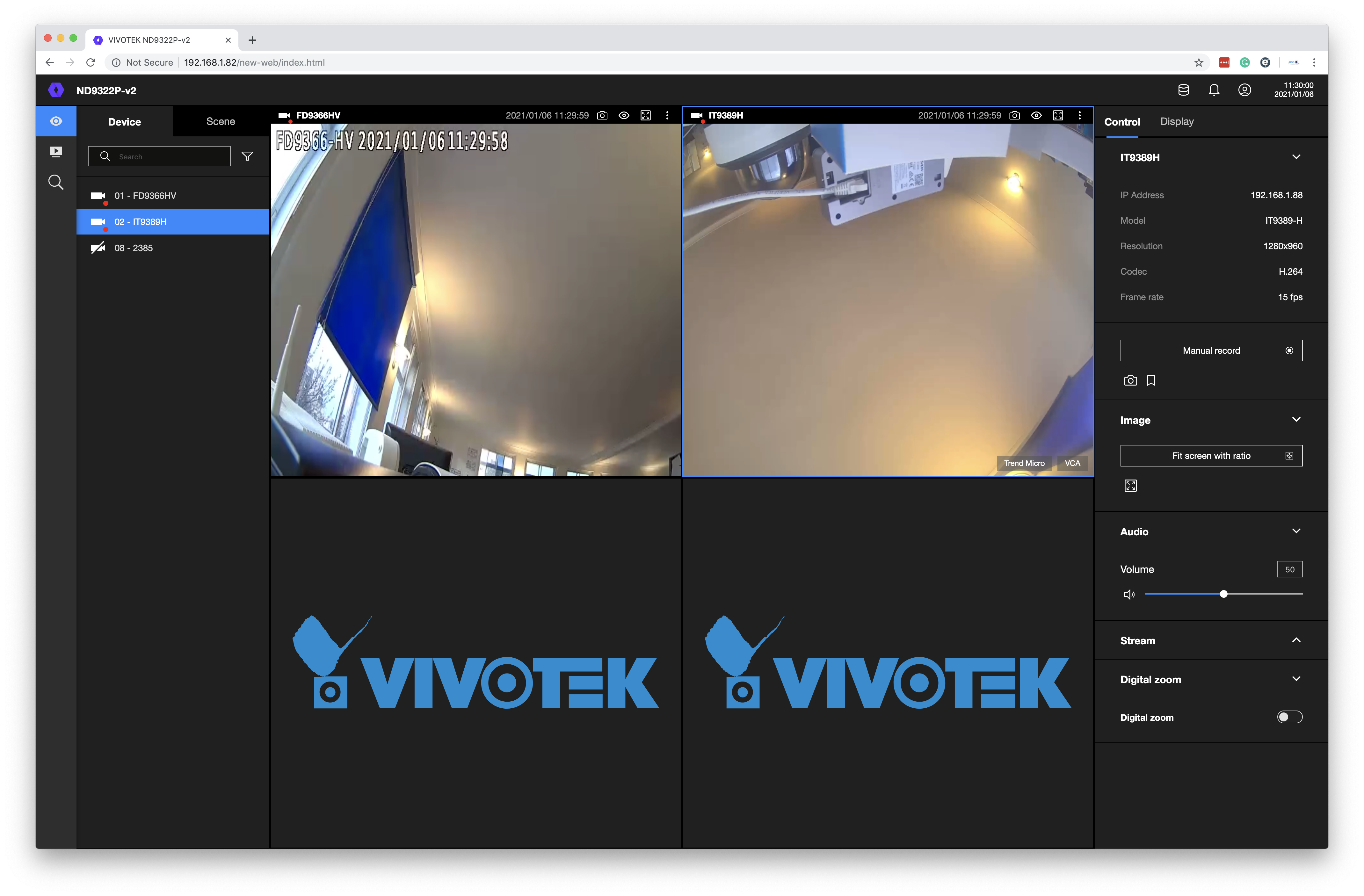

For Browser/VMS access on a Mac Vivotek is one of the best options as there other manufactures out there who have developed improved browser/Mac solutions but Vivotek is one of the only ones that offer a full NVR/Camera solution. Vivotek's new browser solution is still in development, below you can see a screenshot of our demo system accessed via the new browser interface. The current biggest limitations of this interface are that you can only access the Live View and Playback, you cannot currently access NVR/Camera settings. To access the settings menus you need to switch to the old browser interface (see below) which is quite easily done with the click of a button, we have discussed this with Vivotek and they have told us that they are working on a complete switch over to the new browser interface that will include the settings menu but their R&D team is very squeezed at the moment fulfilling multiple roles and so the estimate we have received for the full switch over is Q3/Q4 this year.
The bigger issue for Mac users when it comes to the limitations of browser vs. direct monitor access is the access to Smart Event settings, it is currently not possible to edit the Smart Event settings (e.g. draw lines for line crossing, draw intrusion detection boxes, etc...) from a direct monitor. With a browser, you can directly log into each camera to access the event settings but we have found on our office Mac when using Chrome that when you try to login to the cameras you reach the live view page but it then freezes up and you cannot access any of the camera settings. (we think this is probably to do with the fact that the UI when directly accessing the cameras is still very old [older than Hik's camera GUI] and so is not fully compatible with the modern browsers.

apologies, the screenshots are now in the above post.

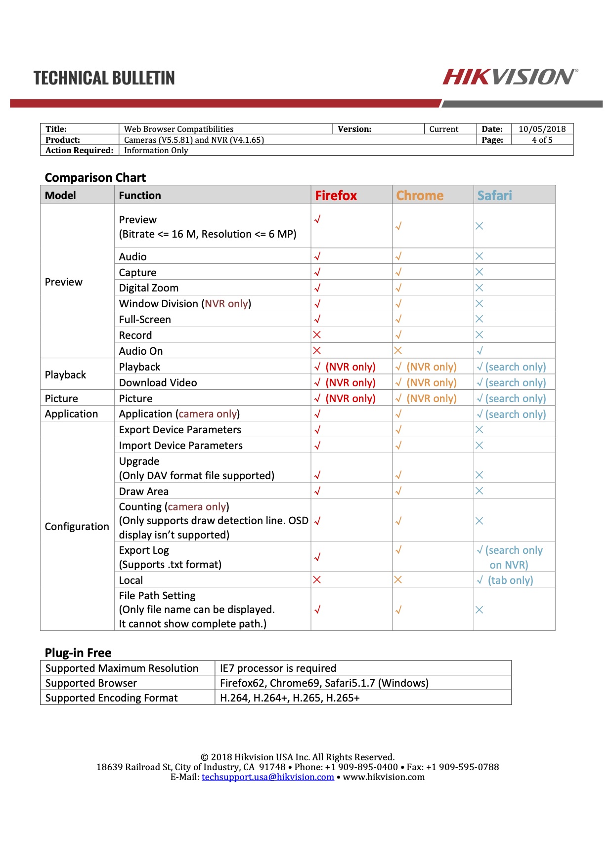

I came across this. Do you have anything similar/more up to date/comments?
Regards Michael
yes, this is the plug-in free solution that the I-series NVRs and G1 cameras are currently running, as far as I am aware not much has changed since this document, the only thing that may have changed is playback for individual cameras. (if they have MicroSD cards installed)
It was introduced in an old firmware release for the I-series NVRs and G1 Cameras, as long as you are running the latest firmware the plug-in free solution will be available. (see it mentioned here in v5.6.0 release notes for the G1 cameras)
Unfortunately, as I mentioned earlier this is only a partial solution, it is only supported by certain newer models (I-series, G1, and a few other) with no plans for support of K-series NVRs and older camera ranges (R6 - 2x22/2x42 or R0 - 2x12/2x32), also annoyingly the solution is not as stable on Mac as it is on PC with some features/menus that do work in Chrome/Firefox/etc... on a PC not working in the same browsers on a Mac.
