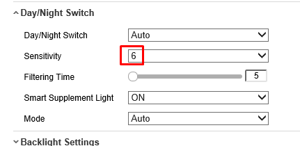

I bought the camera Hikvision DS-2CD2421G0-IW. I was glad that it records a great picture even in low light conditions. So I decreased sensitivity in the settings from 4 to 6, so the camera switches to the night mode in the lower light:
But now I'm having an issue - the camera during dawning and sunset continuously switches every 5 seconds for about a half an hour.

The problem is that I haven't found how to do it for my camera. On the above screenshot, we can see that the camera provides only one common setting that serves for both switches - from day to night and from night to day.

Hi @Denis28
If you look at the user manual for this camera you will see an explanation of the sensitivity and filtering time settings:
The sensitivity ranges from 0 to 7, the higher the value is, the easier the mode switches. The Filtering Time refers to the interval time between the day/night switch. You can set it from 5s to 120s.
So by going from 4 to 6 on the sensitivity scale you have actually made it more sensitive to light level changes which is probably why you are seeing this issue at sunrises/sunsets, if you want the IR switch to happen later you need to reduce the sensitivity to 2 or maybe lower.
The manual confuses matters in the way the operation is described. The Hikvision tutor explained during the HCSA course. When it says "the higher the value is, the easier the mode switches" - it's actually saying that the camera will switch from monochrome to colour easier IE in lower light. In essence the higher the number, the longer it stays in colour - it will remain in colour later into the evening and switch back from monochrome to colour earlier in the morning (at the expense of more visible noise). Because of this as you've seen, you get the issue where it switches back and forth during the transition at dawn and dusk. You need to set the filtering time up to at least a minute to reduce the issue, but it will still switch a few times as the ambient light fluctuates.
