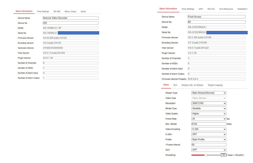

Hi. I have 7608NI NVR per attached with 7x cameras to PoE on it. Cameras are mix of 2x 2032 and 2x 246G2 and 2363G0 and 2363G0 and 2386G2.
In tweaking the 2386G2 based on posts on here I set bitrate =12,288, bitrate = variable, and video quality = highest.
I've noticed however that without my intervention when I go back to the Camera the above settings are changed to bitrate = 6144 and video quality = higher.
A similar thing occurs when I change video quality to medium in that it goes back to higher !!! Driving me mad as the 12,288 is ref'd on the HIK card as well.
Q: Why do the settings revert back after i have changed and they appear to have been saved?
Also, when applying h265+ to this situation and camera specifically I get blocking of people/vehicles (exposure at 1/150). This making them look like transformers
I remove h265+ and reboot (let it all settle down for a few mins) and the blocking stops. This occurs during day and night hours.
I installed a new 4TB WD Purple last week. With firmware current on NVR and camera are there any other pointers on issues with 265+ I wonder.
Q: Any tips or known issues with h265+ on this config or other settings on camera that need to be changed to enable 265+?
FYI: BLC = On/UP .. HLC = On/50 .. DNR = normal/60 .. Smart Events on camera x3 (1 of line crossing and 2 of intruder detection).
Grateful for help on the two above points. I did note a post referring to splitting cameras between two drives (putting the drives in a group) but all seems a bit hit & miss.
Thanks.
