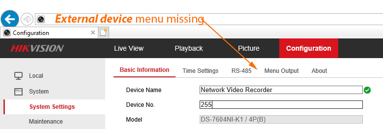

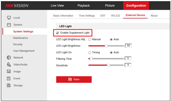

Been advised to always keep the system up to date to ensure that all security bugs are patched. So I have upgraded my DS-7604NI-K1 / 4P(B) from a V3 firmware to V4.30.000 build 200508. I got ColorVu cameras and they come with visible spectrum LEDs. The issue is that they are on all night and 2 of them disturbs my neighbors. On the V3 firmware I could turn them off here:
However on the V4.30 firmware I don't have that setting:
I can't find the setting on the web client (regardless of the browser) or the Hik-connect app or the iVMS-4200 or if I connect a monitor to the NVR directly. Virtual host is enabled. I also tried to downgrade with the web client but in firefox and chrome the file selection pop up window does not even pop up and from IE it says straight away that it failed.

Even with virtual host enabled I still don't have the 'external devices' tab in system settings. Any ideas??
You're probably looking in the NVR webpage menu when you should be in the cameras webpage menu. The idea of enabling virtual host is to allow access to the individual cameras own webpage. To access the cameras webpages with virtual host enabled you can either do it:
  1. Indirectly - Access the NVR webpage and go to Configuration > System > Camera Management. The virtual host will have added a link for each camera that you can click on to open that cameras webpage in a new window/tab.
  2. Directly - Access the cameras webpage at http://NVR_IP_Address:6500x (where x is the camera number). For instance if your NVR IP address is 192.168.0.100 and it's camera 3 you're wanting to access - it would be http://192.168.0.100:65003

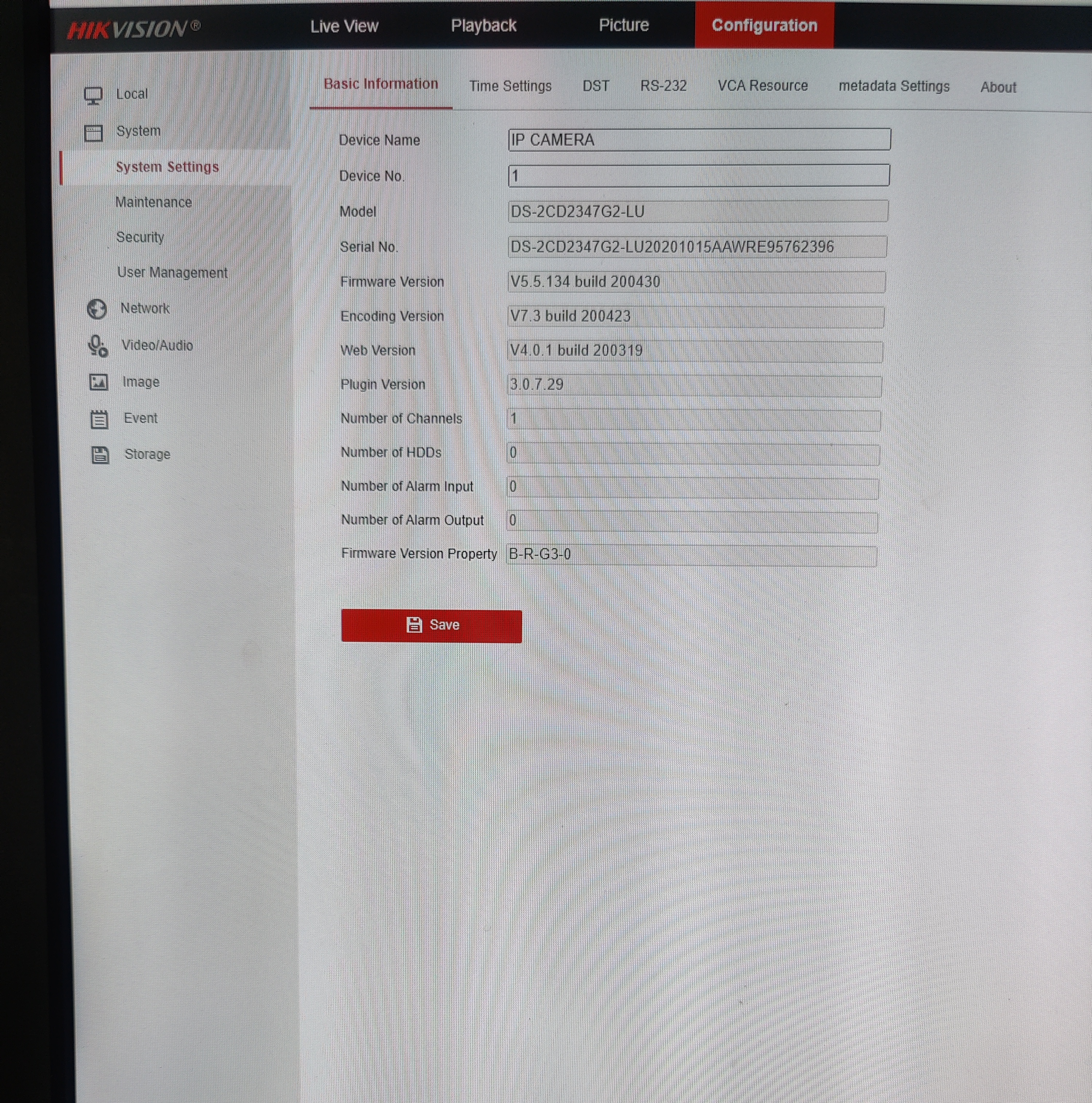

Thanks for the reply,
Just directly accessed the camera using the IP, I just don't seem to have the external device tab. See the photo I've attached.

Ah ok - you have the brand new 2347G2 ColorVu cameras just released? I've not managed to get my hands on one of those yet. Two things spring to mind:
  1. Hikvision may have moved the location of where you switch the light off on that model. Previously in the 2347G1 ColorVu cameras it was in System Settings > External Device. If it's moved it'll be in the Image section - check there.
  2. Did your camera come with that firmware of have you loaded it? The reason I ask is it's the same version and build as the G2 Acusense and I'd think the G2 ColorVu (which also has AcuSense) would have a different firmware but I could be wrong here.
Edit: Just checked point 2 and your model does use that same firmware. However there is a newer version 5.5.150 here - your camera model is included in the release notes supported models section:

Awesome, just updating the firmware now I'll let you know how I get on .

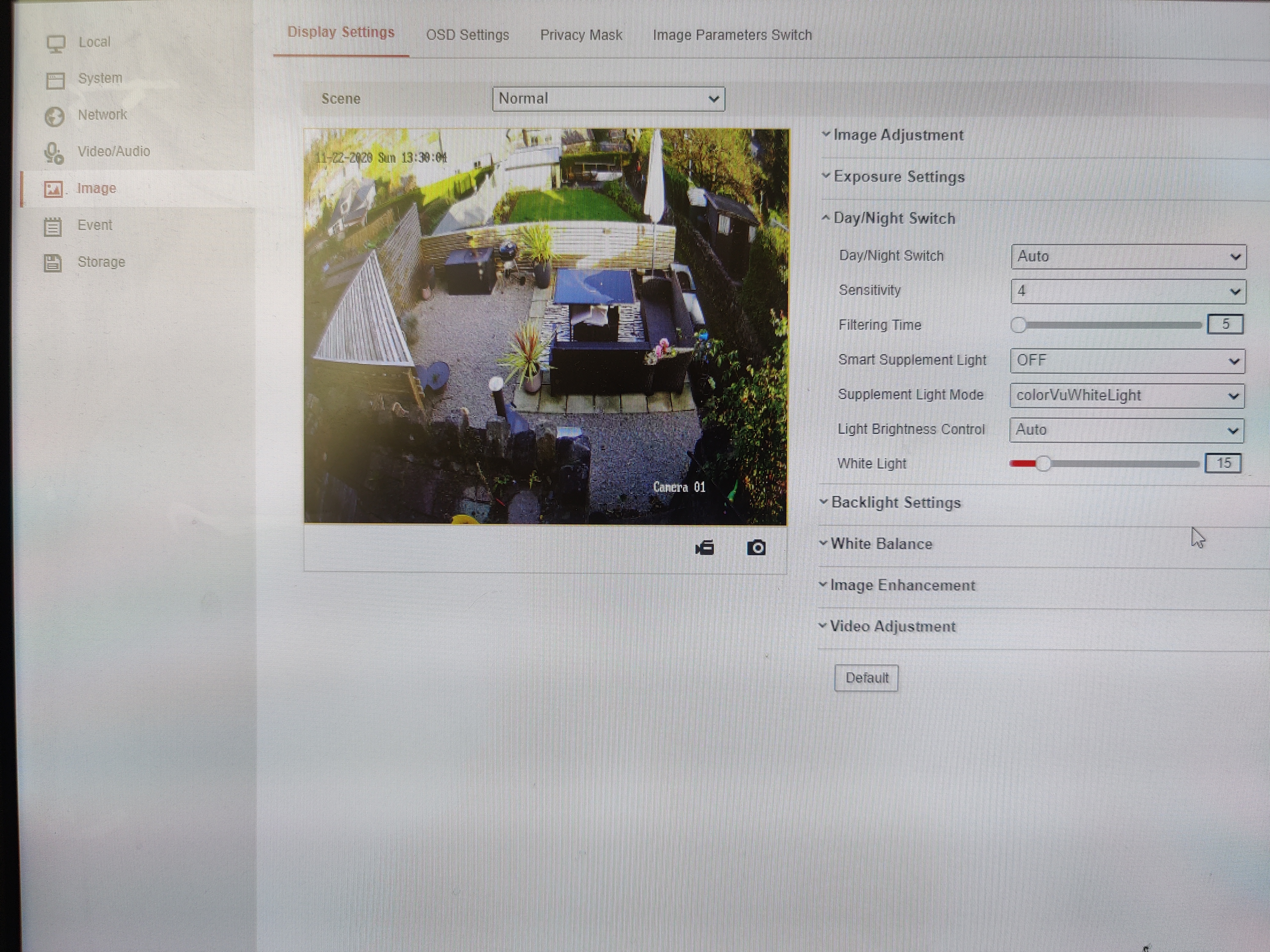

Sorted JB1970.
1 - Hikvision moved the location of where you access this control, I have looked there before but must of overlooked it.
It is in,
Image - Display Settings - Day/Night Switch.
Seems kind of obvious when you think about it.
Thanks for you help.
