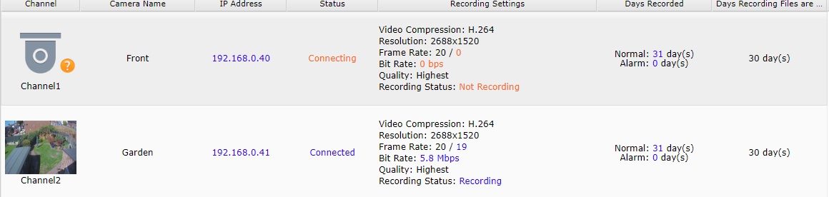

I have two of the above cams connect to Qnap.
About a month ago I notice an orange '?' alongside one of the cameras, but thought its working leave alone.

Sorted one fine but the other would not allow access the IP admin or SADPTool. Could not change the password or anything.

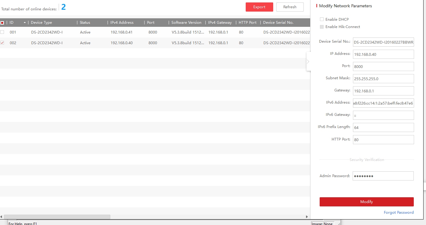

Sorry Phil my description was not very good. Here is the SADP screen
As you can see SADP can see both cams but I can access only .41
.40 will not allow me to sign in from any admin or change the password.
All camera IP's show up on the network, but .40 is inaccessible ATM.
Sorry for the confution.
Your firmware is quite out of date (at least eight updates).
The problem camera may have been hacked.
You'll need to go through the 'forgot password' process and ask your reseller / Hikvision Tech Support for a password reset code.
