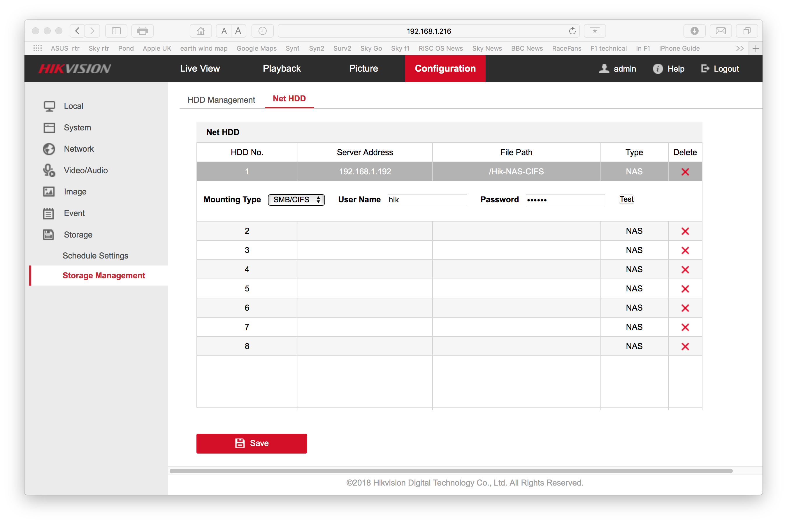

I have been trying to save the videos to one of the Synology NAS boxes. This is directly accessible from the IP program and I append an screen shot of the window with the file name of <Safari_web_page.png>. But nothing happens as a result, nothing is recorded in any of these folders on the NAS server.

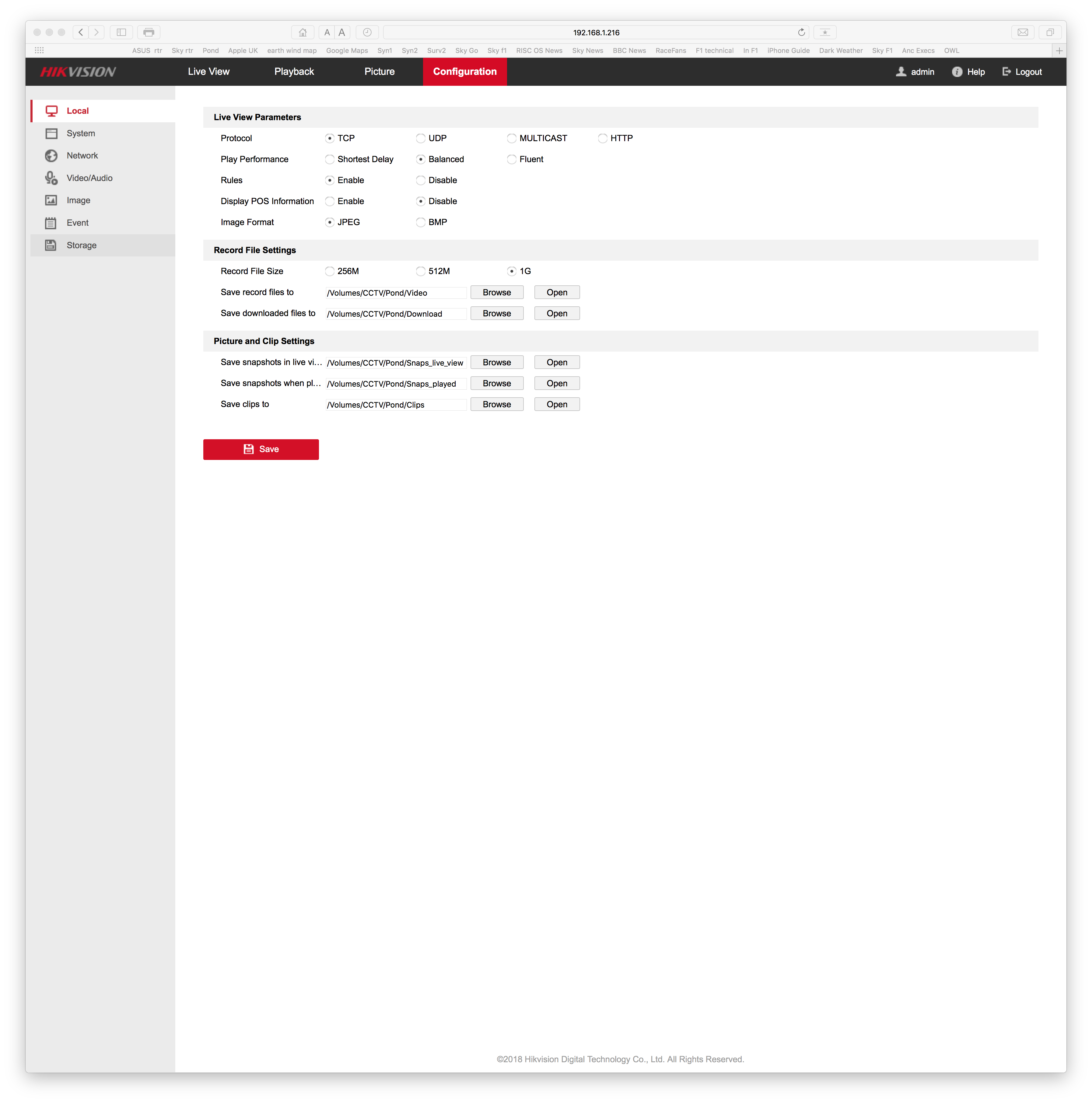

The VMS program does not have the same configuration option. It lacks the 'Local' option that is visible on the Safari browser, as you can see in the file <VME_configuration.png>. There is also an option to set up storage to a NAS but this does not see my NAS at all.

So I went on to try the second option, that of using CIFS to store video date, etc on the Synology NAS. This allows one to store multiple items on the server including all my existing data. I could make a Shared Folder on the Synology NAS which could be seen from the Hikvision camera as shown in the appended image <NAS_Server_visible_from_Hikvision_PlugIn.png>. I think this compares well with the image on page 11 of Hikvision's Guide. You should note that the images show a different layout as mine are from my Mac and Hikvision's are from a Windows machine; I also suspect I have a later version of the Safari plug-in that talks to the Hikvision camera over the local network, not to mention also a later version of the camera software.

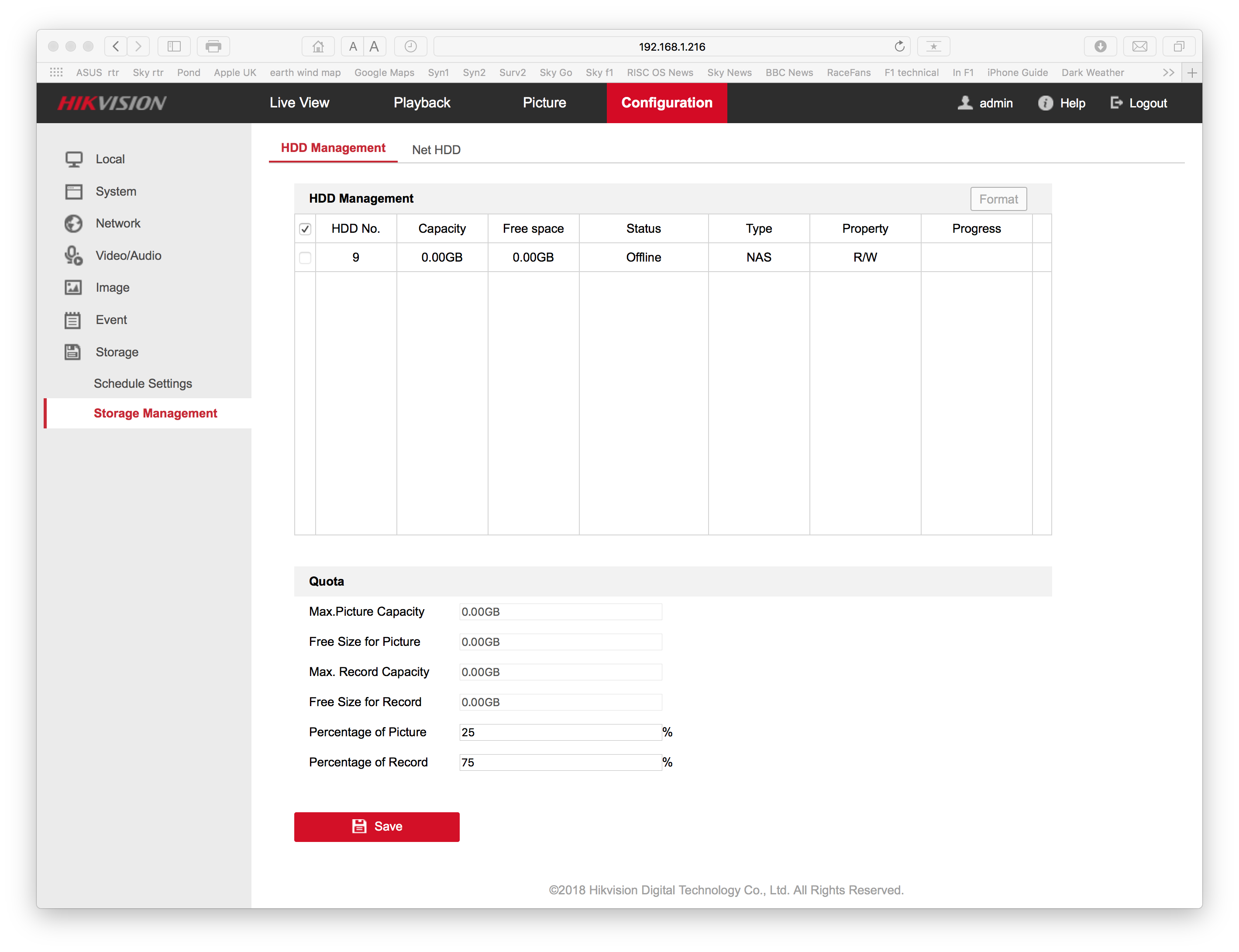

But I was not able to complete the instruction at the foot of page 11 and on page 12. See the appended image <Cannot_link_NAS_server_to_Hikvision_camera.png>.
My questions now are:
1. What have I done wrong that causes the failure to link the camera to the NAS server?
2. If I had got the link right, what would the Format button have done? Would it have reformatted the whole NAS server?
