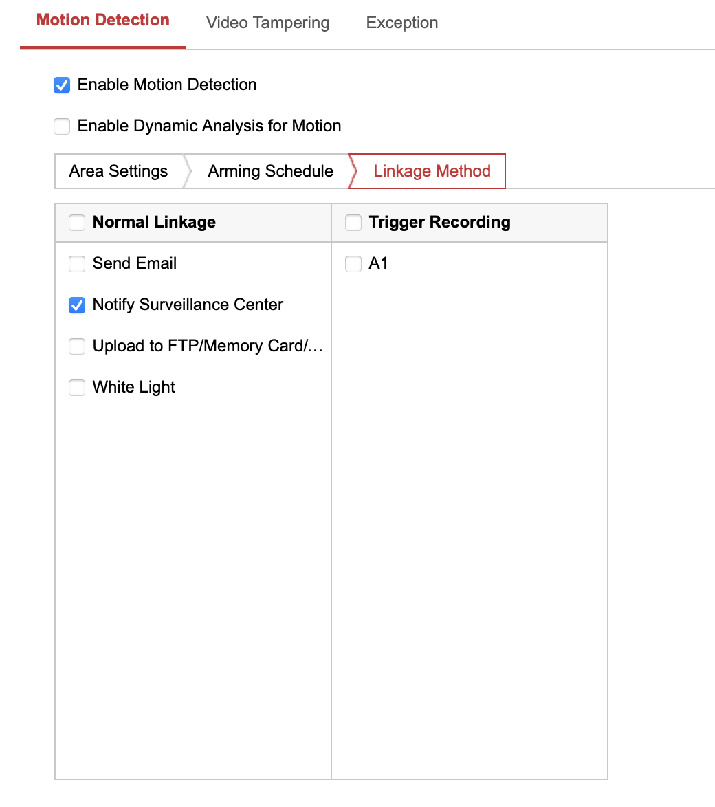

I'd imagine the white light linkage is still a no go on 5.5.801?
Well actually it is there, yes. A bit strange as I don't think it was in the G5 version of that .801 firmware, for the G5 you had to wait for the "special" build of 5.7.2. Hikvisions ability to confuse continues.
Here is a screen shot from my only remaining G3 ColorVu (DS-2CD2347G2-LU) showing that it is available:
