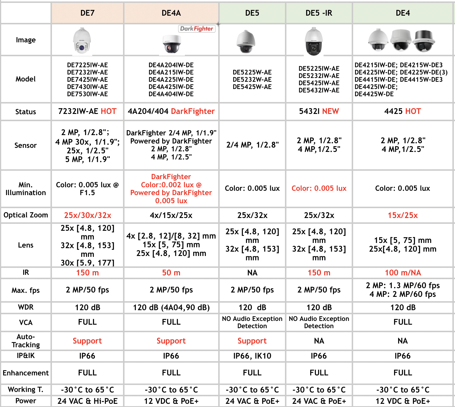

They both support Auto-tracking, we don't work with Dahua so our recommendation is always going to be Hikvision. The below spreadsheet shows you the other Hikvision models that also support Auto-tracking:

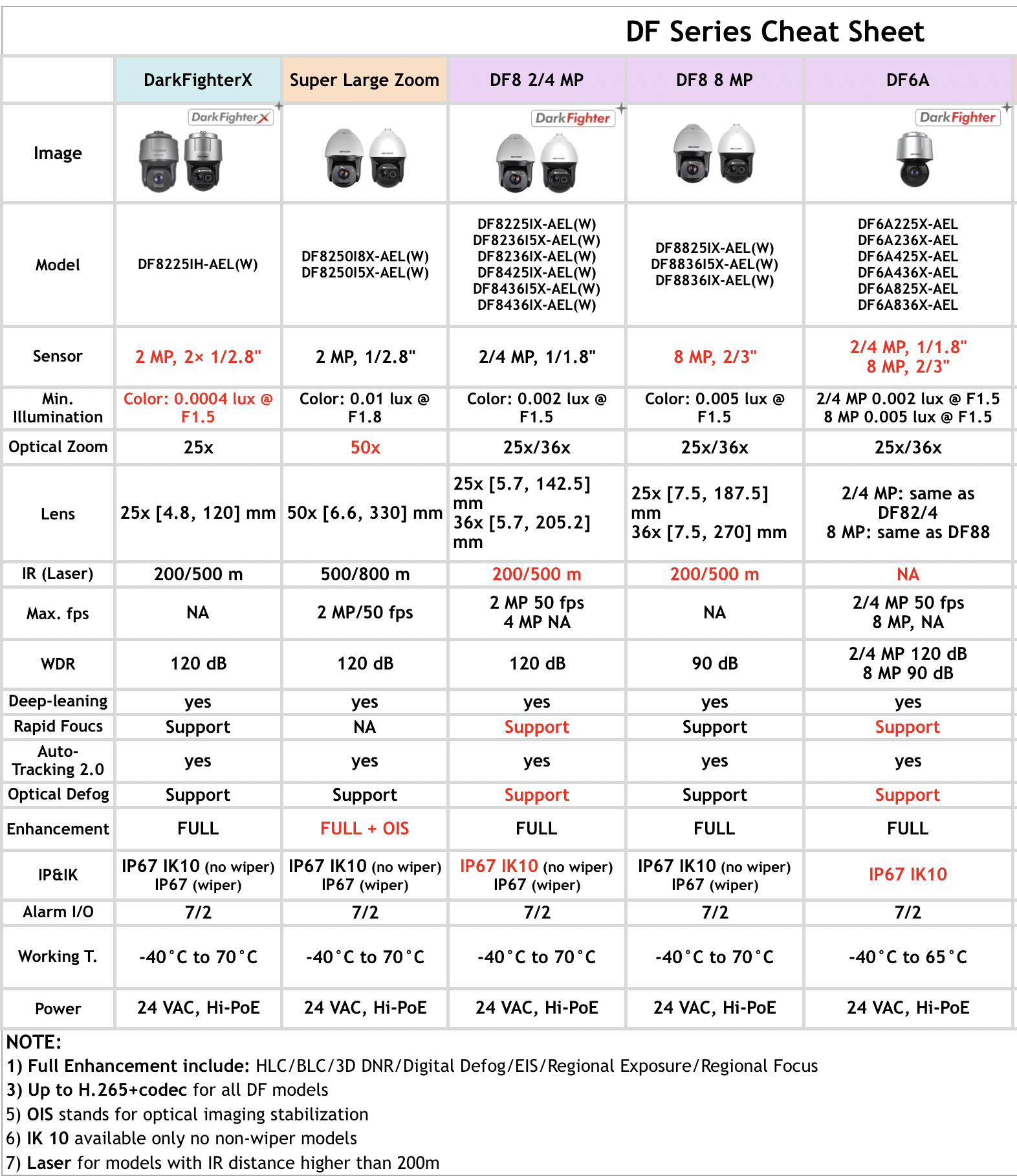

The only other model with a slightly better spec that we might recommend would be the Hikvision DS-2DF6A225X-AEL Darkfighter 2MP Speed Dome Camera as it has the Darkfighter Technology for improved low-light performance and it has the improved Smart-Tracking 2.0

6A225X-AEL will not be true colour at night, but with true Darkfighter which brings both hardware (larger sensor) and software improvements the camera can handle lower light levels at night than the 7225. See the specs for the 6A225X-AEL below (right-hand column):
