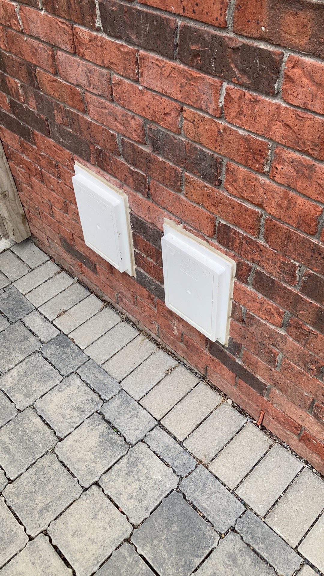

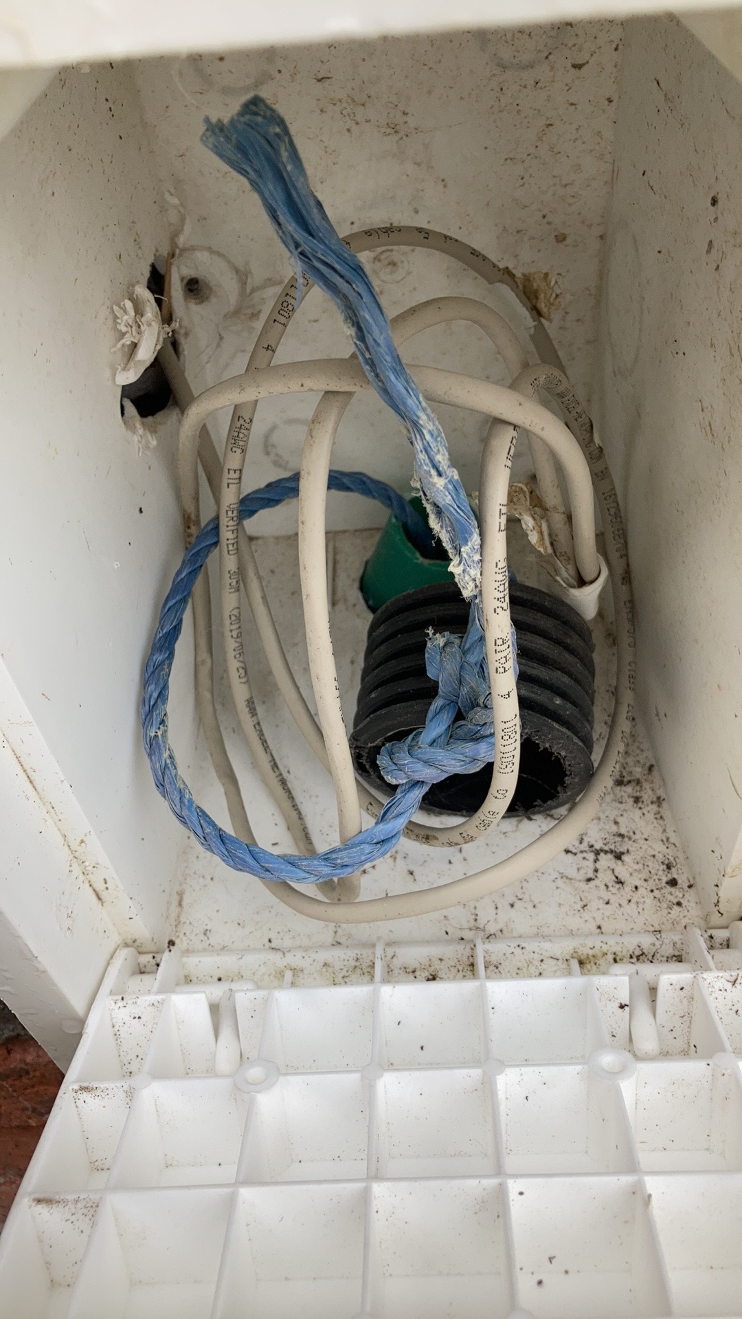

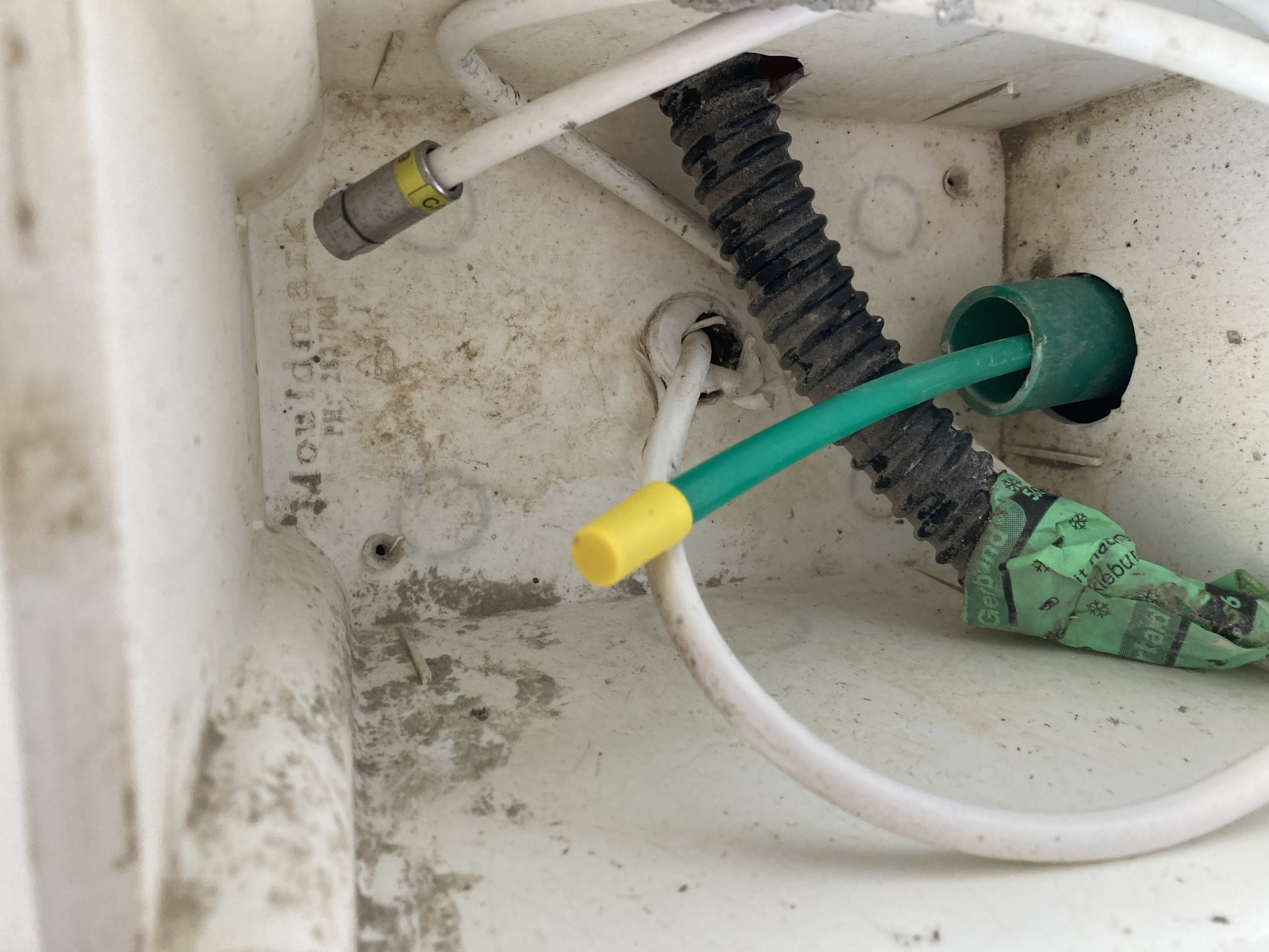

My new build house has a spare cat5e cable in an etu box on the side of my house. I would like to use it to for two cctv cameras I’m thinking of running it up the side of a drain pipe and connect two cameras.
would this work?

Possibly.
It's a network cable.
You'll need devices either end.
If 2 cams via one cable, then you'll likely need a gadget at the camera end to allow both to use the single cable.
