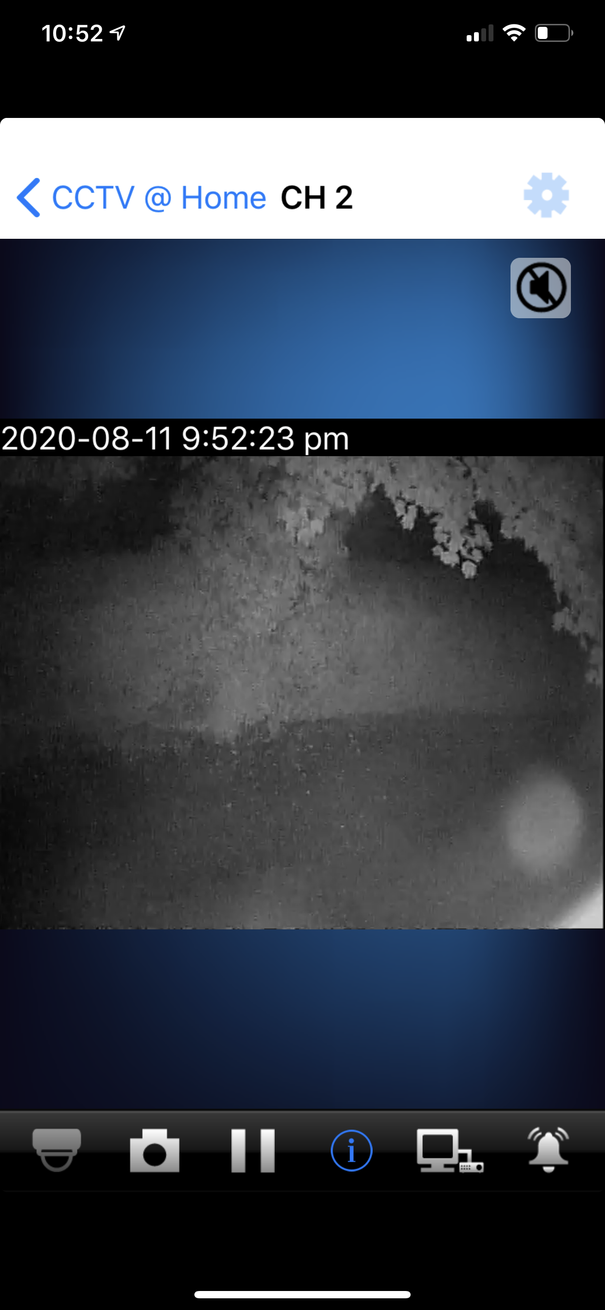

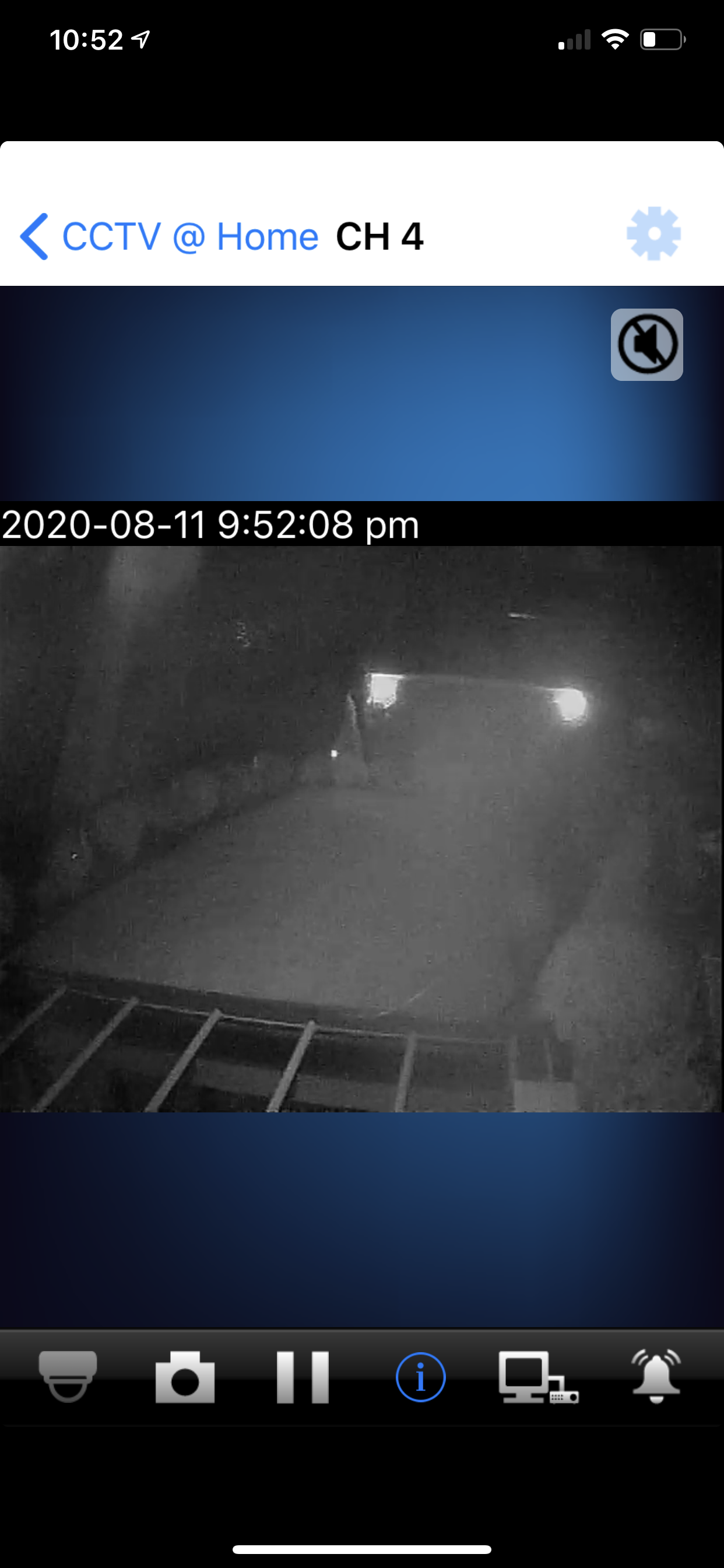

total noob here so forgive me if this question is a stupid one. I have a CCTV system that imo is pure garbage, in hindsight I think they saw me coming.
I paid £1k+ for a EZ960 DVR with 4 cameras a few year back, it felt dated the day it went in - the picture quality is dreadful and the net guard app is also poor (perhaps related to the system setup?).
The main reasons I wanted the system was for peace of mind, but also the convenience of remotest opening / closing my electric gates via the Alarm Out (relay switch?). But the camera quality is so poor and pixelated it gives no peace of mind, and the remote app fails more than it works (potentially due to the way it connects via some weird ip redirect service?).
