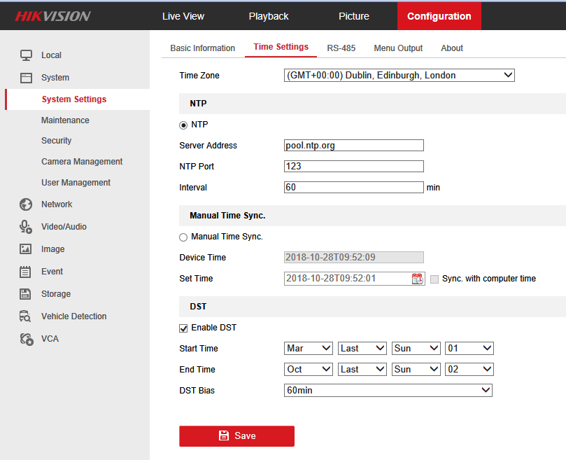

Here are the Time settings from my Hikvision 7604 NVR which successfully upated the time settings automatically overnight:
(obviously, people will need to select their region appropriate Time Zone at the top)
Thanks Phil,
