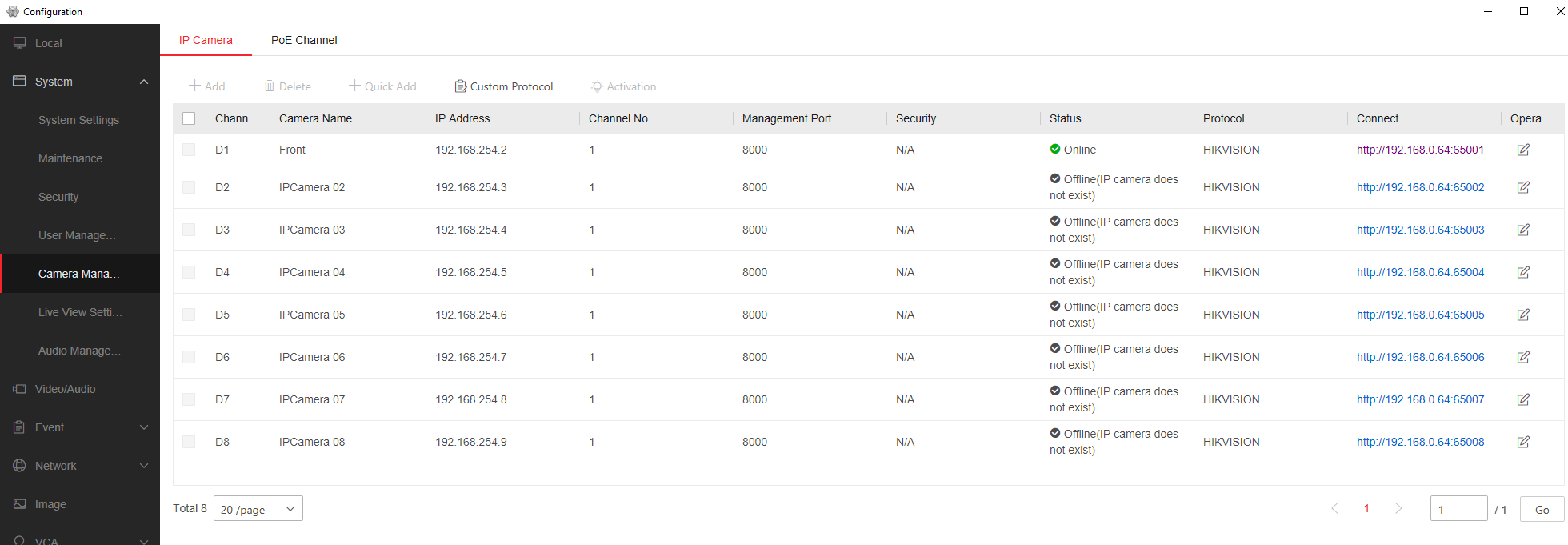

I have a DS-7608NI-I2-8P NVR and some DS-2CD2347G2-LSU/SL cameras. I have setup Virtual Host and can see the Connect URL's displayed in the (Chrome) browser configuration page:

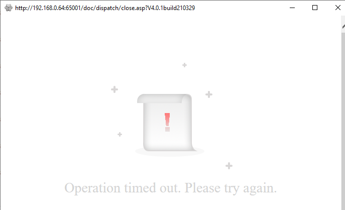

As you can see, I currently only have one camera connected. When I click on the Connect URL, a new window opens:
Notice the URL shown is not the same as the one expected as "/doc/dispatch...." as been added. If I click on one of the other camera links I get a cannot reach this page message (as expected) but the URL is shown exactly as it appears in the Connect field i.e. nothing has been added.
If I type the 192.168.0.64:65001 into a Chrome browser window I'm able to connect to the camera.
Why is the Connect URL being modified and preventing the pop up page from working?
