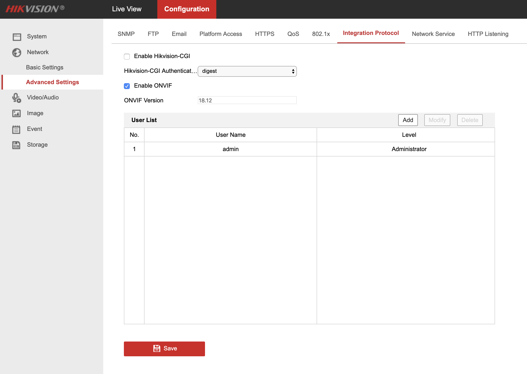

You may need to login to the camera and enable ONVIF (see below) to add the camera to the Q-NAP software with ONVIF

Thanks for teh superb response. I have enabled ONVIF on the camera, I have also created a user. The QNAP scan function now finds the camera which is great.

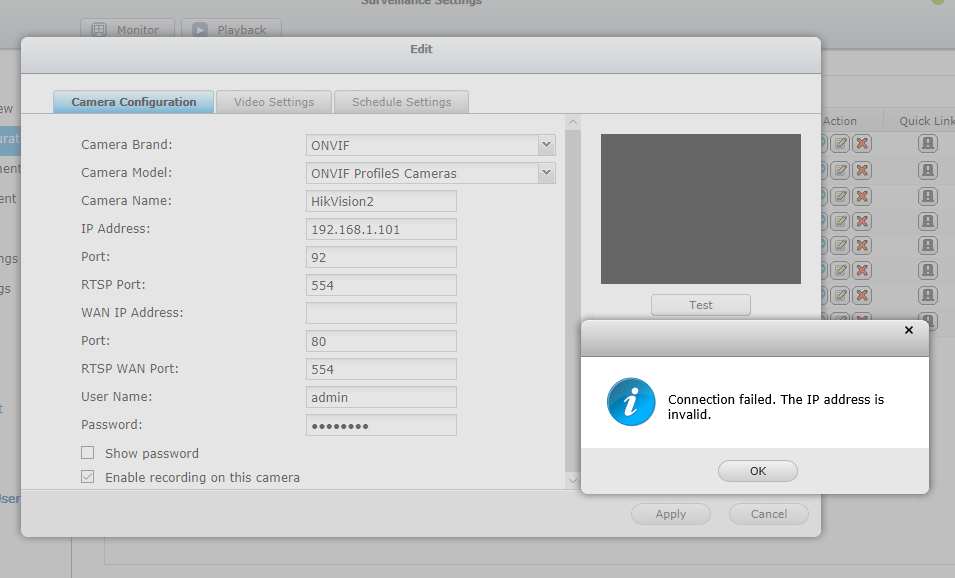

But it still doesnt give a picture. When I use the 'test' camera feature it says invalid IP address
Any ideas?

This is strange, is that IP address the address you used to login to the camera?
Are the port and address details shown in that screenshot what came up when you selected the camera from the ONVIF search results?
Did you change any of the cameras port details when setting it up? The default HTTP port of the Hikvision cameras is 80 and this page is showing 92, did you change these port details?
If you didn't change this then I would change the port to 80 on the Q-NAP page and try adding again.
If that still doesn't work can tell us what options there are on the camera model dropdown? Does it give you a generic or default ONVIF choice?
If it does I would also try that.
If none of the above works then you will need to speak to Q-NAP and get their advice on how to add an ONVIF camera to their software as we haven't worked with Q-NAP for many years.

I noticed that port 92 aswell, it seems to be doing thsi by itself. I did chnage this to Port 80 but it still failed

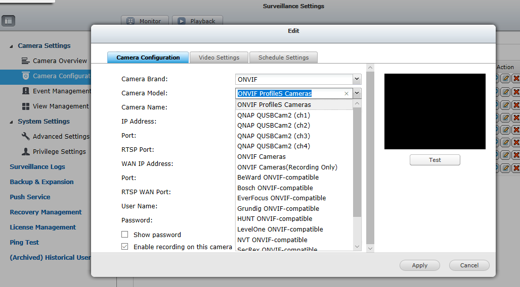

See attached screen shot of models available under ONVIF

ok, I would try the general "ONVIF cameras" option in the middle of that dropdown
WebGuy
17
3
that worked a treat, along with Port 80. Thanks ever so much for the AMAZING help!

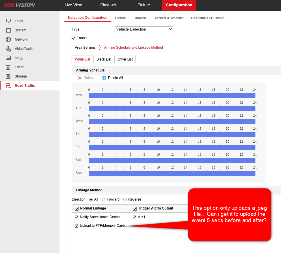

I was wondering if I can pick you brain about another issue I have been working on for a few weeks and I cant seem to resolve. I have a HikVision DS-2CD4A26FWD-IZS/P camera - its an ANPR camera. It has a 128Gb SD card installed. When it detects a vehcile or event I want it to upload a video 5 secs before and after the event to an FTP server. It uploads a static jpeg file of the event but I cant get it to upload the video (avi or jpeg).
Any idea how I do this. I suspect the same scenario would apply if you are using the line crossing feature, when somebody crosses the line send a short clip to an FTP server.
Your help would be greatly apreciated

Hikvision support has confirmed to us that it is only possible to FTP JPEG stills currently, video via FTP is not supported by the Hikvision cameras.
