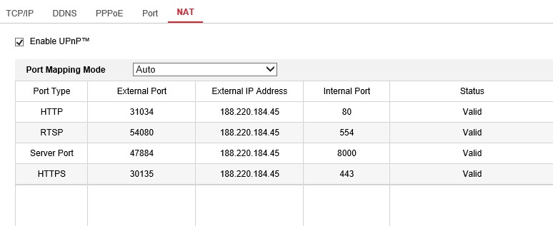

If you're connected using Internet Explorer - the menus of interest are:
- Network > Basic Settings > TCP/IP tab
- Network > Basic Settings > NAT tab
That will confirm whether you are using DHCP and/or NAT/UPnP.

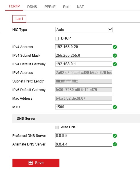

Hopefully I have managed to get the shots that you want.
OK so you have a static IP but you have the UPnP enabled. UPnP needs to also be enabled in your router for that to work - it probably already is by default. It's designed to make life easier and automatically map your ports but doesn't always work great. The only time I've ever used it on an installation was when it wasn't possible to login to the router and set up port forwarding. Personally I would set up port forwarding:
  1. Uncheck the box for "Enable UPnP" and apply the change
  2. In the ports tab - change the port numbers for http, server, RTSP from their defaults. It's not uncommon to see connection attempts on the default ones. I use 50000 http, 50001 server and 50002 RTSP (having them consecutive makes the port forwarding easier in certain routers - 1 rule rather than 3). After applying the change you'll need to connect to your NVR at http://192.168.0.20:50000 going forward
  3. Login to your routers homepage at 192.168.0.1 and find the port forwarding settings - depending on model usually in security or firewall.
  4. Create a new rule to forward ports 50000 - 50002 TCP from any destination to internal IP 192.168.0.20

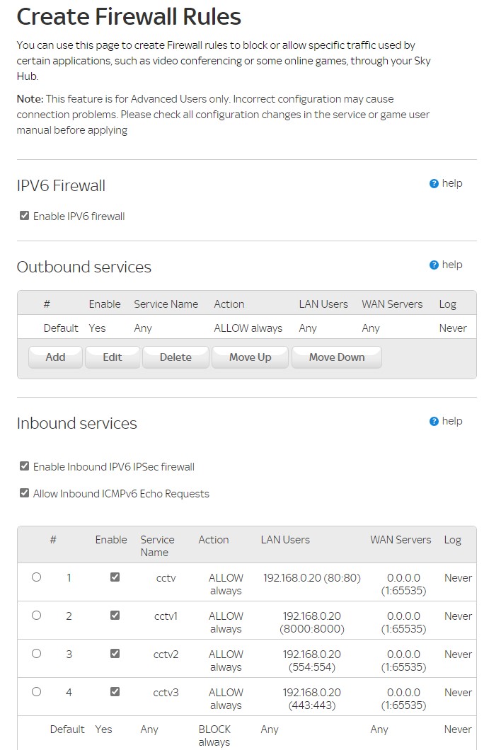

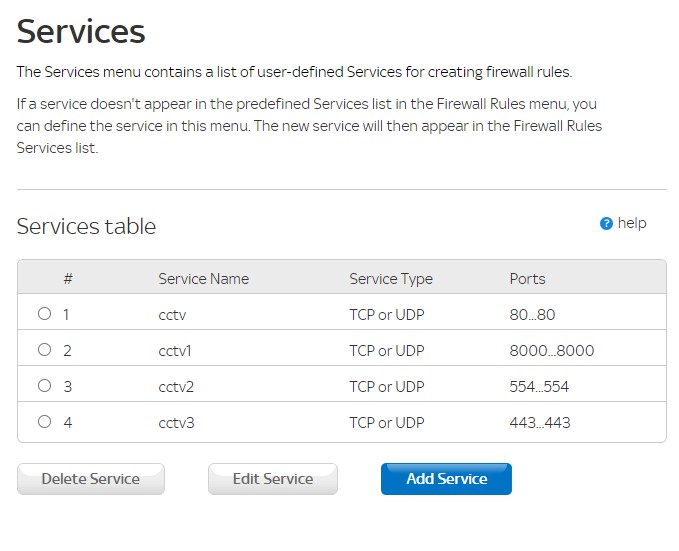

I have been into my router and have (hopefully) attached a couple of images for your comments please.
My CCTV setup consists of the NVR and two cameras, both of which are connected directly into the NVR.
How do I determine which is which from the listed 4 items? Do I have to set up port forwarding for each device? I assume that the start port will be the 50000 and the finish port will be the 192.168.0.20.
Having looked into this a bit more I'm not sure if I should be doing the port forwarding in Security/Firewall Rules or Security/Services

On the Sky router it's done in two steps - you create a service including the port numbers, then you allow that service to access the NVR.
Looking at that first image (Router Services) showing cctv, cctv1, cctv2 and cctv3 - if they were already there when you found that page then someone has previously tried to set up port forwarding. As NAT was switched on in the NVR, it would explain whey you've been having issues.
1 First carry out steps 1 and 2 on my first message (change the port numbers and uncheck the NAT box in the NVR if you haven't already
2 In the router edit the "cctv" service to Type "TCP", Start Port 50000, End Port 50002
3 Delete the services "cctv1", "cctv2" and "cctv3" as they'll no longer be used
4 Delete firewall rules 2, 3 & 4 as they'll no longer be used

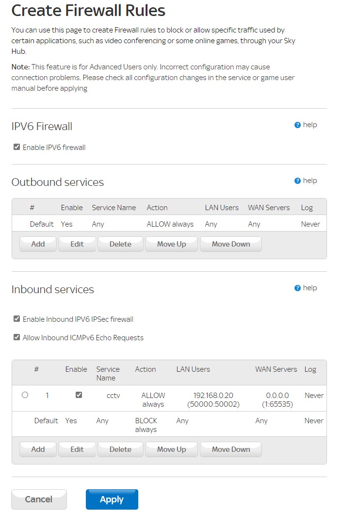

OK I have done pretty much all of that. Deleted those not required etc. but, when I come to change the port numbers it is telling me that 'The selected service is in use by the Firewall Rules' and that I will have to make the amendment in that section. However I'm not sure if I should be changing things in the IPv4 area or the iIPv6. The Ipv4 only gives rom for the figures 5000 and 5002 and not 50000 and 50002
Ok you'd need to delete the rules first and apply the change before you can delete the services. It's IPv4 and you can definitely put 5 digit numbers in there

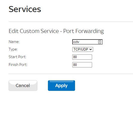

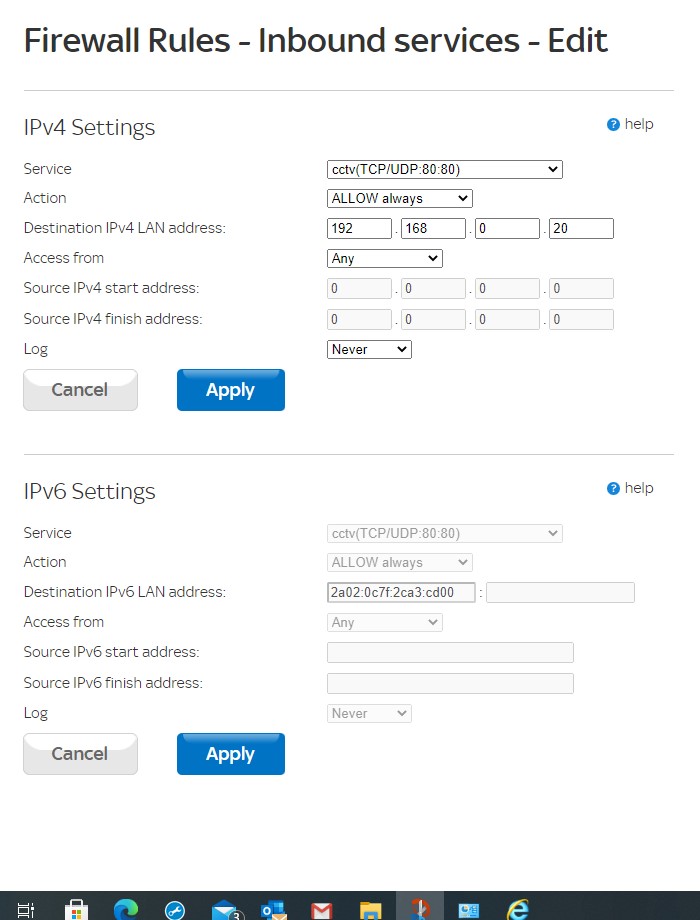

I seem to have hit a stumbling block after deleting the items not needed. This what I am getting at the moment when trying to get to where I need to be to enter the 50000 and 50002 figures
Apologies again for late reply, have been out all afternoon again.
OK. So first you want to edit that service called "cctv" so that instead of port 80:80 TCP/UDP it becomes port 50000:50002 TCP. You do that in the services page. The two images you put in your last message "router services" and "edit services" are where you edit that. If it gives you an error saying that the service is in use, you'll need to disable or possibly delete the firewall rule and add it back in again afterwards.
The firewall rule should be done in the IPv4 section - there should be no rule in the IPv6 section.
Sometimes it's easier just to delete the existing service and rule and then start again from scratch - service first, then rule.

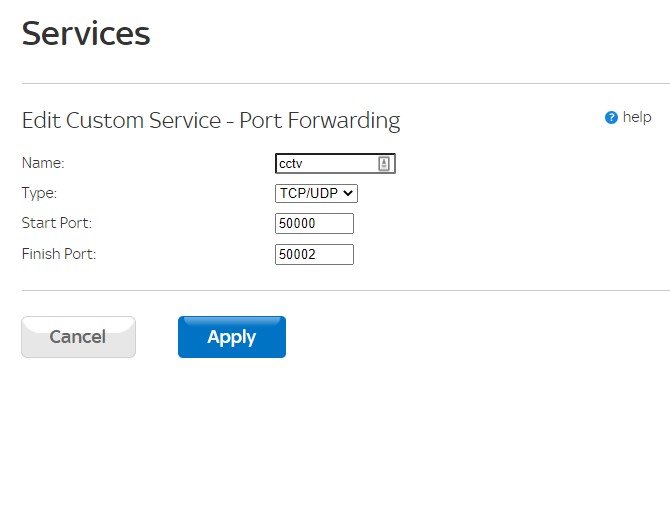

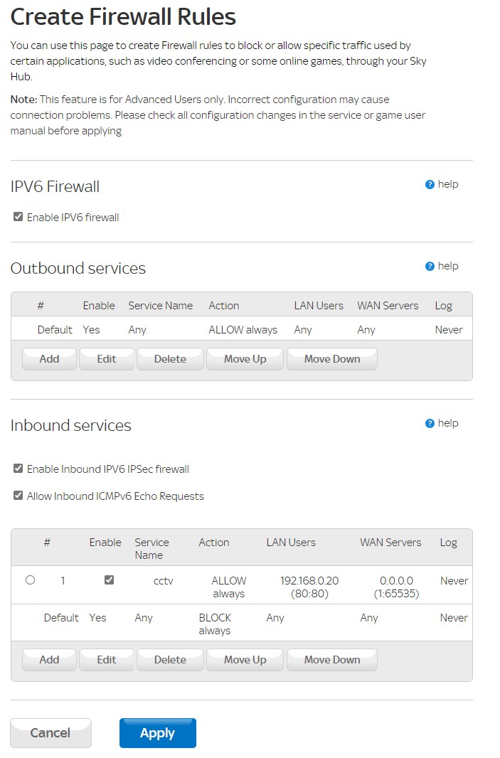

Do these look right to you now? Is there a procedure to test that they are working?
Thank you for being so patient, it's very much appreciated.
Yes they look correct. When you need to access the configuration of the NVR from now using a web browser on your network, you will use the address http://192.168.0.20:50000 (without the :50000 on the end your browser will assume you want to access the default http port 80 and fail to connect)
