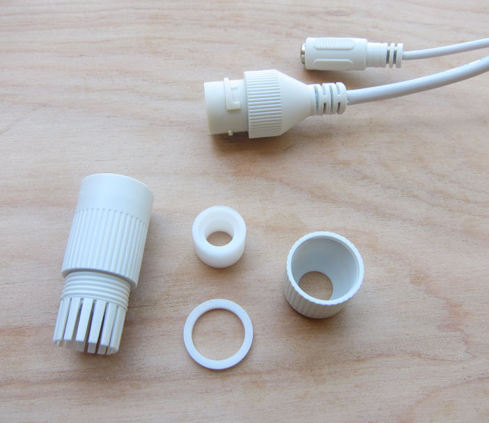

Have a look at this image which shows the likely "tail" on the cameras:
Plus the other end of the weatherproof connection make quite a bulky connection:
That cable and connection all has to sit somewhere. Even if the installer did manage to jam it behind the camera straight on the wall it would likely be exposed to the elements/water over time and fail. Which is why they are saying to use the junction box bases - it's better, easier and will likely last longer without failure.
