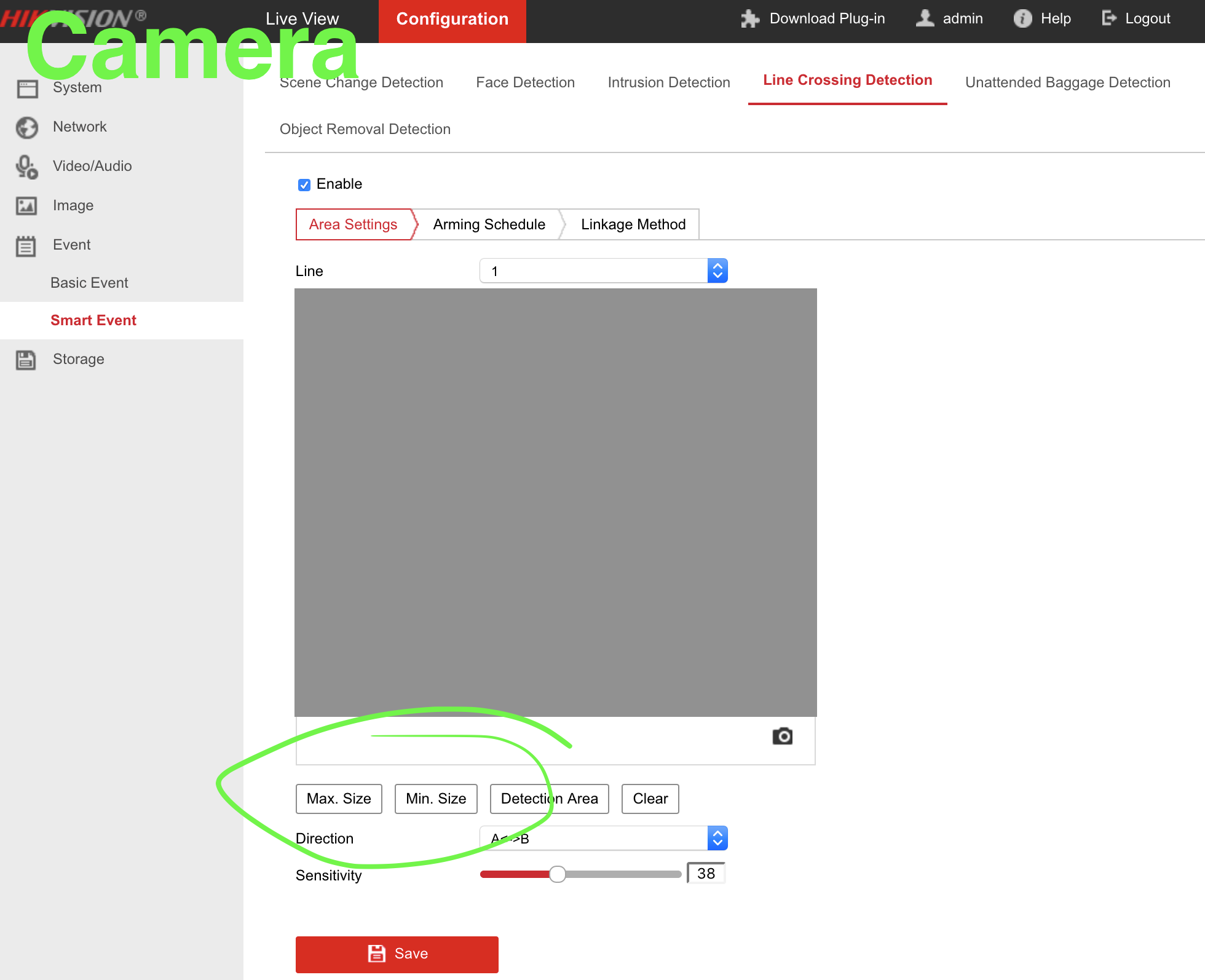

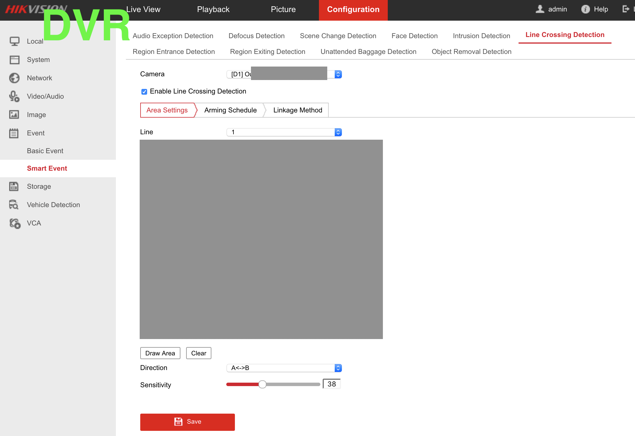

Here's a comparison of how Line-crossing detection config looks like on the DVR webui, vs on the same Camera's webui...
Someone else is going to have to chime in here because I've never seen that. Very strange. I wonder if it's a bug in the newest firmware for the K.

Interestingly, it appears that there's more options to configure in the Camera's line-crossing detection - e.g. Min and Max size, which can be pretty handy.

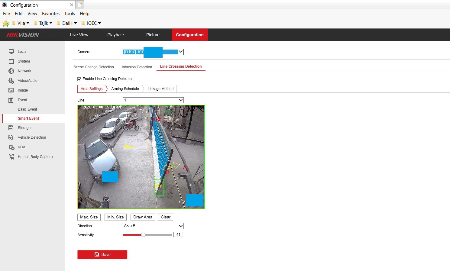

it is Odd that still you are missing this option as you can see in this picture bellow there is Min/Max size option in NVR Web GUI. please use Internet explorer and Press CTRL+F5 to clear caches befor login and test it again.
this picture taken from NVR (DS-96128NI-I16) F.W 4.1.65 (but i'm sure your Series should look like this!)
as already said that setting in Camera Web GUI is more accurate in new firmware in example you could use full screen drawing line or area in camera setting but cant do this in NVR GUI.
