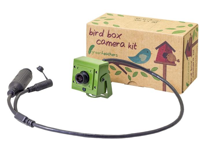

I'm hoping somebody can help. Last year I purchased an H264 IP mini bird box camera which successfully filmed nesting blue tits. A company that sells CCTV equipment offers hosting for various different cameras hosted the camera for me and therefore I was able to display the footage on a webpage. I want to be able to host the camera myself this year and have recently purchased a dynamic DNS. I know it's working because I am hosting a radio receiver that can be accessed publicly. So there's not much difference really, I just want people to be able to access this camera. I've created my account and have got an address but I just cannot work out how to get it onto a webpage. When I did it last year the company provided me with some HTML code which included a web address. I reached out to them in the hope they can offer some advice but they are just ignoring me, probably because I don't want them to host it this year. Any help would be appreciated

Thanks for the expedient replies. I'm afraid I don't really have much information regarding the model of the camera apart from what is listed in the information on the IP viewer that I use.
Camera name: H264
Model number: H13516EV100_50H20L_S38

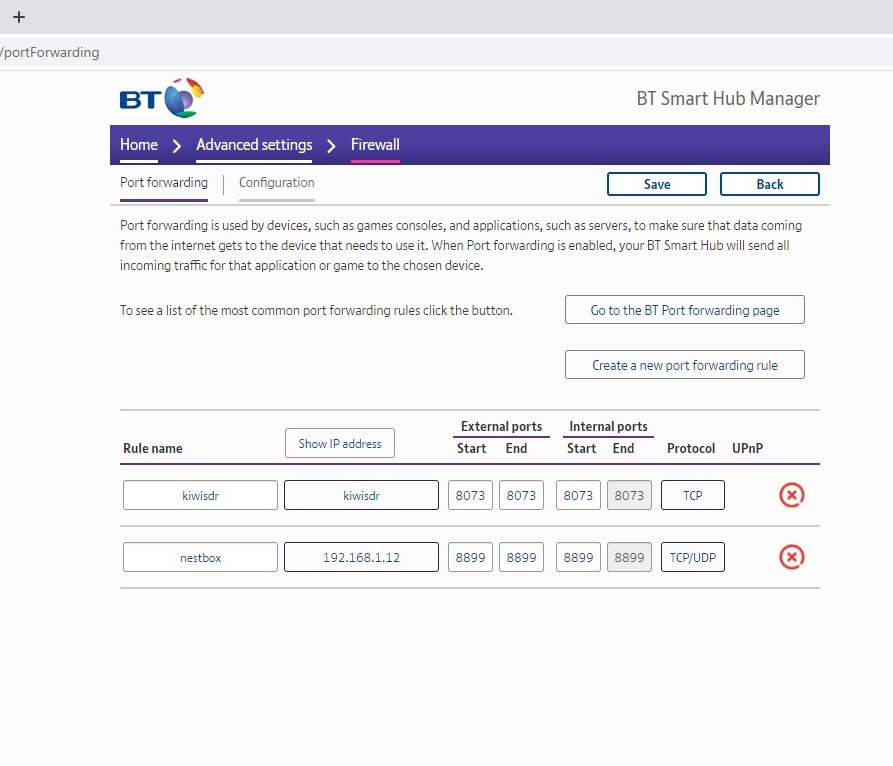

Angel cam is telling me that my ports are closed. I don't understand why, everything looks perfectly okay.
