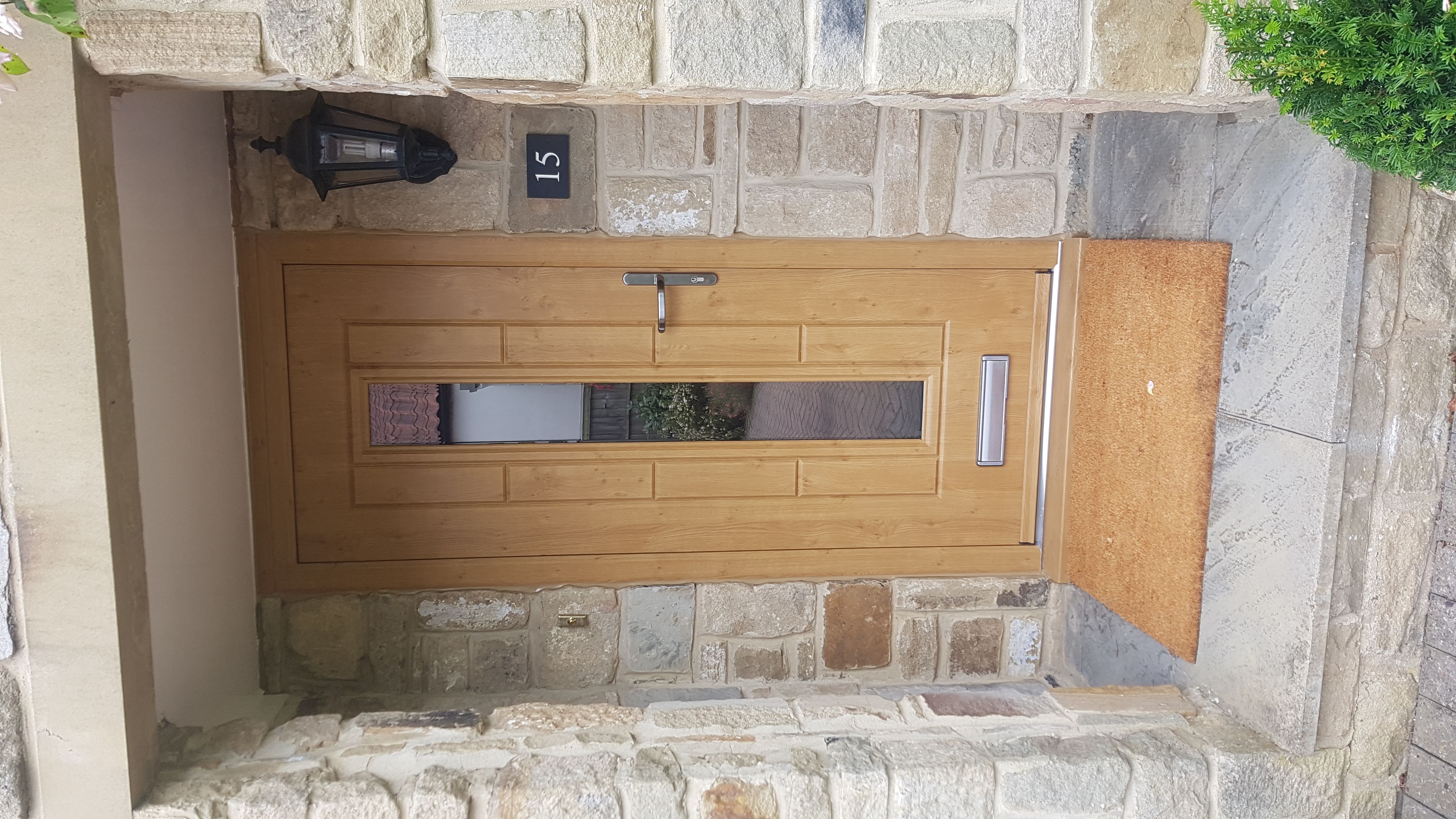

I've already installed 3 x DS-2CD2347G2-LSU/SL turret cameras around the outside of my home, connected to a DS-7609NI-I2/8P NVR. I'm now looking for a camera to use in a front door porch as a method of monitoring visitors and communicating with them when I'm away from home. Here's the porch:
Because of the light fitting on the right, I was thinking of installing the camera against the ceiling to the left of the door, in the corner, although maybe it should be centred above the door, although I'm not sure if that would then protrude below the top door frame, whereas the corner would be out of the way.
I did consider getting another DS-2CD2347G2-LSU/SL, but as this will be fixed to the ceiling of the porch and in very close proximity to the visitor, it would be very easy for it to be damaged. It is also quite large and I would prefer something a little smaller. Although the porch is open to the elements, the ceiling never gets wet, so I even wondered if an "internal" camera, which appear to be smaller, would suffice, but I haven't found any with 2 way audio.

I was planning to fit the camera in the top left corner of the porch ceiling, which is visible in the photo I took, however, it wouldn't be noticeable at all when walking upto the house as the drive entrance is to the left of the porch, so only when you reach the porch would you see the camera. If I were able to install a flush fitting ceiling mounted white speaker, I suspect this would blend in. I have some ceiling mounted speakers in the house and you don't really notice them.
There's a large void above the porch ceiling (the V of the roof), so I could potentially put an amp in there, and it may be possible to run a power cable from the porch to the garage, which is just to the left of the porch (this is the route the cat6 cable would take). Obviously, this is all additional expense has hassle as I incorrectly thought this dome camera included 2 way communication.
