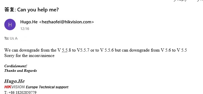

I recently updated the firmware on my G1 DS-2CD2025FWD-I from v5.5.83 to v5.6.0 build 190507. I'm trying to revert back to v5.5.83. I'm unable to do it via the webGUI (version mismatch error) or TFTP (completes transfer but never confirms update). Has anyone managed to downgrade successfully?

A YouTube search for ‘Hikvision v5.6.0’ provides several examples another user has encountered. They may be unique to his environment but not having the option to downgrade is concerning. To make matters worse, using Hikvision’s emergency firmware recovery tool (via TFTP) to load an older firmware can brick the device.
I’m hoping to hear from someone that has managed to downgrade successfully and how they accomplished it. I contacted Hikvision’s technical support but was told they were not aware of the issue and would get back to me. I’ll continue to experiment with different methods and post an update if I have any luck.
