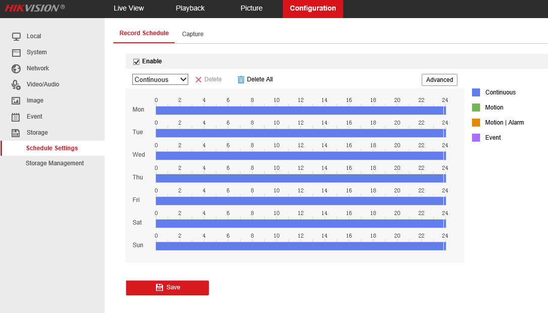

Are you able to access the webGUI of the camera? There are a few more steps required after installing a SD card into the camera. Try this - In the camera's webGUI goto: Configuration>Storage>Storage Management>HDD Management and format (initialise) the SD card. Then in Storage>Schedule Settings>Record Schedule check it's enabled and Continuous (blue) is set 24/7.
Ah thanks so much the penny has dropped for me, I had not accessed the camera GUI believing I could somehow access the settings via the NVR menus. I had to enable the Virtual Host facility from the NVR web GUI and then get to the camera GUI from the 'Camera Management' page. I can now see the camera SD card and follow your advice :) much appreciated.
