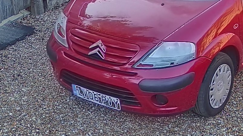

DS-2CD2386G2-IU Ghosting

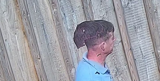

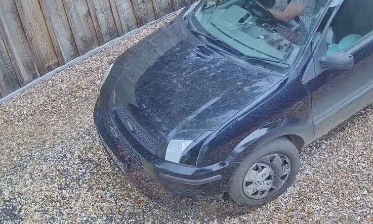

Hi Phil,
Thank you for the reply.
Its a high quality cable plugged into a Netgear GS110TP (using POE), its not displaying any dropped packets and i changed the port its plugged into with no effect, i had a DS-2CD2085FWD-I on the same cables ect before this camera and it was fine, i suspect the camera is faulty.
Just a note its fine at night not sure if that means anything?
I can try another cable but i suspect it will be the same. The other two DS-2CD2386G2-IU look fine but do not cover where car would go so its not easy to compare or easy to swap them around.
Unless you can think of anything else to try?
Regards, Dave.
