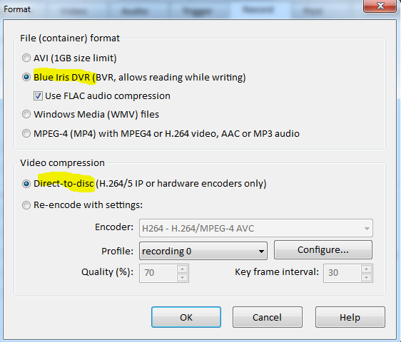

Is this what you wanted to see?

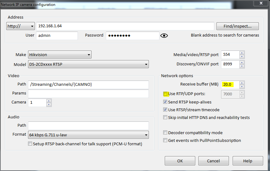

Yes, that helps. Matching the Frame Rate and I Frame rate is important. Have you increased your Receive Buffer and disabled RTP/UDP ports.
2208
What are your settings here?
2209

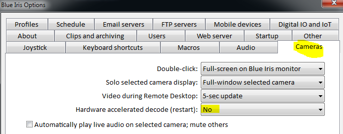

Try disabling Hardware accelerated decode.
2210

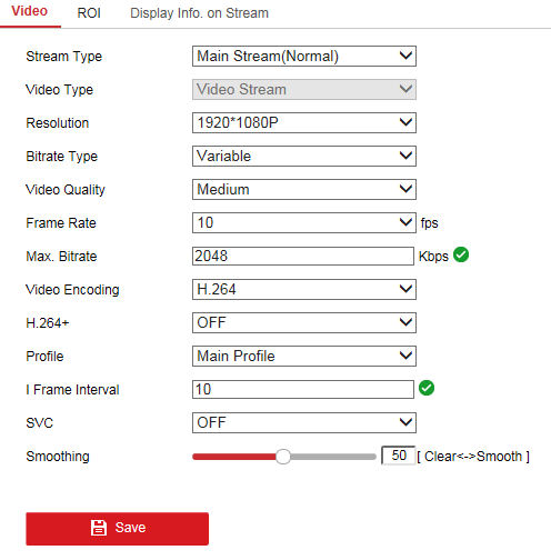

On the camera:
Set the Bitrate Type to Variable
Set bitrate to 2048
Lower the Frame and the I Frame Interval to 10
2237

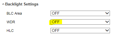

Under Configuration>Image, turn off all the BackLight settings. WDR mainly, but disable BLC and HLC if your camera supports those settings.
2238

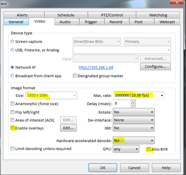

Then match the new settings in BlueIris under the camera properties.
Size and max rate match the cameras resolution and frame rate.
Hardware accelerated decode NO
Enable Overlays unticked (it has to re-encode the frames if enabled)
BVR unticked
Limit Decoding unticked
2239
