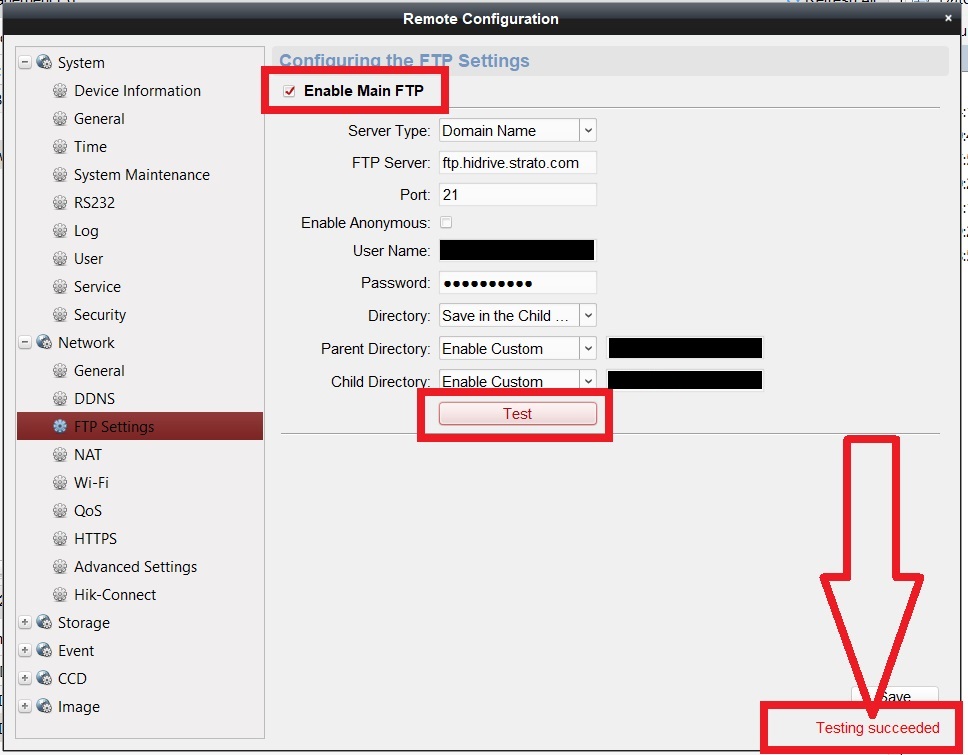

I need help with my new DS-2CV2Q21FD-IW (FW 5.4.4. build 170210) -the camera does not send alarmphotos to my FTP-webspace :-/

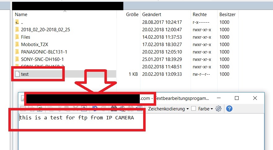

AA: The FTP config was done, FTP activated, saved, tested-->the testfile was created on the FTP-server.

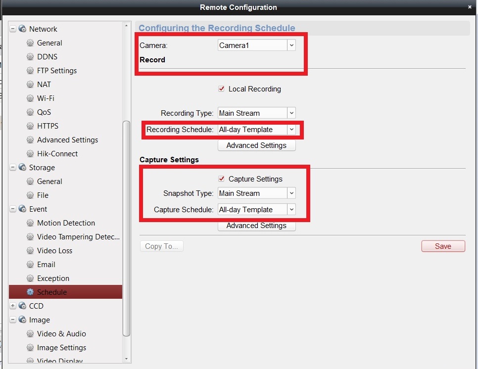

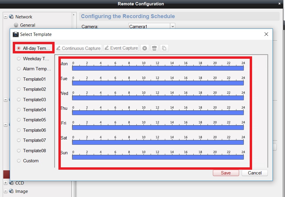

BB: timesetup and areasetup performed, activated, saved

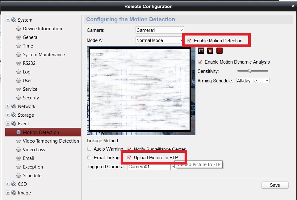

CC: but no file was created on the server during an event.
When I activate "send by email" this function works fine, also sending to HIKconnect
