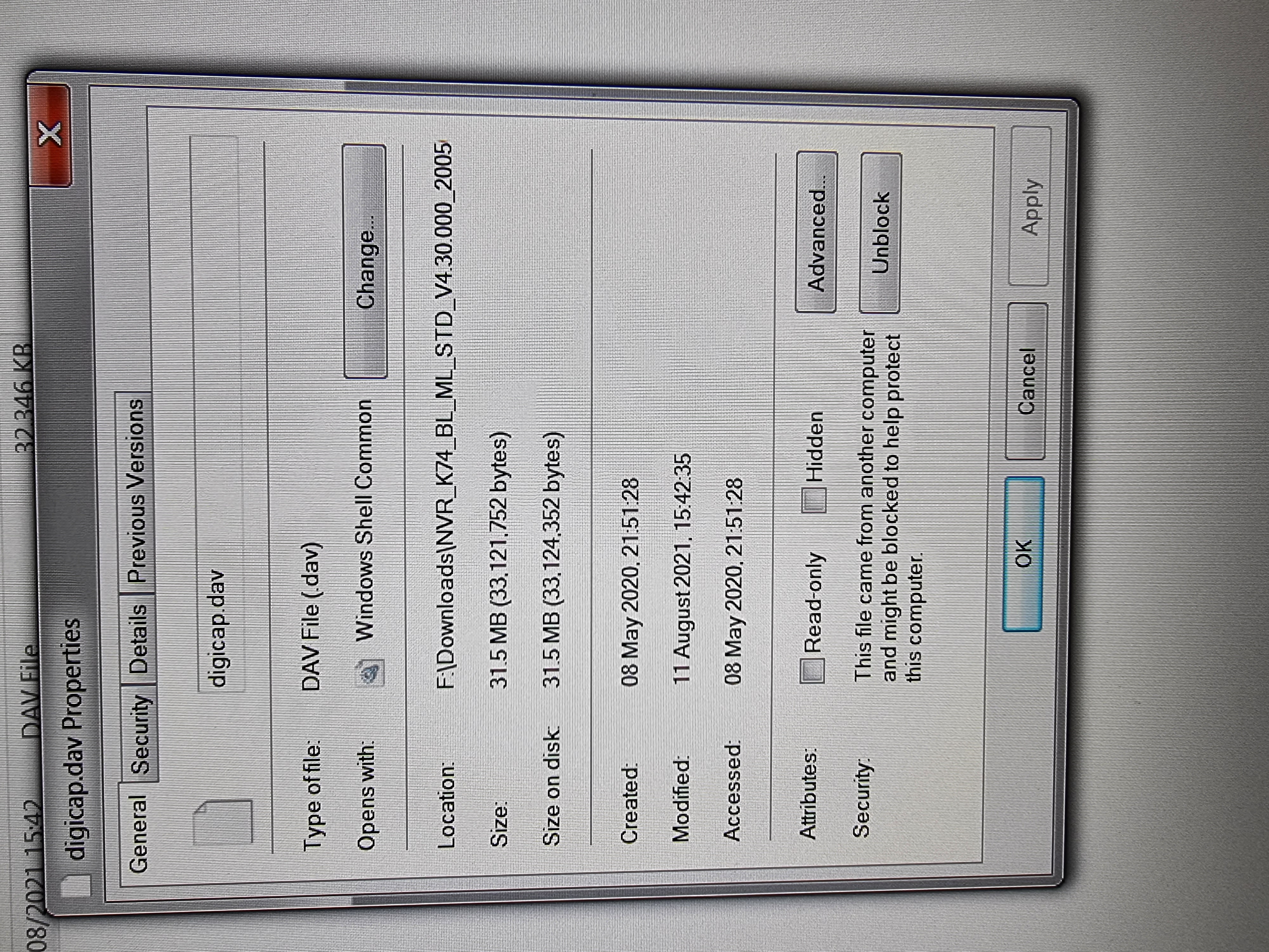

I've just tried it, failed.
Plugged the USB in, clicked upgrade, clicked on the file, it said it will reboot which it did. When it came back on it is still showing the old firmware V3.4.100
I unzipped the file, what do you mean by update it with the digital.dav file?
I can't access through a browser.
When you unzip the file it should reveal a digicap.dav firmware file like the one below:
Ok, when updating via the USB are you making sure to use the 31.5MB file? sometimes there is a ghost file that is much smaller and that won't work.
If you are sure you are loading the correct file then you may need to try an older firmware first - v3.4.112 - then go to v4.30.000 before updating to the latest version.
