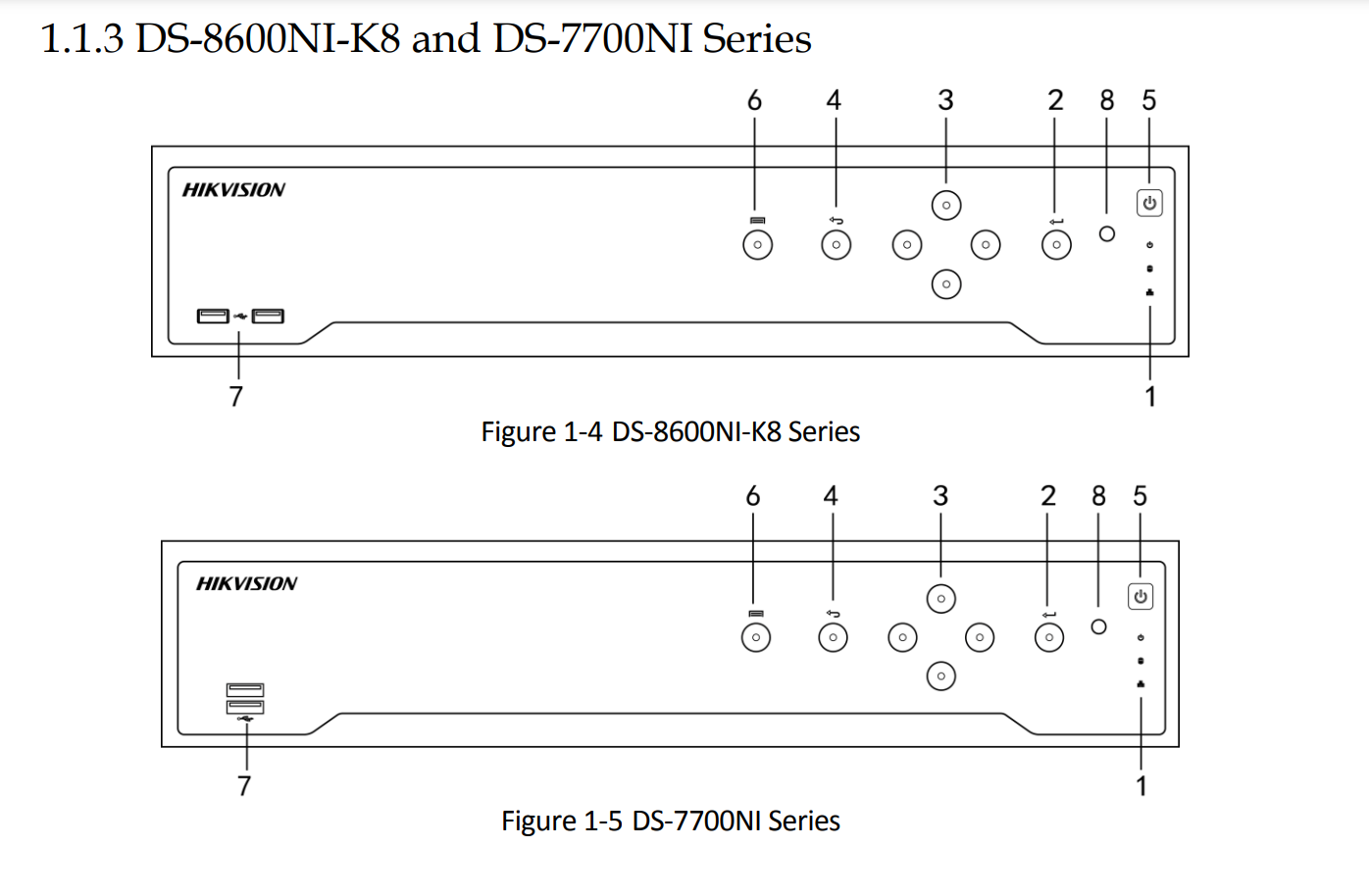

1. I cannot find in the manuals online or documentation what all the iluminated buttons and lights on the front of it do. While I don't ever really plan to touch it physically and will access it almost exclusively remotely, it would be nice to know what they're for.

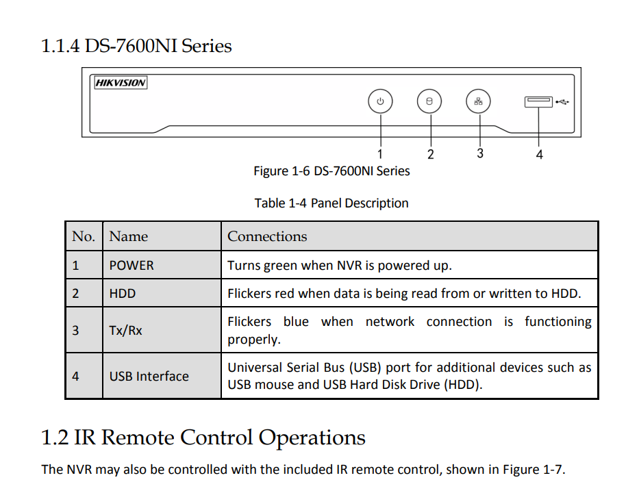

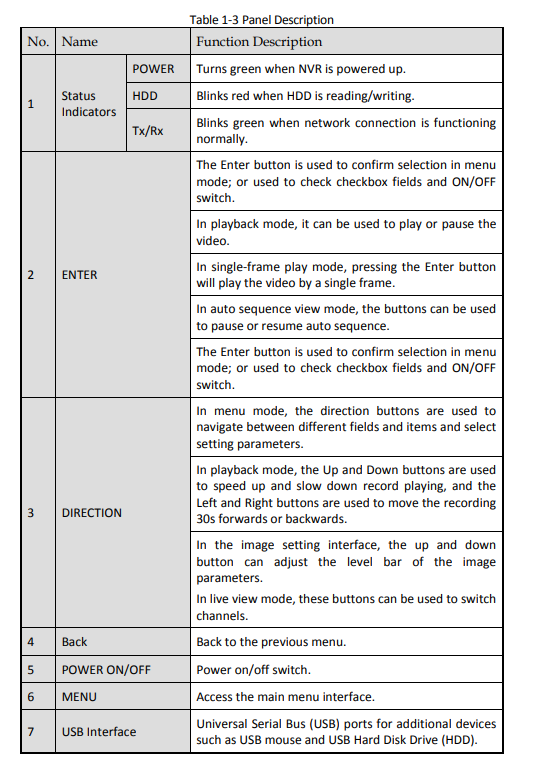

So, the buttons do actually work.
We've checked on a DS-7716NI-I4/16P here, and you can use them to somewhat navigate between the menus on the local GUI, and flick between pages on the live view screen.
However, it isn't the most intuitive way of doing this, so it is probably best to just use a mouse to navigate the local GUI.
Here are the screenshots from an early K-Series user manual that Hikvision has sent me explaining what the buttons do:
