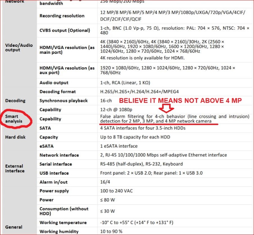

Looking at the data sheet of the NVR says for "smart analysis......

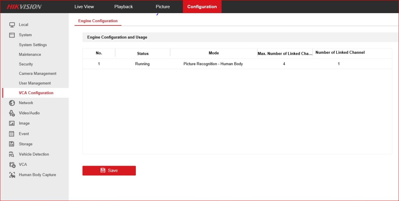

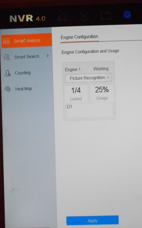

Smart analysis algorithm now is set for 1 (out of 4) channel with 2021G1 cam, as we can see at NVR UI
and Web UI

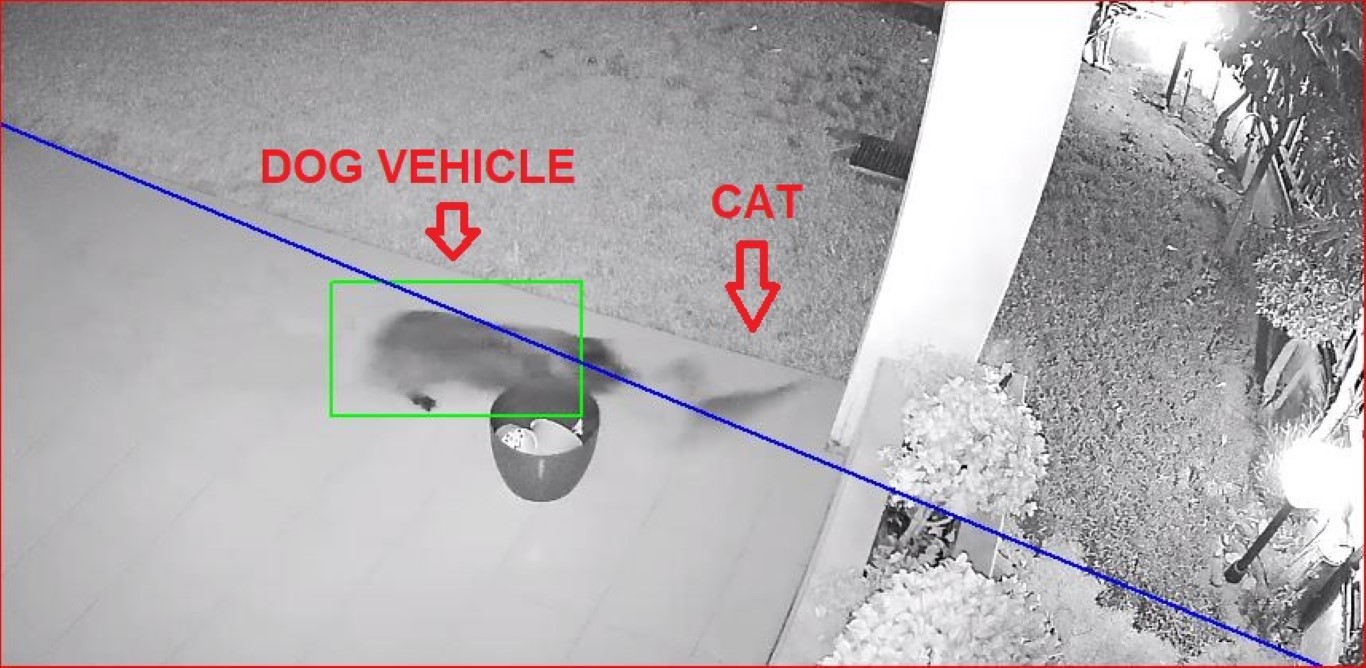

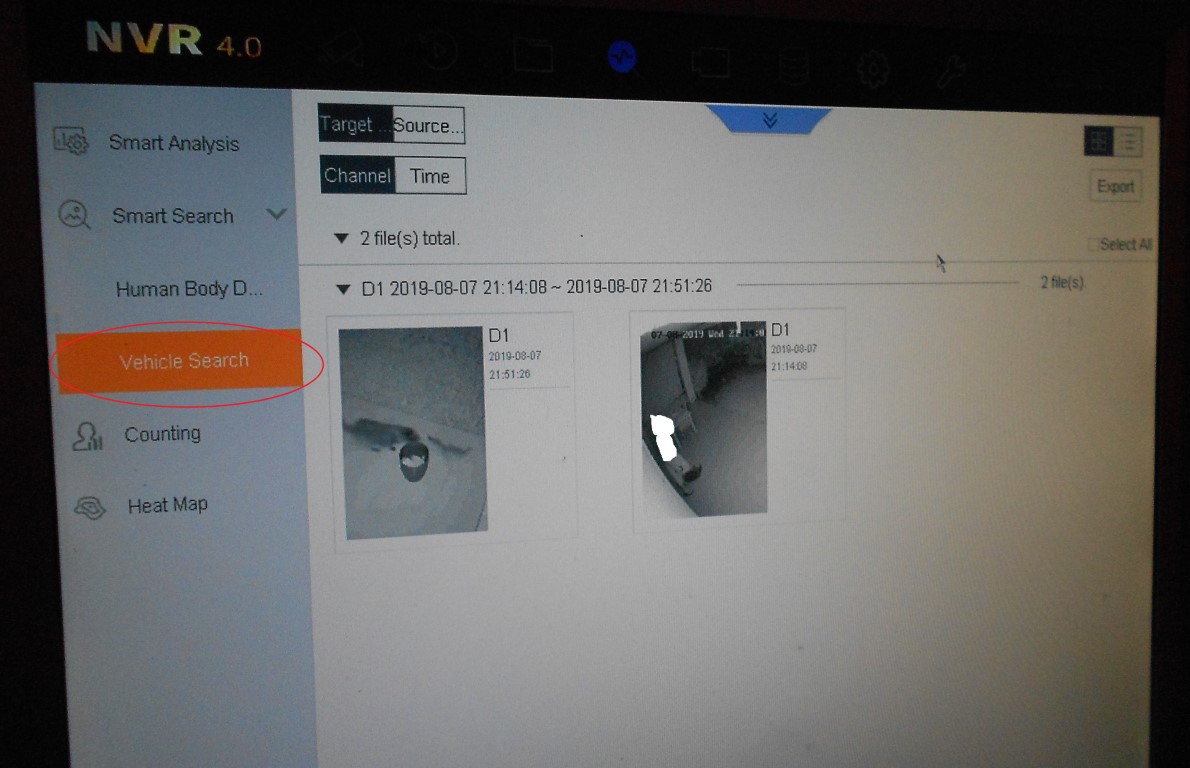

About the "dog-vehicle case", it is more than possible, created from 2021G1 cam.
As you can see it is night with cameras EXIR on. I must have what you call "ghosting", on fast moving objects, which I can't solve,
even if i tried change thinks like noise reduction (need help here too, please).

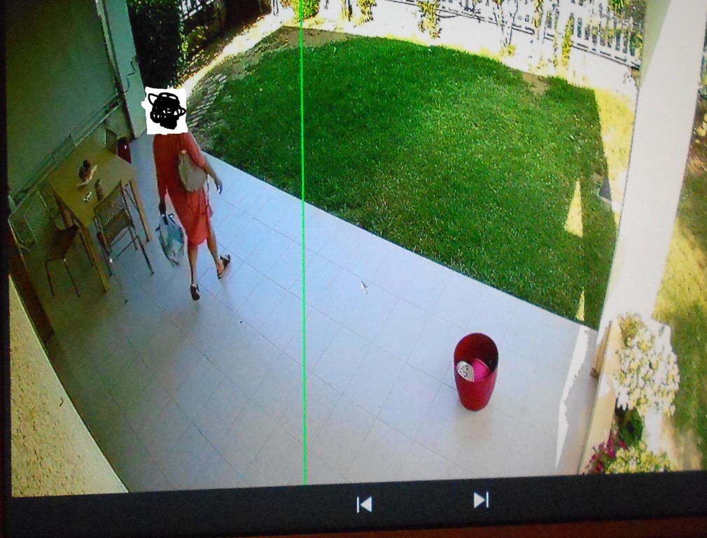

Lets see second case, mentioned above.

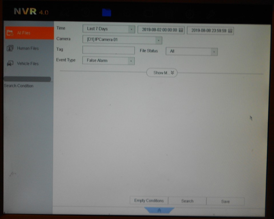

On NVR found only one picture under, All Files -> False Alarm.

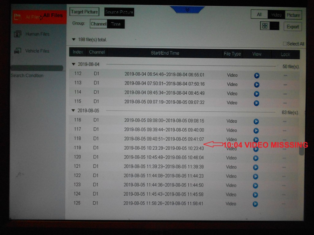

No video at NVR -> All Files -> Video,

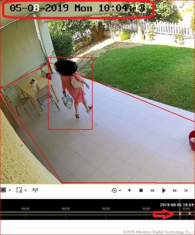

But, on NVR Web Interface -> Playback, an event video was recorded (?????).

I think it is not possible the NVR Web UI shows a video only recorded on Cam Storage Card.
The storage card is very small for testing (16 Gb) and all videos of 5/8 on it, are deleted (overwritten).

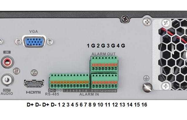

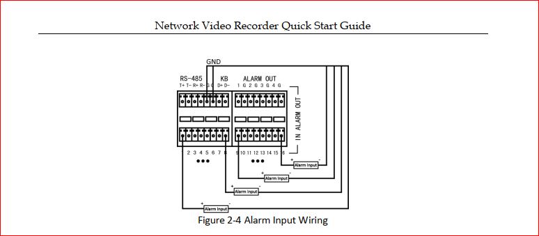

Now I have another question for you, because I want to connect an alarm in and Hikvision user manual are wrong about this.
At the Quick Start Guide came inside NVRs CD, shows the alarm I/O terminals like this:
but in reality NVR terminal are like that:
No G G terminals, but only D+/D-/D+/D-/1/2/3........15/16.
Where to connect the wire for alarm input?????
Should I connect it to ground bolt next to the green terminals?
