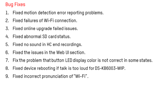

What firmware is the KB6003 running? V1.4.62 Build 180515 mentions Wi-Fi bug fixes. If it's on the latest firmware then my best guess would be channel interference.

Hi, the firmware is V2.1.0 which I received from hikvision via the retailers support site.
