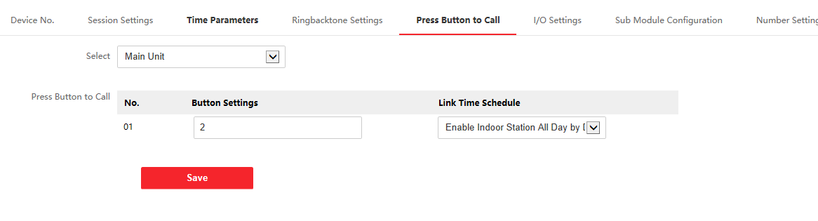

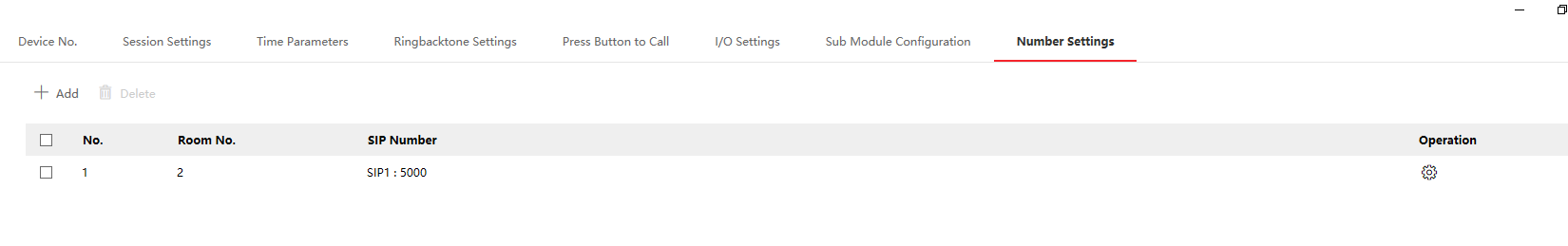

In the intercom settings, press number to call, there is default '1' , just change that to a number 2 for example, then on the other tab, there you can add sip numbers... Add number 2 there with a corresponding SIP number

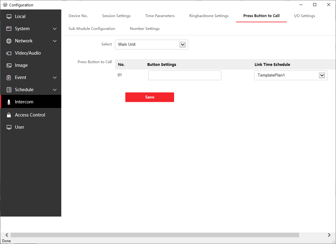

I'm unable to save anything here:
I always get "Save failed" which is not very helpful. What format does the "Button Settings" field expect?
strange, i can save here perfectly
for instance:
perfect :)

its also possible to add more sip numbers , if you have a keypad on the ds-kd8003 , you can call those numbers with pressing like
#2 or #3 .....
