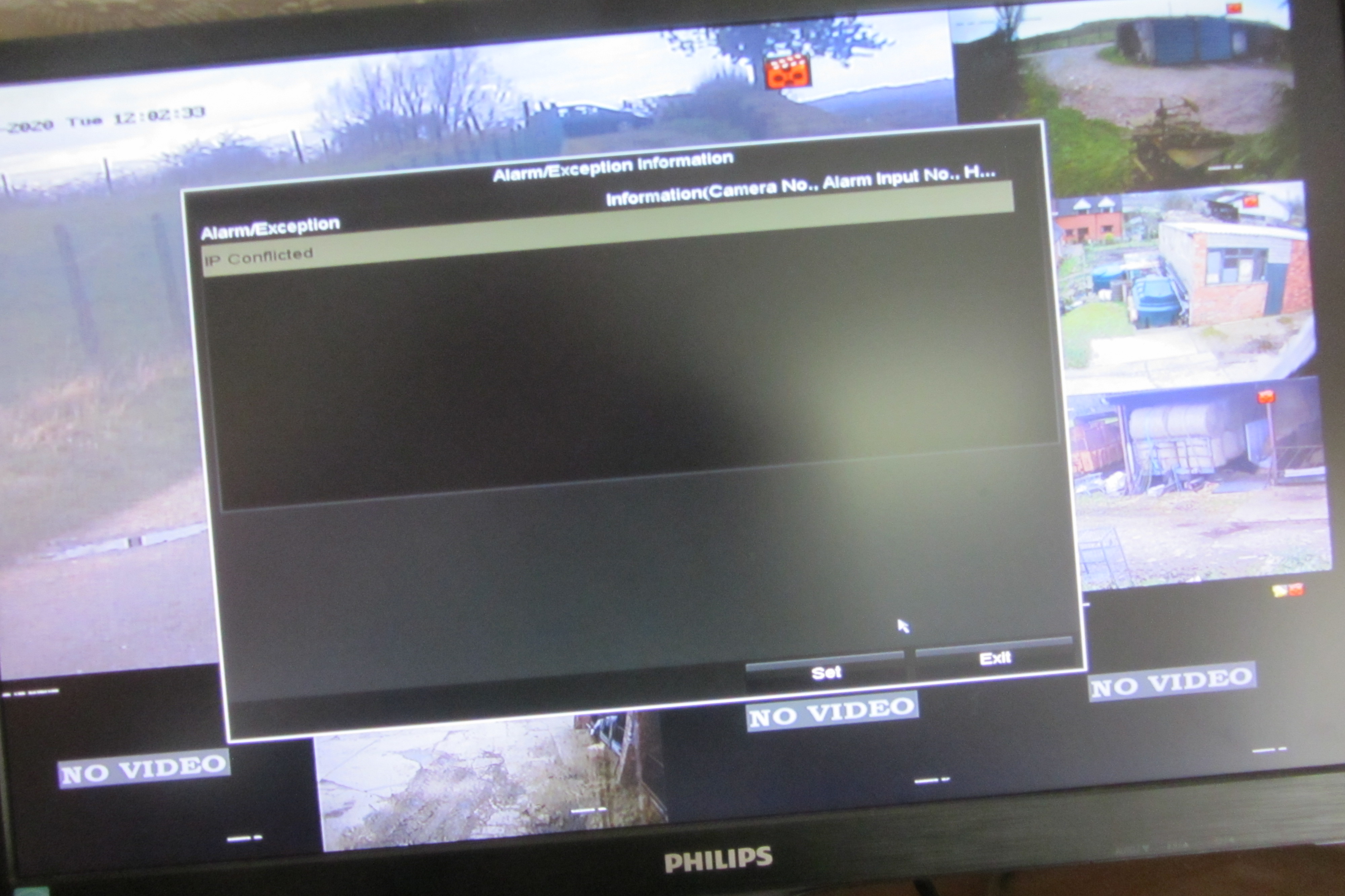

First two apologias: it is a DVR not NVR, and for the delay in replying.Hi,

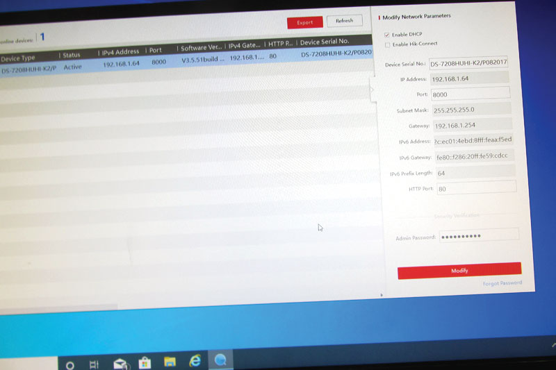

What NVR model do you have?
Do you have access to a PC or Mac running Hikvision's SADP Tool? SADP(for Mac) / SADP(for PC)
Run SADP and see / share the results table.
Your reboot has very likely caused the DVR to pick-up an IP address which is already in use by another device on the network.
You can use SADP to turn DHCP on, which should enable the router to issue a new valid IP address to your DVR.
Then, as per @Kyle Mc post here reset DHCP to off, to fix the IP address.
