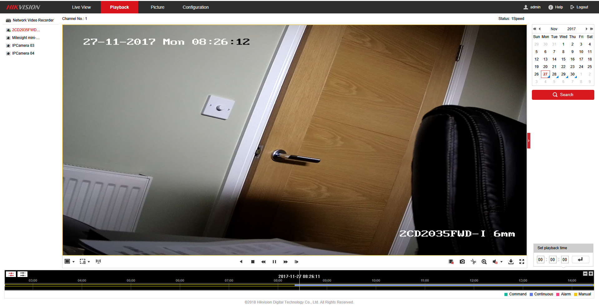

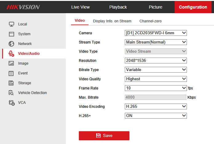

We have a 3MP camera running on a 7604 NVR with a 4TB HDD installed.
The camera is being recorded at Highest Quality and 10fps.
When I check today (15th January 2019) I can still access and play back recordings made on November 27th 2017 - 414 days!
