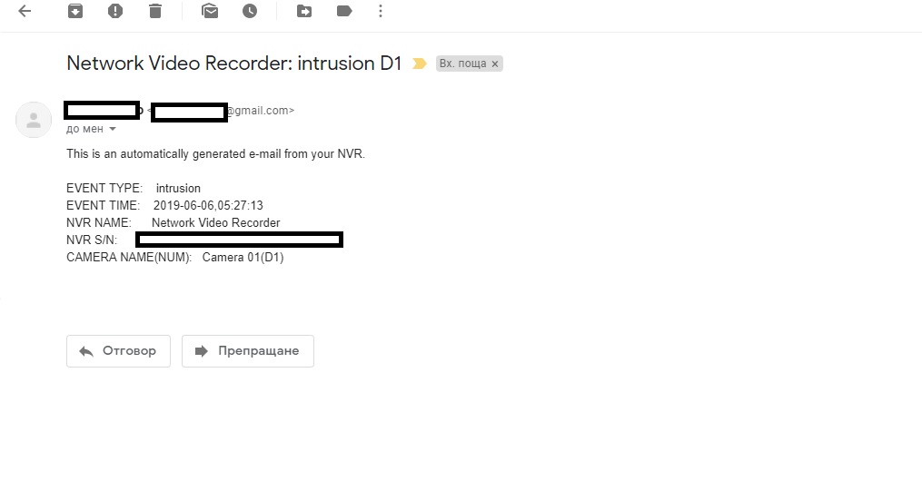

I am using gmail. There is only event information.

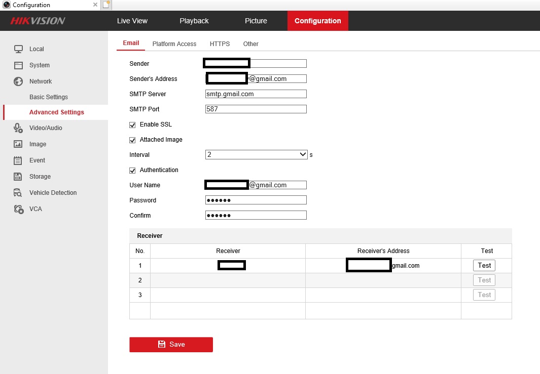

I have attached pic from my email settings and pic from email that i have recently received

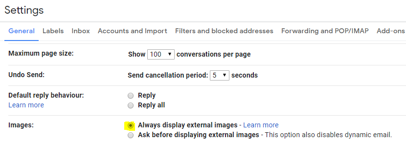

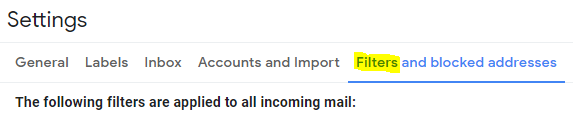

In your Gmail settings are images set to always display? Do you have any filters setup the may be blocking the attachments?

Sorry for my late reply. I don't have any filters. The email, received from NVR is image free. It contains only NVR SN, Date, Time, Event and Camera No. There is no attached image

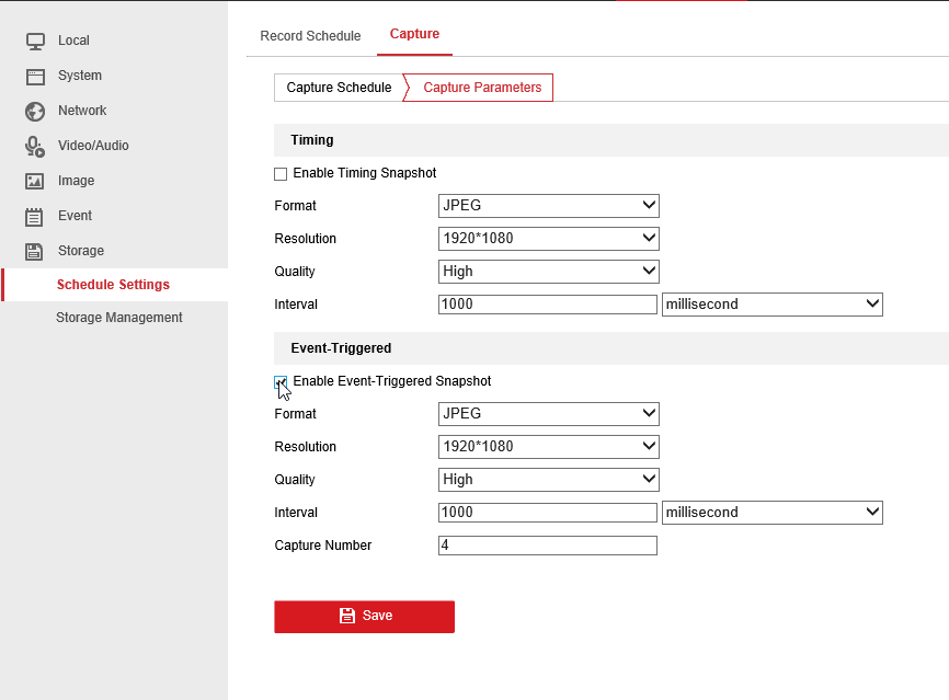

I belive that if you enable this Event-trigger snapshot you will recive image on your e-mail. And Capture schedule must be 0-24.
