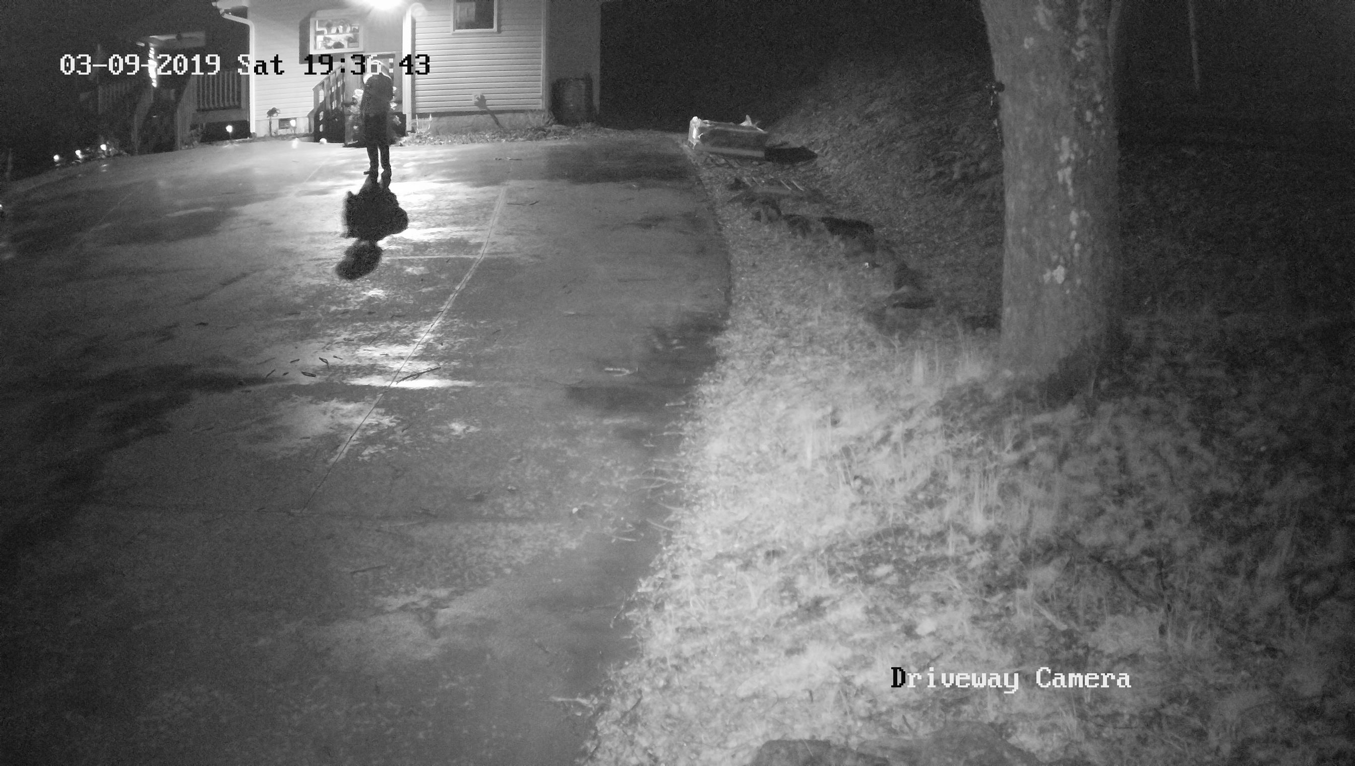

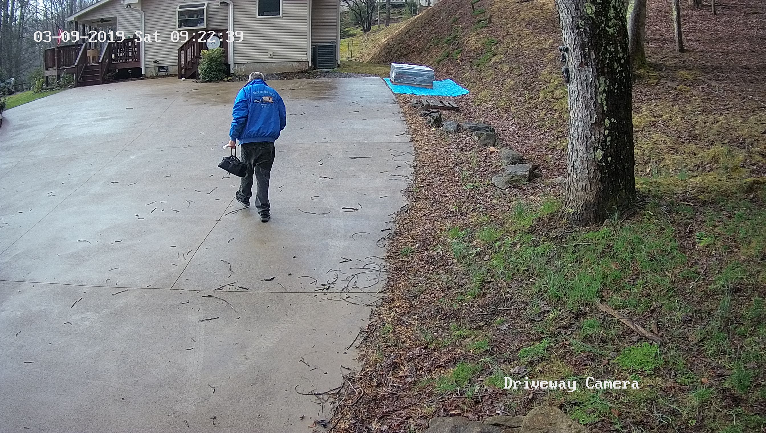

Greetings from USA. Though I had camera working POE for a couple months on a desk in the house, there were enough issues (Winter, primarily) to avoid the install. Camera is ~200’ away, through two patchfields. Prior to permanent install I ran it hand held outside garage, verifying that it would work this far away, and testing to make sure Image wouldn’t be shooting the LED Motion detect floodlight on the house. It worked, and Image was fine, so when weather broke did the install.
Nosy for future installs. What is the theoretical limit of POE camera on CAT6 cable??
Thanks for your great suggestions and help! Both cams are HiKvision DS 2CD2042WD-1 with V5.53 Build 180730.
Pix ftp, stream converted to 1080/29.97fps Video in Synology Surveillance Station.
