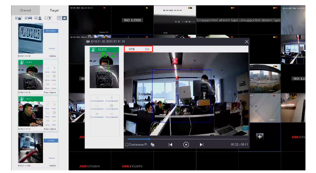

a other question is that i have a DS-7716NI-I4 running firmware V4.50.000_210125 and the problem is that the local alarm linkage dont work!!
i have 2 anpr camera's and 4 cameras with face detection (not face recon).
vca is enabled, but i cant get it to work. i tried al kind of options but no succes.
anpr is working and face detection is also working but the local gui dont get a trigger on the anpr or face capture.
the image below i just an example of what i want to see in local gui.
thanks for the info.

In regards to the GUI onscreen pop-ups, have you ticked "Full Screen Monitoring" in the Linkage action for the face detection smart event?
