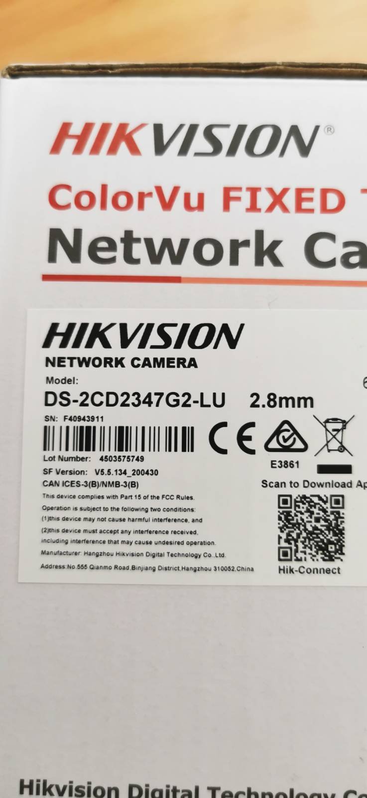

Hi
I have just bought the DS-2CD2347G2-LU and would like to upgrade the firmware on this camera, Can anyone point me to the correct location, Every firmware file I download wont work with this camera when in fact the pages I visit say it does, I get the following error when I try to upgrade "The type of upgrade file mismatches".
I currently have Firmware: V5.5.134 build 200430 installed out of the box, I'm hoping the update will provide RTMP but not sure if that is supported for this camera yet, I tried installing the firmware that Dave over at DVS was talking about in the YouTube video but that didn't work either.

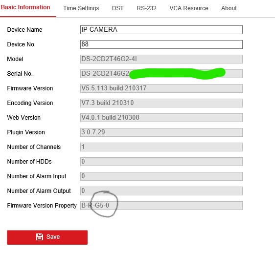

I bought 2 new DS-2CD2T46G2-4I (C) Acusense cameras recently and figured out that they have a new firmware. It is labelled as G5 and the G3 version will report the error of file mismatch. The version that is patched is V5.5.114 and works on the G5 type cameras. They have a (C) behind the model name on the box.
The new Colorvu series might also be using this firmware.
I find that the G5 cameras are way inferior to the G3 5.5.160 when it comes to filtering out false alarms.

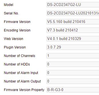

@JB1970 The generation of this camera is a G2 product but you mention G1 when I look at the supported models on the G1 page my camera isnt listed ?

Your original post asked about updating a DS-2CD2347G1 but your screen shot shows a DS-2CD2347G2 - which camera do you have? If the screenshot in post #12 is from your camera then it's a G3 platform camera and you already have the latest firmware loaded.

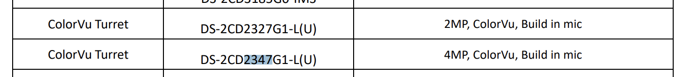

@Paul2021 The DS-2CD2347G1-L(U) is on the G1 release notes of the page you linked above, see screenshot below:

i have the DS-2CD2347G2 Dan, but im also confused as the screen shot i provided shows B-R-G3-0 I would assume this means G3
Most models ending G2 in the part code are G3 platform (thank Hikvision for confusing us all with that one)
The models ending G1 in the part code are G1 platform
