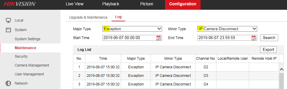

What I have noted is that the 2 cameras with the issue are rebooting simultaneously. I have video loss email alerts set up and both cameras are dropping at the same time. 5 reboots since midnight. The motion detection is back enabled after reboot.

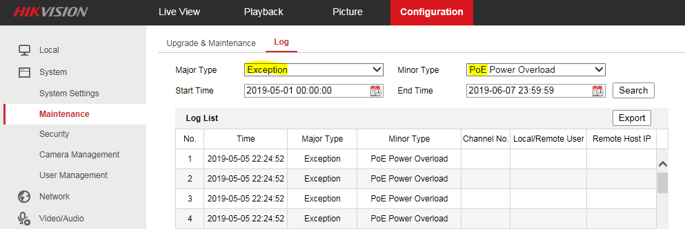

Check the logs on the NVR. Any PoE Overload entries around when the cameras rebooted?

Thanks for the suggestion Stewart.
I am seeing a PoE power supply exception every hour.
The IP camera disconnects (with one exception (10 minutes ago), which were occurring in the log at 10 to 20 a day have stopped, coinciding with applying the .005 patch to v4.21 NVR software.
I will check again tonight when IR turns on, but PoE consumption is 18W with 102W available.
The only other anomaly I have noticed is that D2 camera, the feed for which is delivered via Devolo Ethernet over Power adapters is that it is showing as "port short circuit". If I disable PoE bonding on this camera then the camera goes off line. It is as if PoE bonding rather than just disabling PoE, is actually disabling the camera.
