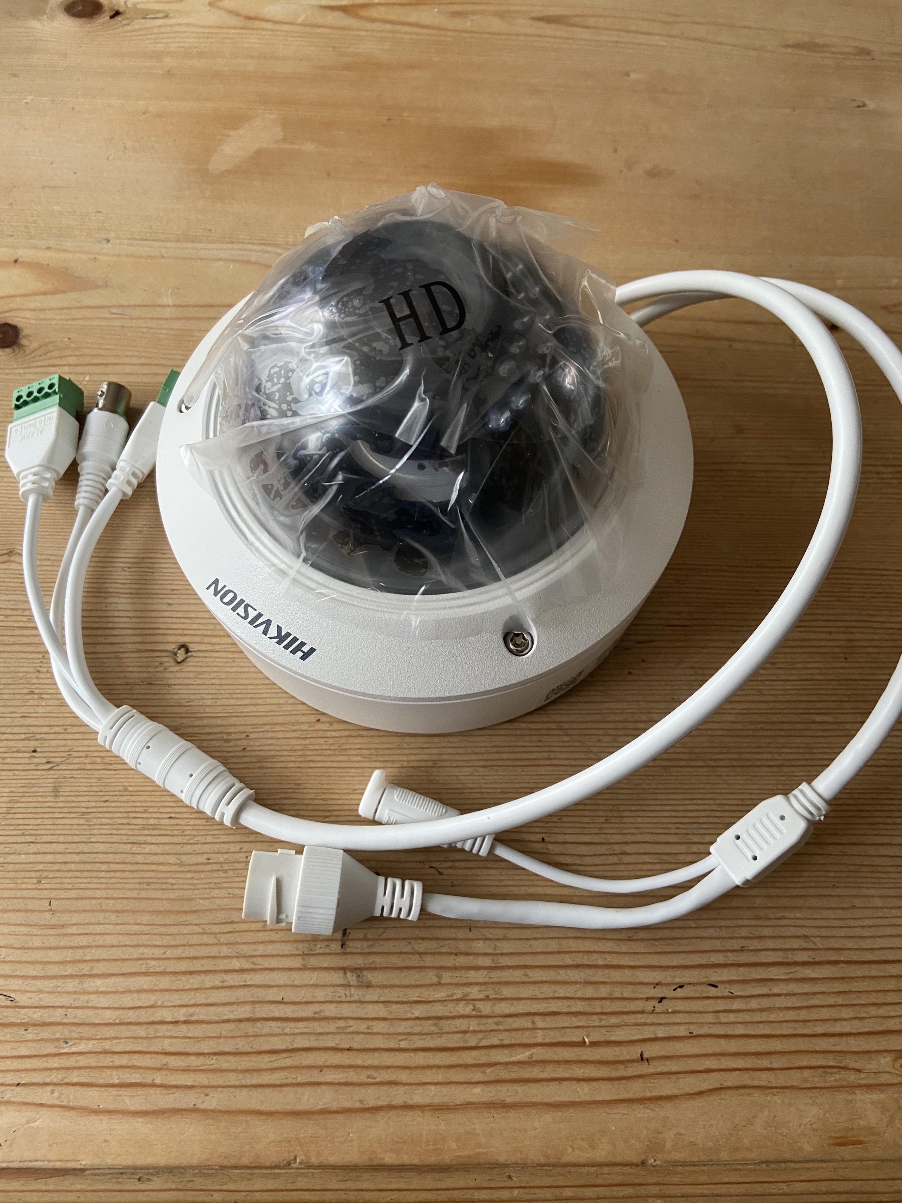

The cameras I'm going to install are a mixture of DS-2CD2722FWD-IZS, DS-2CD2742FWD-IZS and DS-2CD2H43G0-IZS.
This is the one of the 2722's:

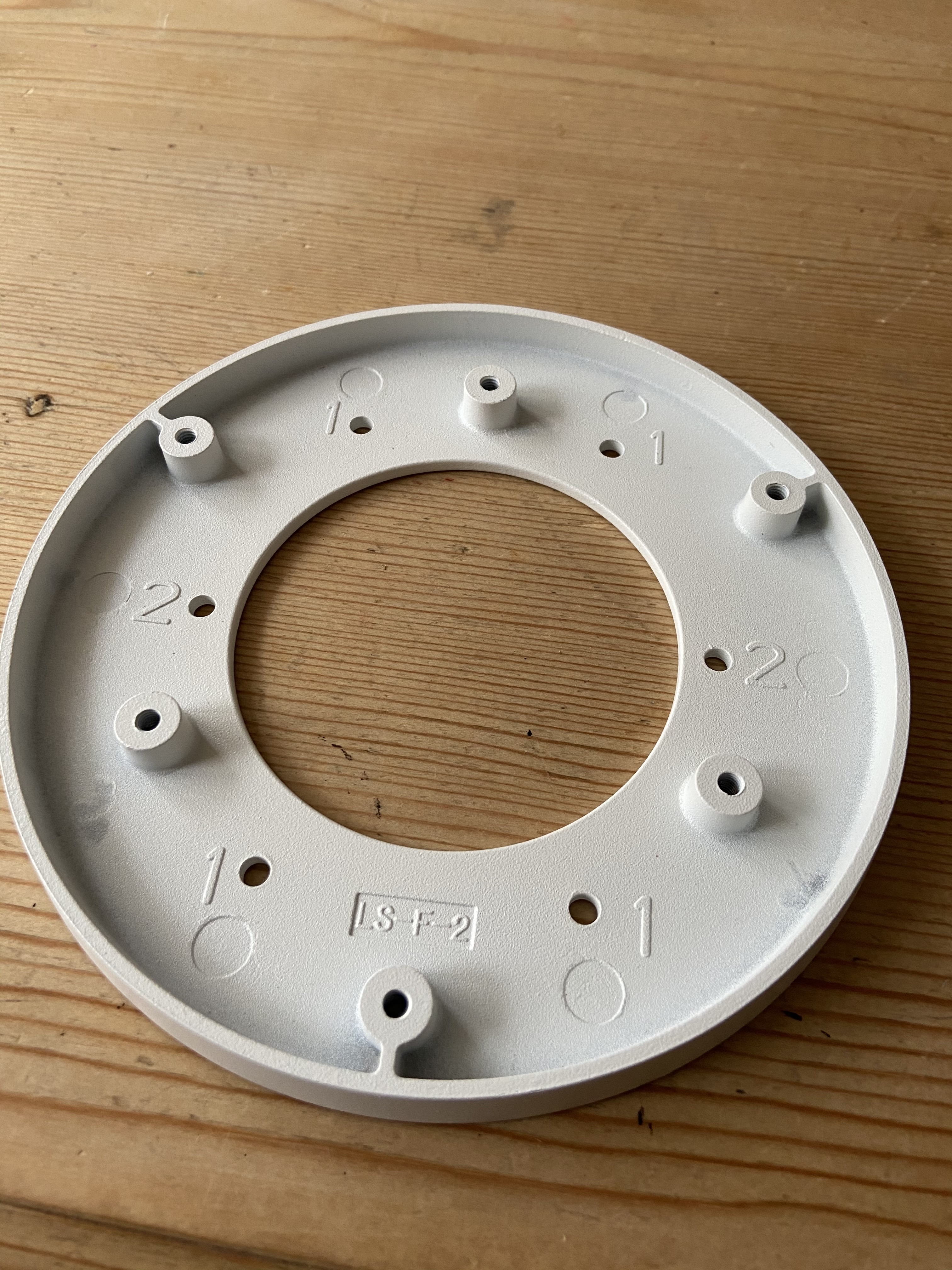

The boxes containing the 2722 and 2742 cameras also include a mounting plate shown below:

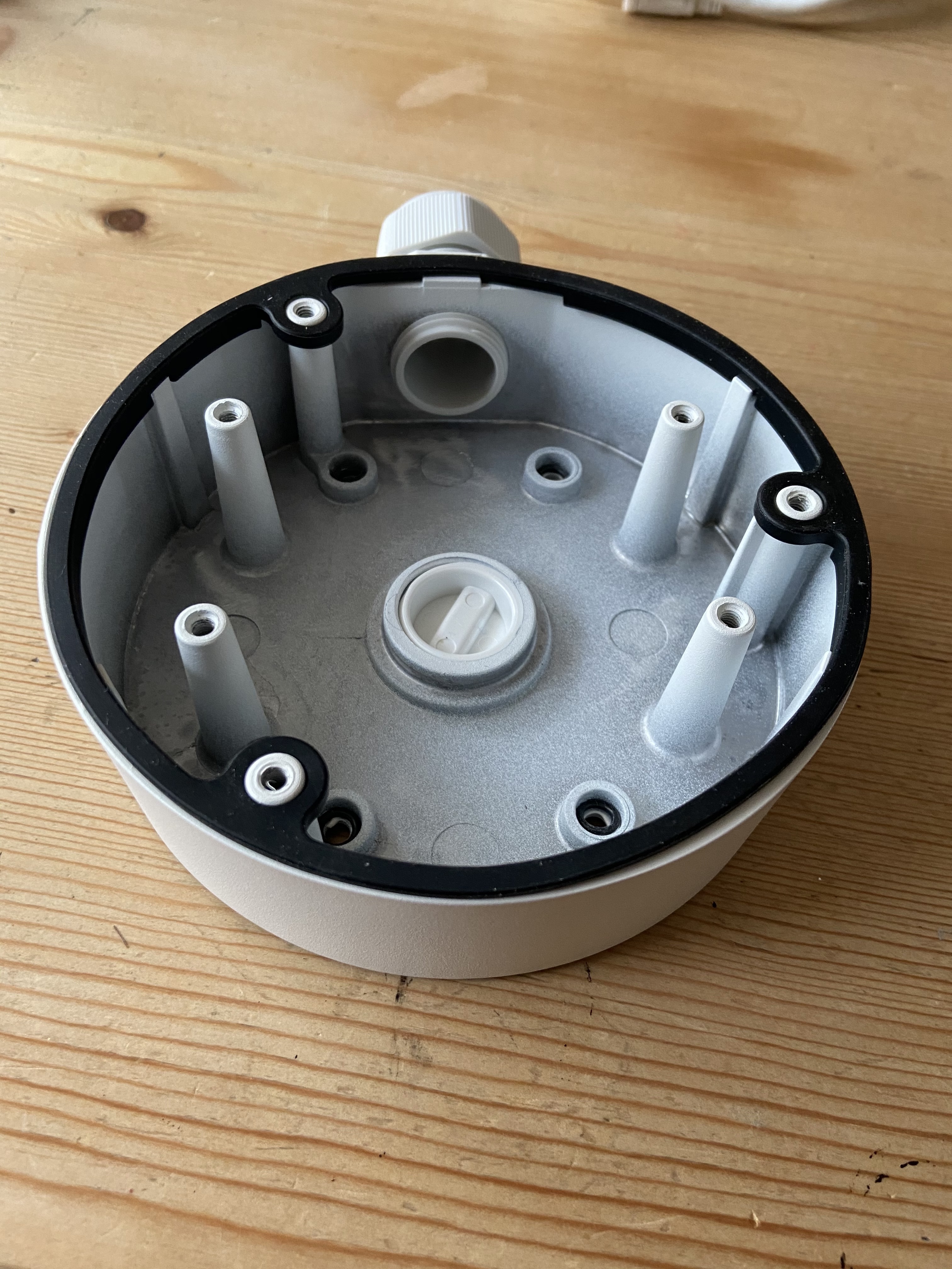

I will be using the following junction boxes for the 2722 and 2742 cameras:
So, do I install the camera directly to the junction box, or do I first need to fix the camera to the mounting plate and then fix it to the junction box.
From a purely installation perspective both options can work.

Hi Richard,
The 27x5 Domes that replaced this model have a similar mounting place which isn't required if mounting to a junction box, so the case is probably the same here. They are only needed if mounting directly to the wall without a junction box or onto certain brackets.
If the camera mounting screw holes line up with those on the junction box then there should be no issue, the rubber seal on the box should give the sufficient weatherproofing.

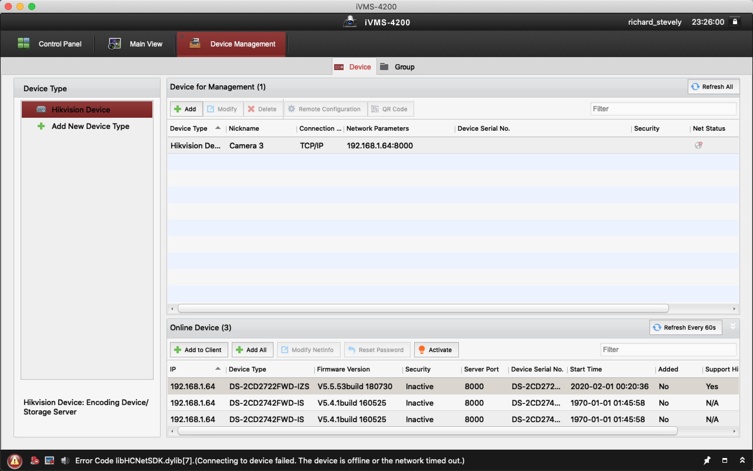

Cameras installed, everything switched on and IVMS-4200 for mac downloaded.
Problem 1.
When I connected the system to the router and turned the HIK POE switch on I noticed that the lights (green and orange) on the switch came on for only 3 out of the 4 cameras. Am i right in presuming there must be a hardware problem for the camera where the lights didn't come on. Tomorrow I'll check the connections at the camera and switch, as well as testing the patch cable itself, but is there anything else I should look out for?
Problem 2
On the Device Management tab on the IVMS-4200 software only 3 of the four cameras can be found (I presume this relates to Problem 1)
Problem 3
Before trying to "ADD" the three cameras I noticed they all show the same IP address - (192.168.1.64) - is this correct?
Problem 4
Because all three have the same IP I can only manage to add one of them. When I try a different camera, with the same IP, an error message comes up with error code 108 and says "device already installed"
Problem 5
All cameras are shown as inactive and I can't seem to activate them.
Problem 6
An error code 7 comes up every time IVMS-4200 refreshes and says "Connecting to device failed. The device is offline or the network timed out.
This is my screen:
Wife keeps saying "I told you none of them will work" so any advice would be greatly appreciated.
Or is there any comprehensive youtube videos on trouble shooting problems like mine or how to get the software up and running.
Many thanks in advance.

#1 sounds like a faulty cable/connection
#2 would be the expected consequence
#3/#4/#5/#6 are because 192.168.1.64 is the default temporary IP address for all Hikvision cameras out of the box. When you select one of them and click the Add to Client button you will be presented with an interrogation screen wherein you should enter a new and unique IP for each camera [together with your preferred name for each camera and your admin name and password for each camera, all of which you can invent on the fly and keep a note of]
Once you get all the cameras activated you should update their firmware.

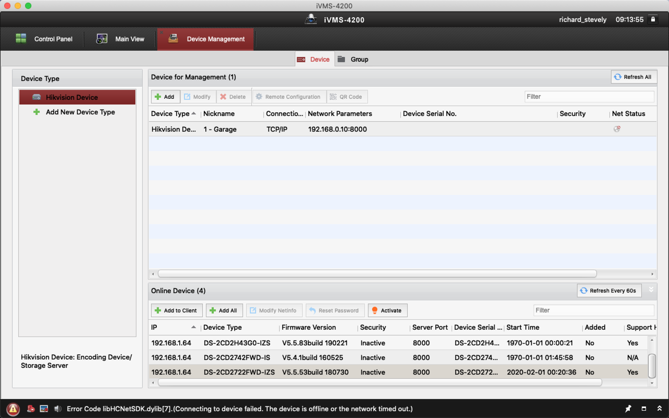

richard stevely
7
Morning macman,
First of all, thank you for taking the time to reply.
Problem 1 and 2
Solved - it was a faulty cable connection. All 4 cameras can now be found on IVMS-4200.
Problem 3, 4, 5 and 6.
I tried "Add to Client" using a new and unique IP but the result is just the same. When doing so I receive the message:
Error code libHCNetSDK.dylib[7]. (Connecting to device failed. The device is offline or the network timed out.)
After trying this is my screen.

Select each camera in the lower Online Devices section and click on the Modify NetInfo button. Therein you can enter a unique IP for each, along with the MAC address [probably 255.255.255.0] and the Gateway [Router] IP which will be something like 192.168.1.1. They should be good to add then.
If that fails, download Hikvision's SADP Tool for Mac and do the network setup there [you may need to quit iVMS-4200 to allow this utility to mine your IP addresses].
And in case you aren't aware, iVMS-4200 for Mac is a half-baked, feature-starved, rogue beta of an app which makes it difficult/impossible to configure camera settings there. Configuring them in your web browser would be an option - except that no Mac browser will give you full config access to all cameras because the web plugin has been banned. A few Hikvision cams have been modified to get around this but most haven't. You may have to find a Windows PC to configure your cameras in iVMS-4200 or via Internet Explorer [not the default Microsoft Edge browser]. Or you can run Windows in emulation: I use the excellent Parallels Desktop which allows me to switch between platforms and software in the blink of an eye. It's more bucks though.
