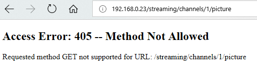

Thanks for this. If I type this into my browser with my Ip address, I get this.
Not sure if I've missed something on setup. I can log in to the cameras log in screen via this IP address, then add my log in credentials.
Do I need to specifically check a box or something to enable the streaming?

I haven’t done anything specific on the camera. Might be some variation in the URL across firmware versions.
